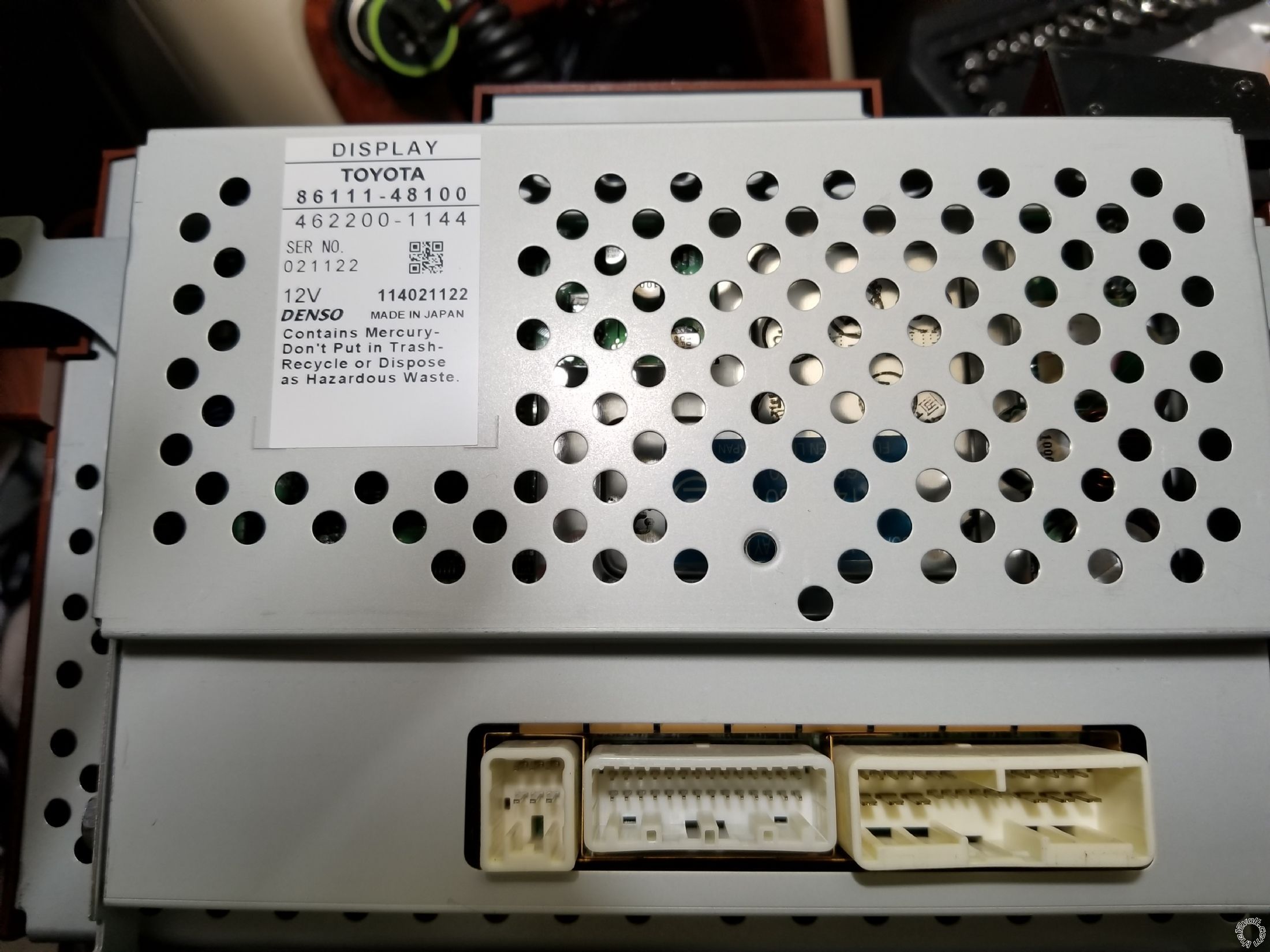

Want to add a backup camera to factory audio at low cost. Looking for wiring diagram for display (86111-48100) and head unit (86120-48480)or low cost wiring harness to add camera. 2007 Toyota Highlander, Adding Backup Camera to OEM Audio - Last Post -- posted image. 2007 Toyota Highlander, Adding Backup Camera to OEM Audio - Last Post -- posted image.

probably isn't a way, Toyota didnt have that option till 2012. Especially with that one having jbl (im guessing).

FYI- That is not correct! Toyota has that option on 2008 Models and up. For 2007 Highlander, it is possible if you can get the pin out diagram, and locate the video input or connector R10. Some guys have done it on toyotanation forum, and showed the wiring, but images were not too clear. I am looking for a the connectors diagram for the same NAV system as well. Toyota does not provide this info :(

Did you ever figure this out? I'd like to know what the connectors are for on the back as well, as I'd like to add bluetooth.

you are a year to early, Toyota started cams in those in 2008. Alldatas first mention a back up camera in a 2008 highlander (including hybrid,6 or 8 speaker) and axxess (ax-toycam2) confirms it. You could always get that piece and see if it works, may have 2008 stuff in your highlander specially if it was made after april/may
