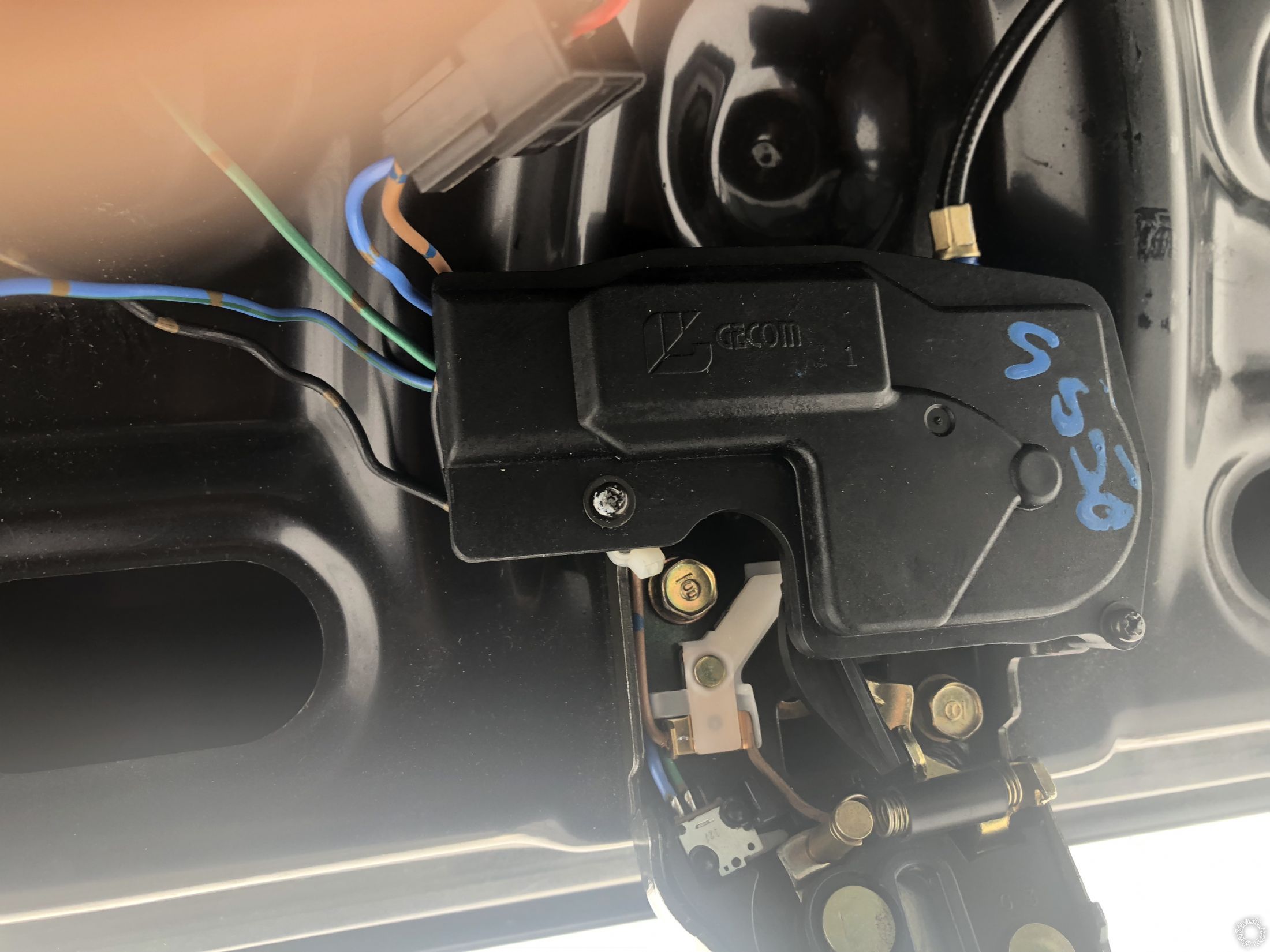

As shown in picture I am trying to install this electrical trunk opener. Remote starter gives -ve pulse to open it but it’s not enough-ve to open(I heard it’s activated motor of lock very little not enough to unlock I checked directly by battery terminals motor is ok)And don’t know what is that switch for. Installing on Honda Civic 2001. Electric Trunk Opener, 2001 Honda Civic -- posted image.

The output of the alarm needs to be connected to the coil of a relay.
https://www.the12volt.com/relays/relaydiagram8.html

Perfect it’s was the exact thing to do
Thanks
