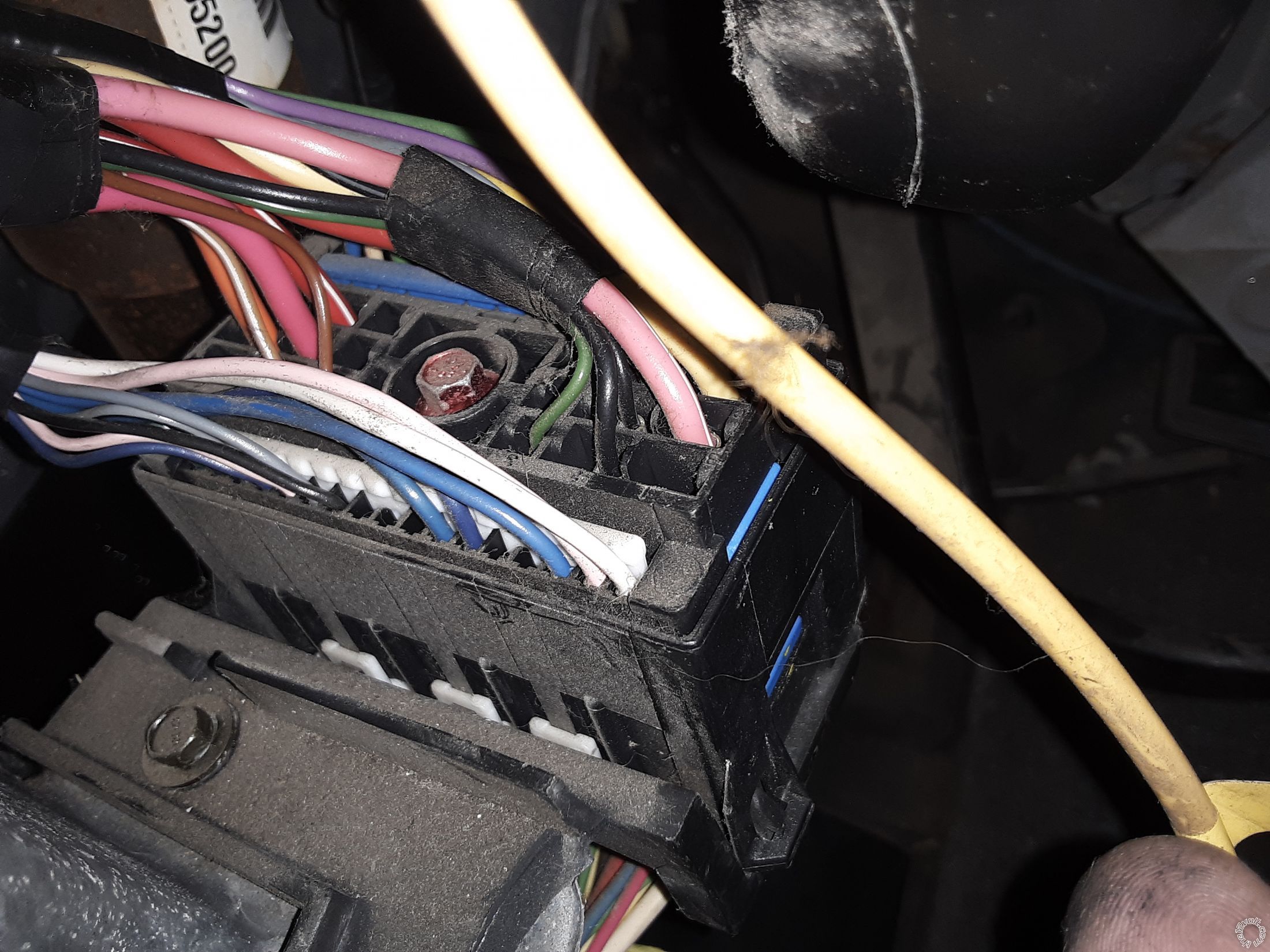

Hi everybody,
I'd like to contribute by making a remote start alarm pictorial for a vehicle that returns different wiring diagrams on the internet. The vehicle a 1996 Chevy Astro van has power locks windows and other extended features. I'm providing start pictures with name references for any assistance that can be provided.

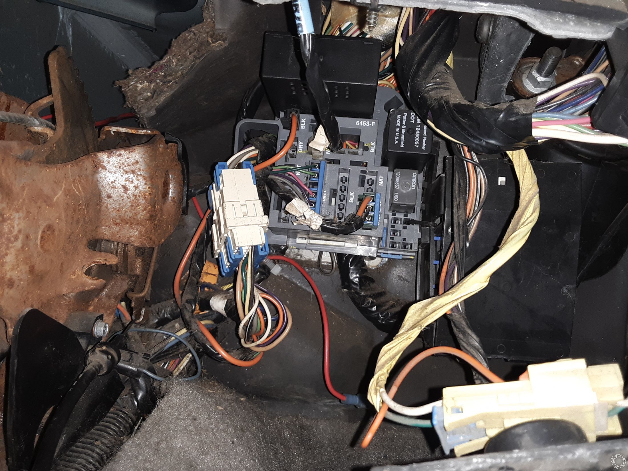

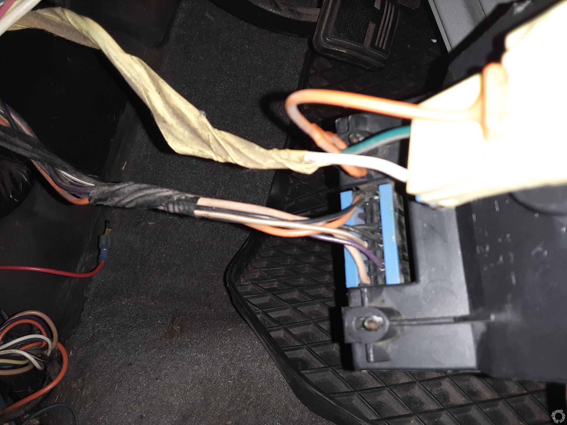

Driver kick panel!?:
1996 Chevrolet Astro Van Alarm/Remote Start Wiring -- posted image.
Center module:

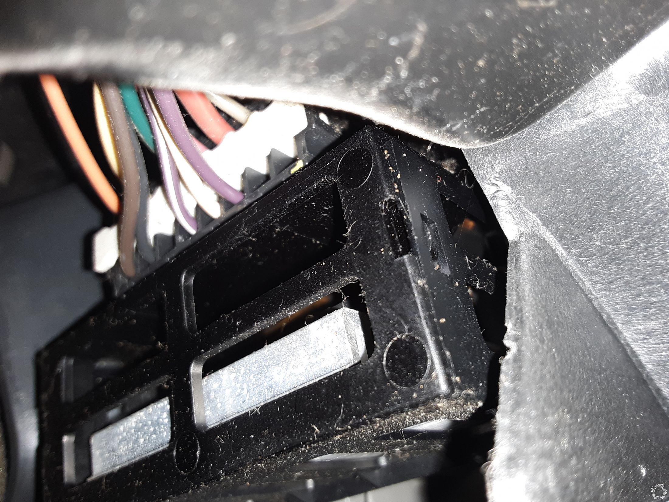

Wiper/brights switch
Headlight switch:

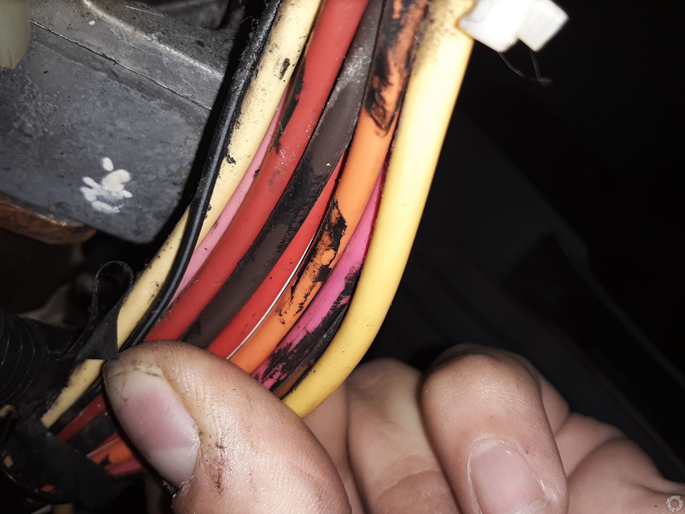

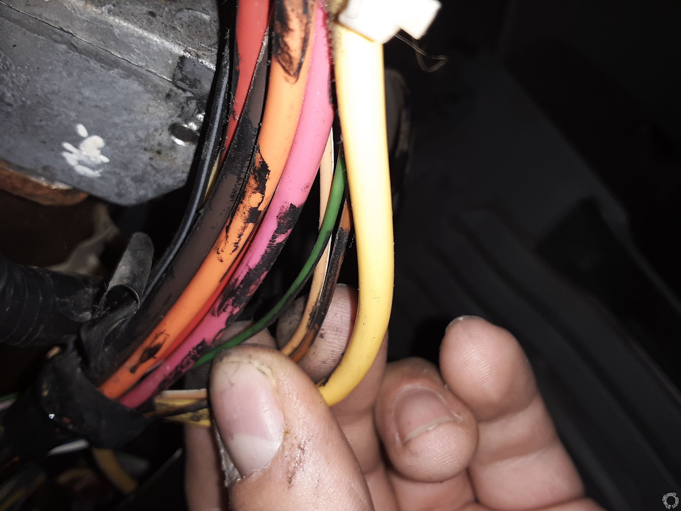

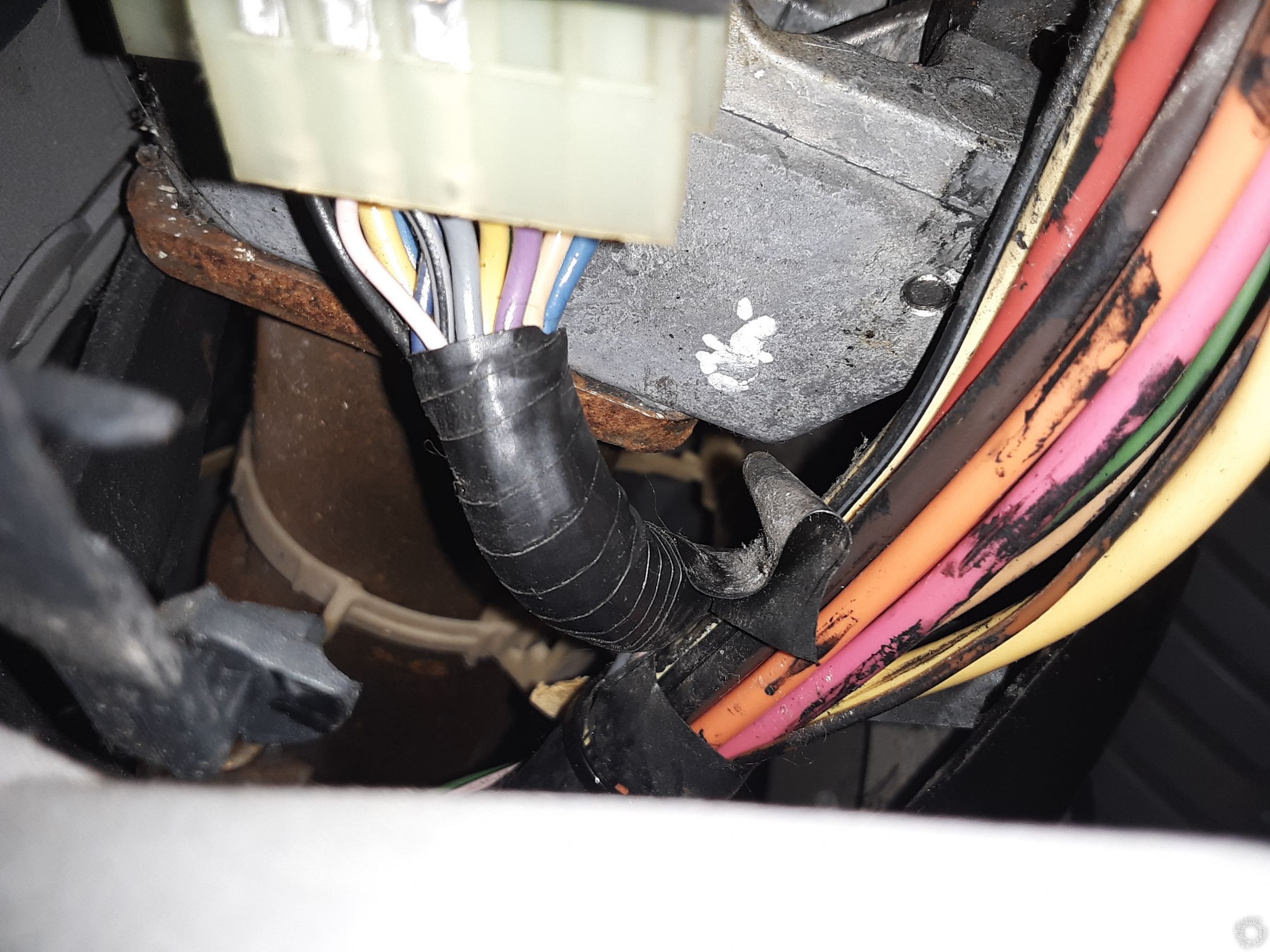

Ignition harness:
OBD:
I'm going to start by soldering:
[RED 12VOLT 30AMP ALARM INPUT] to the [SOLID RED IGNITION HARNESS]
[SOLID BLACK SYSTEM GROUND INPUT] to [VEHICLE CHASSIS]
now I must figure out which reference to use for the door trigger either it is [PURPLE (-) HEADLIGHT SWITCH] and/or [BLACK/ORANGE DRIVER KICK PANEL]
and which+what reference for the horn wire either [Horn Dark Green (-)      Driver's Kick at Relay or at Pedal] or [HORN BLACK (-) @ STEERING COLUMN HARNESS]
Anyone familiar with it?

Posted: March 25, 2019 at 11:50 AM / IP Logged Link to Post Post Reply Quote wirewise
ASTRO 1996-1997
KEY      T-HARNESS      IMMOBILIZER
N/A      N/A      N/A
PART      COLOR      LOCATION      DIAGRAM
12 VOLT CONSTANT      RED (+)      @ IGNITION SWITCH HARNESS
STARTER      YELLOW (+)      @ IGNITION SWITCH HARNESS
STARTER 2      N/A
IGNITION 1      PINK (+)      @ IGNITION SWITCH HARNESS
IGNITION 2      N/A
IGNITION 3      N/A
ACCESSORY/HEATER BLOWER 1      ORANGE (+)      @ IGNITION SWITCH HARNESS
ACCESSORY/HEATER BLOWER 2      N/A
KEYSENSE      N/A
PARKING LIGHTS ( - )      N/A
PARKING LIGHTS ( + )      BROWN (+)      @ HEADLIGHT SWITCH
POWER LOCK      LIGHT BLUE (TYPE A)      IN DRIVERS DOOR HARNESS
POWER UNLOCK      WHITE (TYPE A)      IN DRIVERS DOOR HARNESS
LOCK MOTOR WIRE      N/A
DOOR TRIGGER      PURPLE (-)      @ HEADLIGHT SWITCH
DOMELIGHT SUPERVISION      PURPLE (-), (Requires #775 relay)      @ HEADLIGHT SWITCH
TRUNK RELEASE      GREEN (-)      @ HATCH RELEASE SWITCH
SLIDING POWER DOOR      N/A
TACH      WHITE (AC)      @ ECM, See NOTE #1
WAIT TO START LIGHT      N/A
BRAKE      WHITE (+)      @ SWITCH ABOVE BRAKE PEDAL
FACTORY ALARM DISARM      N/A
ANTI-THEFT      N/A
NOTES
NOTE #1: The ECM (Electronic Control Module) is located on the DRIVERS SIDE of the ENGINE COMPARTMENT, behind the BATTERY. The WHITE TACH wire will be located in a BLACK plug labeled "WHITE".
https://www.the12volt.com/installbay/alarmdetail/454.html
