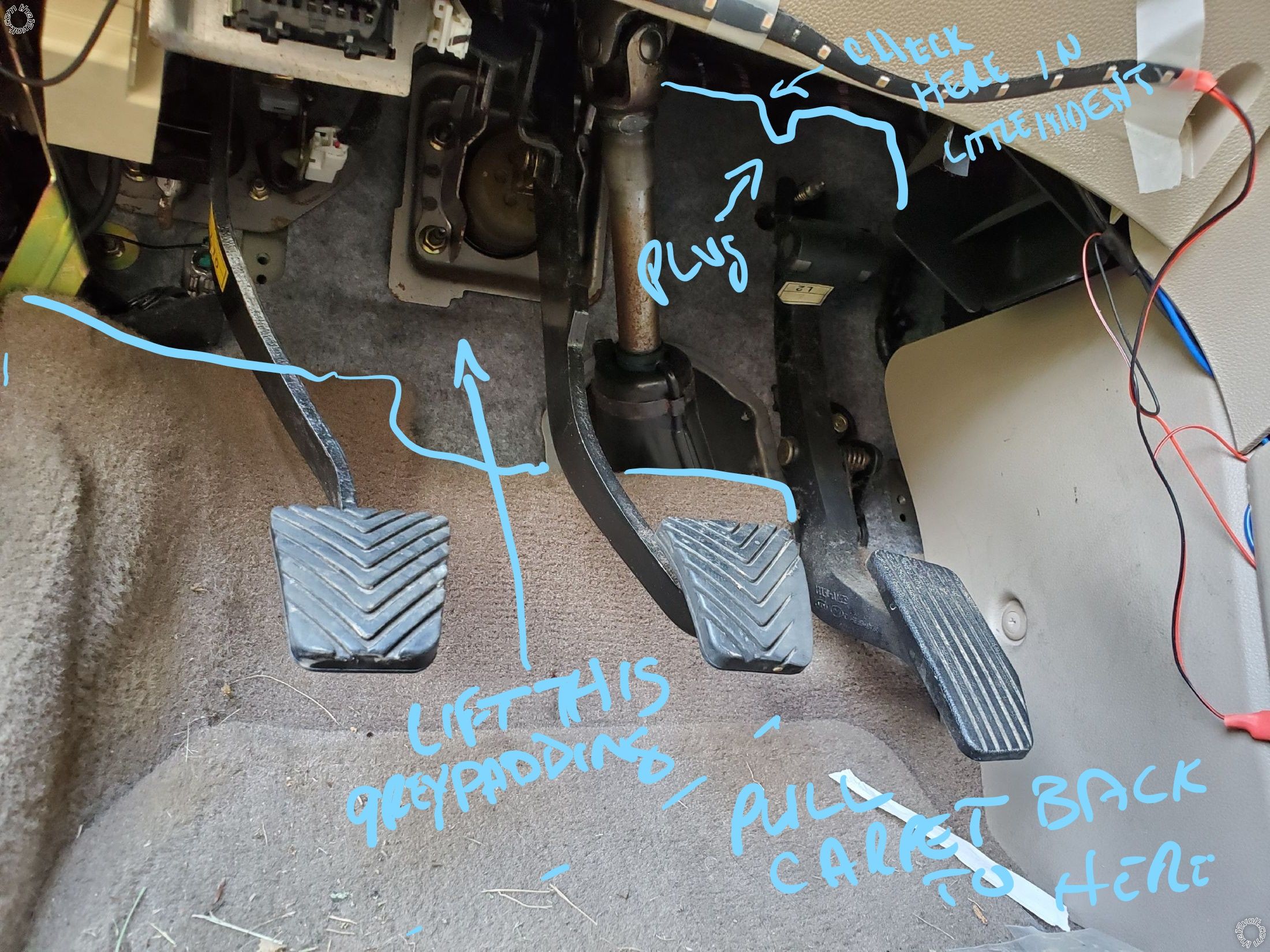

Posted: May 17, 2019 at 1:51 PM / IP Logged Link to Post Post Reply Quote gshookupz
if you can send me a pic of the under side of the firewall I can help you much better. there should be a boot you can go through near the steering column pass through.

Posted: May 17, 2019 at 2:52 PM / IP Logged Link to Post Post Reply Quote evan12358
2005 Kia Sportage, Hole Through Firewall -- posted image.

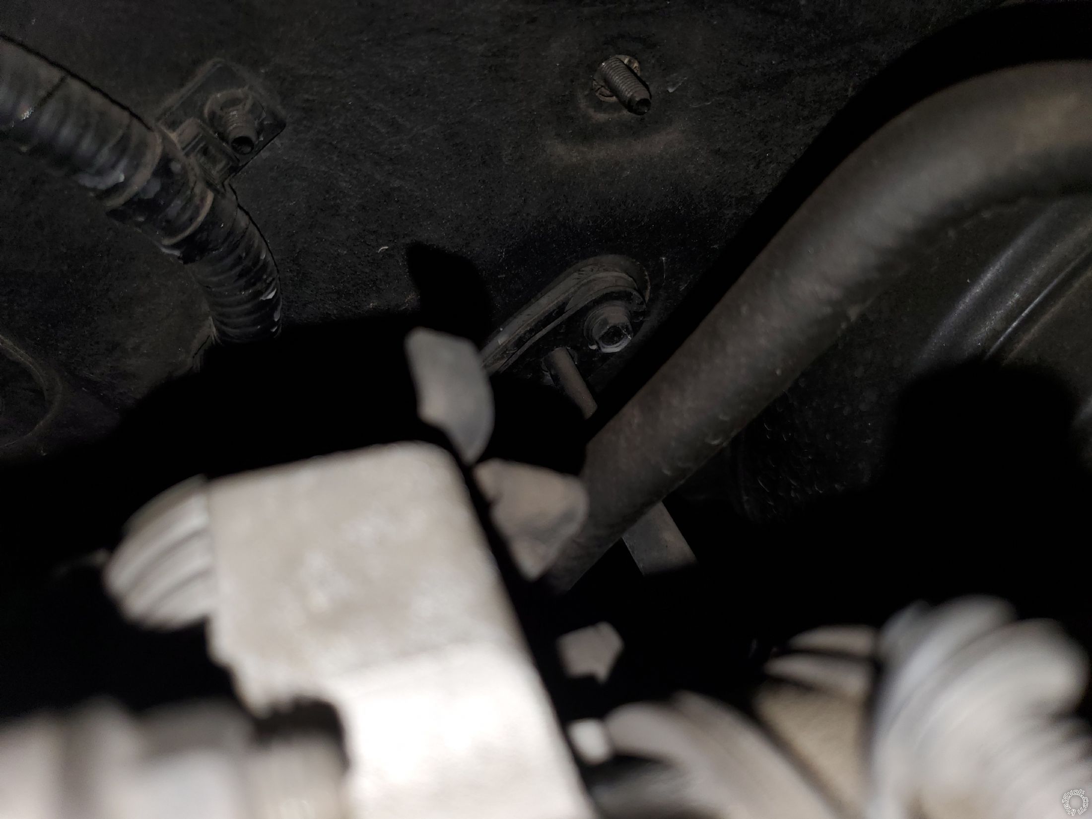

Posted: May 19, 2019 at 4:54 PM / IP Logged Link to Post Post Reply Quote gshookupz
I am thinking there is an area above the throttle cable definitely check from inside motor compartment. Follow the throttle cable 2005 Kia Sportage, Hole Through Firewall -- posted image.

Posted: May 19, 2019 at 6:32 PM / IP Logged Link to Post Post Reply Quote evan12358
As you see, this is the throttle cable through the fire wall

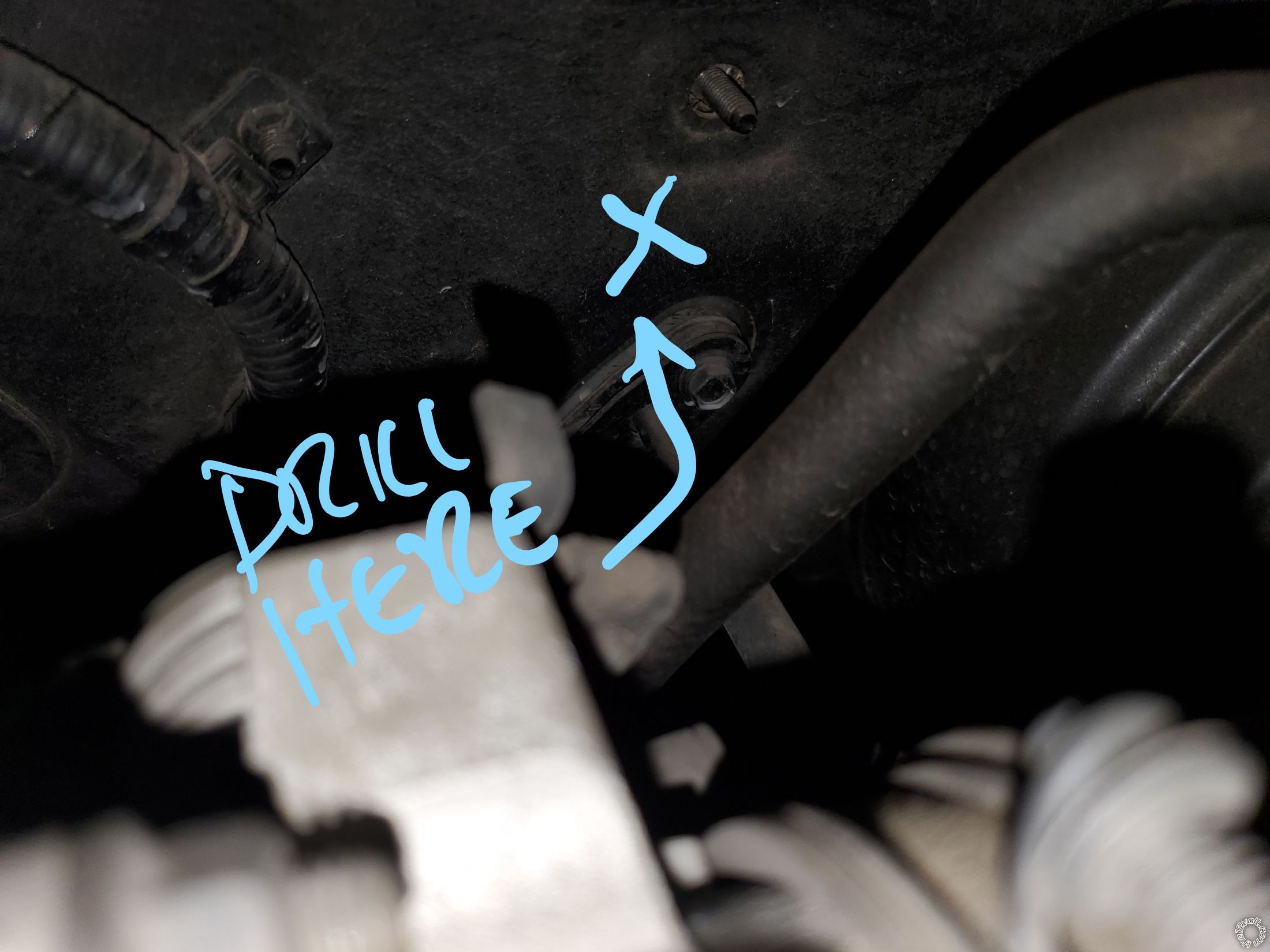

Posted: May 20, 2019 at 12:59 PM / IP Logged Link to Post Post Reply Quote gshookupz
X marks the spot drill your hole right here, single layer metal. 2005 Kia Sportage, Hole Through Firewall -- posted image.
