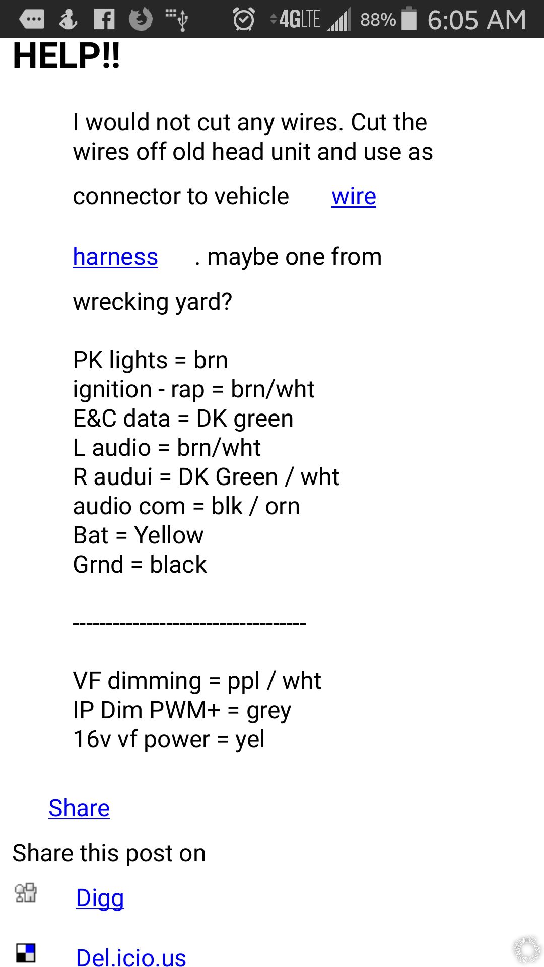

Posted: May 08, 2019 at 6:08 AM / IP Logged Link to Post Post Reply Quote i am an idiot
1992 Cadillac Eldorado with Bose System -- posted image.

Posted: May 08, 2019 at 9:56 AM / IP Logged Link to Post Post Reply Quote benthealien707
Seem that one but some of the wires are different colors than the above listed
