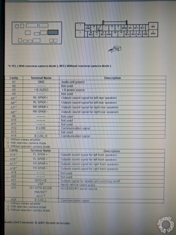

I'm installing an amp and sub in a 2018 Honda CR-V. I can't seem to find the speaker wire colors posted anywhere. Everything seems to stop at 2017 and the 2018 is a different radio.
Anyone have to wire colors for the speakers?

Post a picture of the main plug in the rear of the radio.

2018 Honda CR-V Amp Install -- posted image.
Thank you for the reply. I did find this on the internet and it is correct. I tested the wires before and they were spot on. I finished the install and all went well.
Hope this helps someone else.
