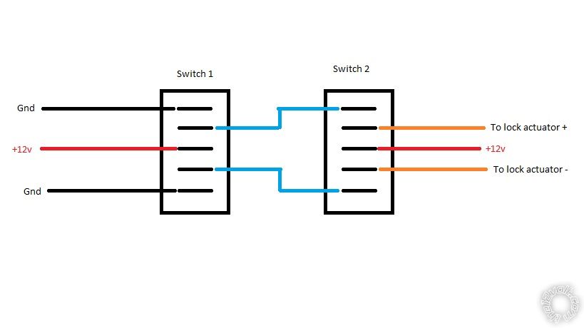

You can forgo the relays and wire both 5-pin switches in this sort of manner Install Lock Switches, 1990 Toyota Pickup -- posted image.
The ground is passed through both switches at rest to the lock actuators. Upon activation of either switch the appropriate ground is interrupted and replaced with +12v power whilst the other ground sent to the actuator remains. This in turn causes the actuator to move in one direction or the other. You will have to correctly wire the switches you have to ensure switch 2 and the actuators are receiving the correct toggling output from the switch upstream.
