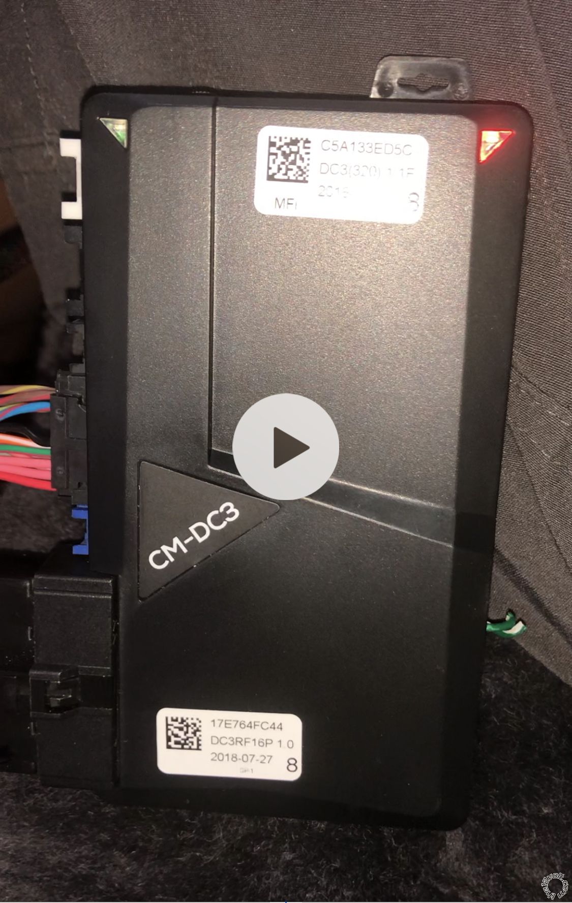

I just installed Firstech START IT DC3(FT-DC3-LC)Remote Starter with T-harness (iDatastart ADS-THR-HA3) on to Honda Odyssey 2013’s. According to my research and read, I should able to program DC3 module after hook up MS2 (T-harness) and MS1(T-Harness) onto M1 & M4 (FT-DC3-LC module) without
the needed to connect sliding door switch, headlamp switch, horn and hood switch. But after hook MS2 onto M1 & MS1 onto M4, one of the red light flashes and won’t stop. I wasn’t able to program the module because the red keep flashes. Can anyone help. I really appreciated.2013 Honda Odyssey Compustar Remote Start/ T-Harness -- posted image.

Have you flashed in the RSA-HA3 firmware?

you have to program what kinda car it going into, the remote start has no way of knowing what kinda car it is installed into. You need a idatalink.com log in which is free but you also have to have a flash logic programmer and install the software for it on your computer/laptop. https://www.flashlogic.com/accessories/category/product_id/396

well, I bought the cable online and tried to flash logic program and install the software but the website keep telling me that "WEBLINK UPDATER PLUGIN REQUIRE". I follow the link and instructions to download NET Framework but I keep getting same error.

make sure your using IE and not chrome or even mircosoft edge to flash it

Thank so much for your help mgoetz74. At first I did use the wrong Brower and it did get a different error. Now, I using Internet explorer and still kept getting same error. Is anybody able to flash my module for me? I am willing to pay for it. Thanks in advance.
