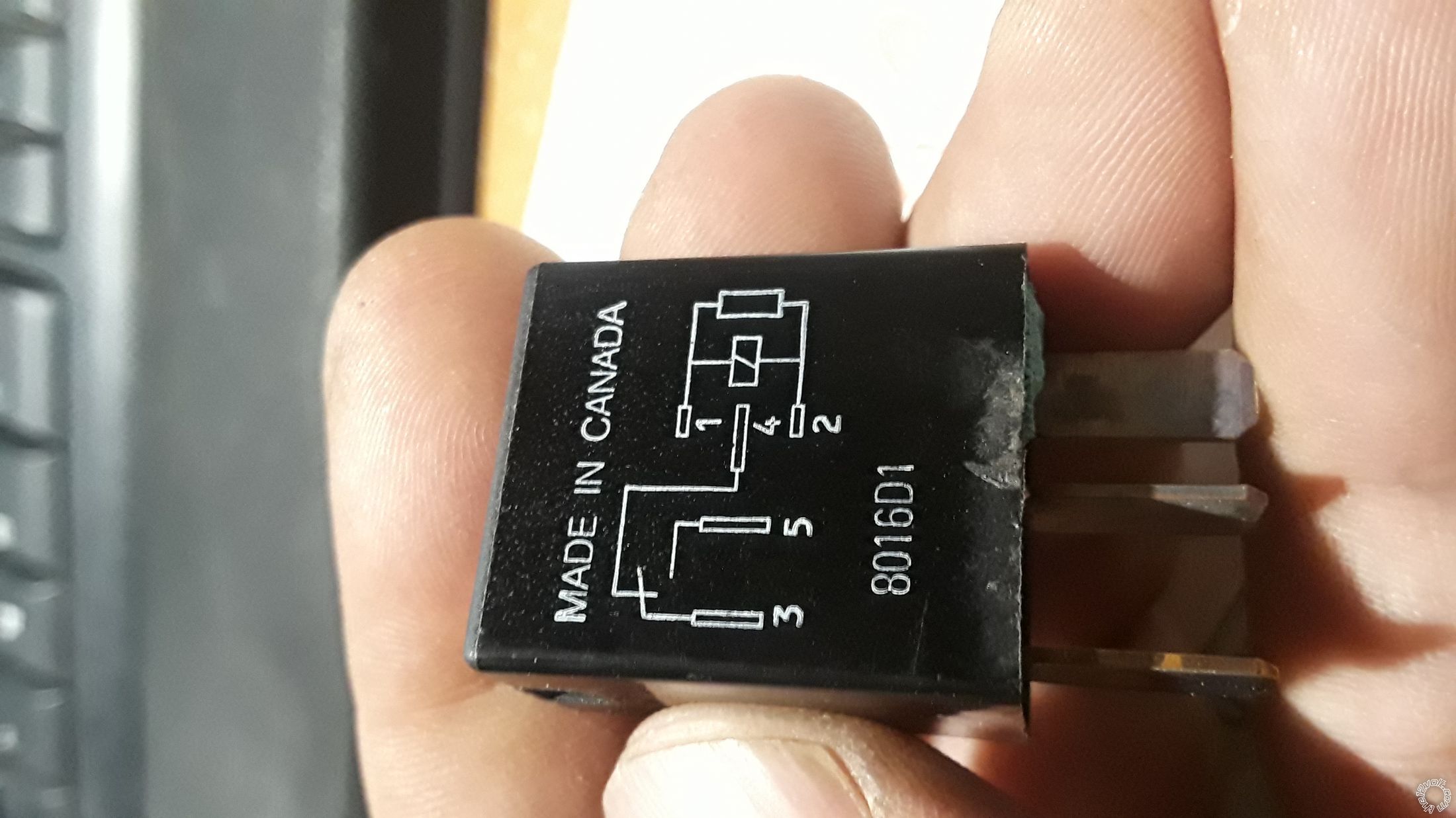

I have a couple of bad relays in my 2008 dodge caliber(son's first car)
the relay block is all corroded up and not useable.
I have some other relays and connectors which I believe will work I just am not positive the pin conversion
Old relay is the G8HE-1C7T-R1-DC12
Replace G8HE-1C7T-R1-DC1 Relay with RTT7101-12V -- posted image.

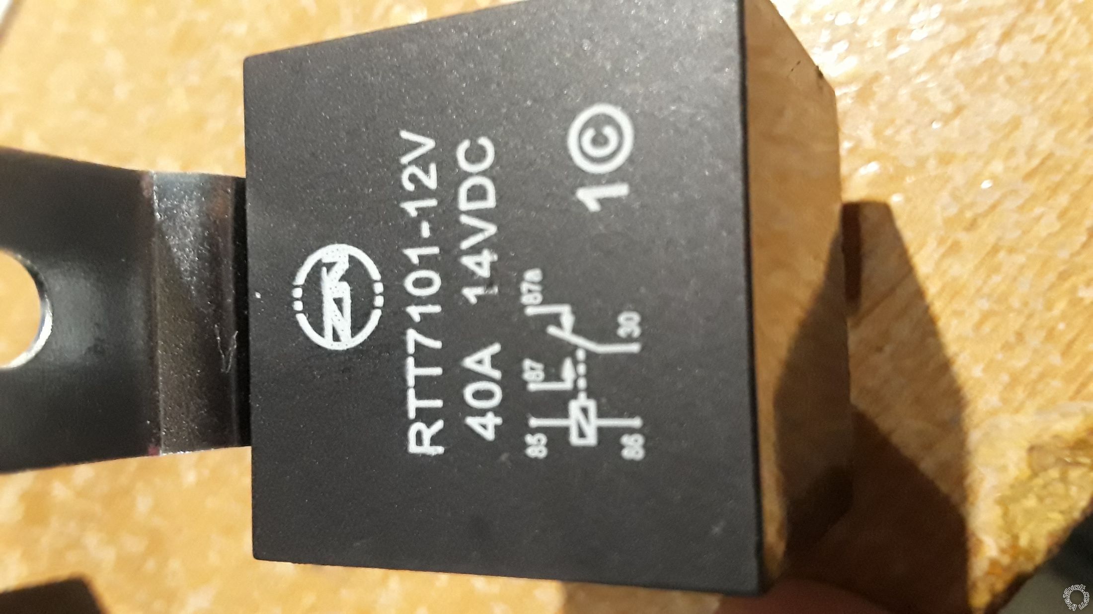

The relay I have and want to use is this
can anybody help me connect pins 1-5 to 30, 85, 86, 87 and 87a
If it matters, my scenario there is nothing wired to pin 4 of the current corroded relay.
Thank you in advance for any guidance you can provide.

1,2=85,86
4=30
5=87
3=87a

I got told in another forum the following
86 and 85 are the coil 1 and 2
3 is the same as 30
4 is 87a
5 is 87
Can you take another look and let me know which you feel is correct. I am doing the same with your answer to them.
thank you,
Steve
eguru
Copper - Posts: 340
Joined: February 04, 2018
Location: Quebec, Canada
Posted: August 05, 2019 at 7:49 AM / IP Logged Link to Post Post Reply Quote eguru
The other forum is correct. My apologies.
