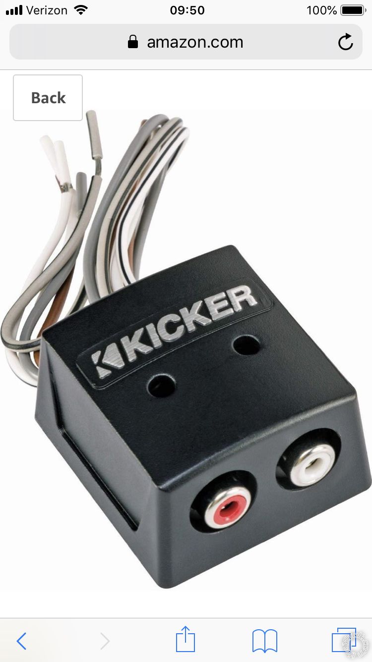

Short story trying to add a subwoofer to stock radio,
Long story trying to add a speaker cable to rca adapter with line out converter.
But the issue is the rats nest of wires behind the head unit

Posted: August 17, 2019 at 9:54 AM / IP Logged Link to Post Post Reply Quote tippy 52
2016 Honda Accord Stereo Wiring Diagram -- posted image.
