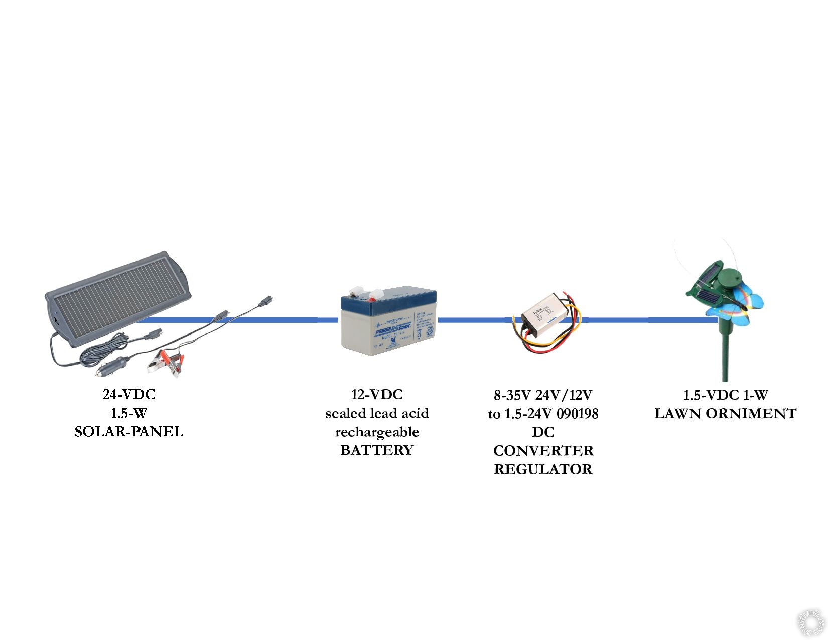

With all the helpful input... Here is what I came up with. Thoughts? 12VDC Solar to 1.2VDC Regulator? -- posted image.

How is your 24VDC solar panel going to charge your 12V battery?
Overall, I think this is overkill for for a lawn ornament.

A 1.5W solar panel isn't going to charge a battery and run your 1W load. Since you don't show anything in your diagram that is going to turn off the load during the night, you would need to be charging the battery with at least a 5W solar panel in order for your load to operate 24/7. The conversion efficiency of the dc-dc converter also needs to be taken into account along with the self-discharge of the lead-acid battery.
