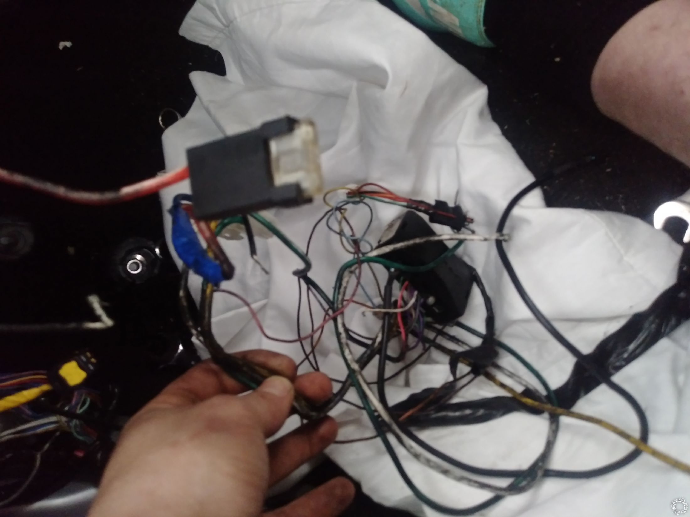

I have a 2012 Mitsubishi Lancer ES with CM 600- s remote control start box. Long story short it got ripped out of my car halfway. I want to fully take it out but I do not know how the wires connect back to the car. Does anybody know what I can do here.

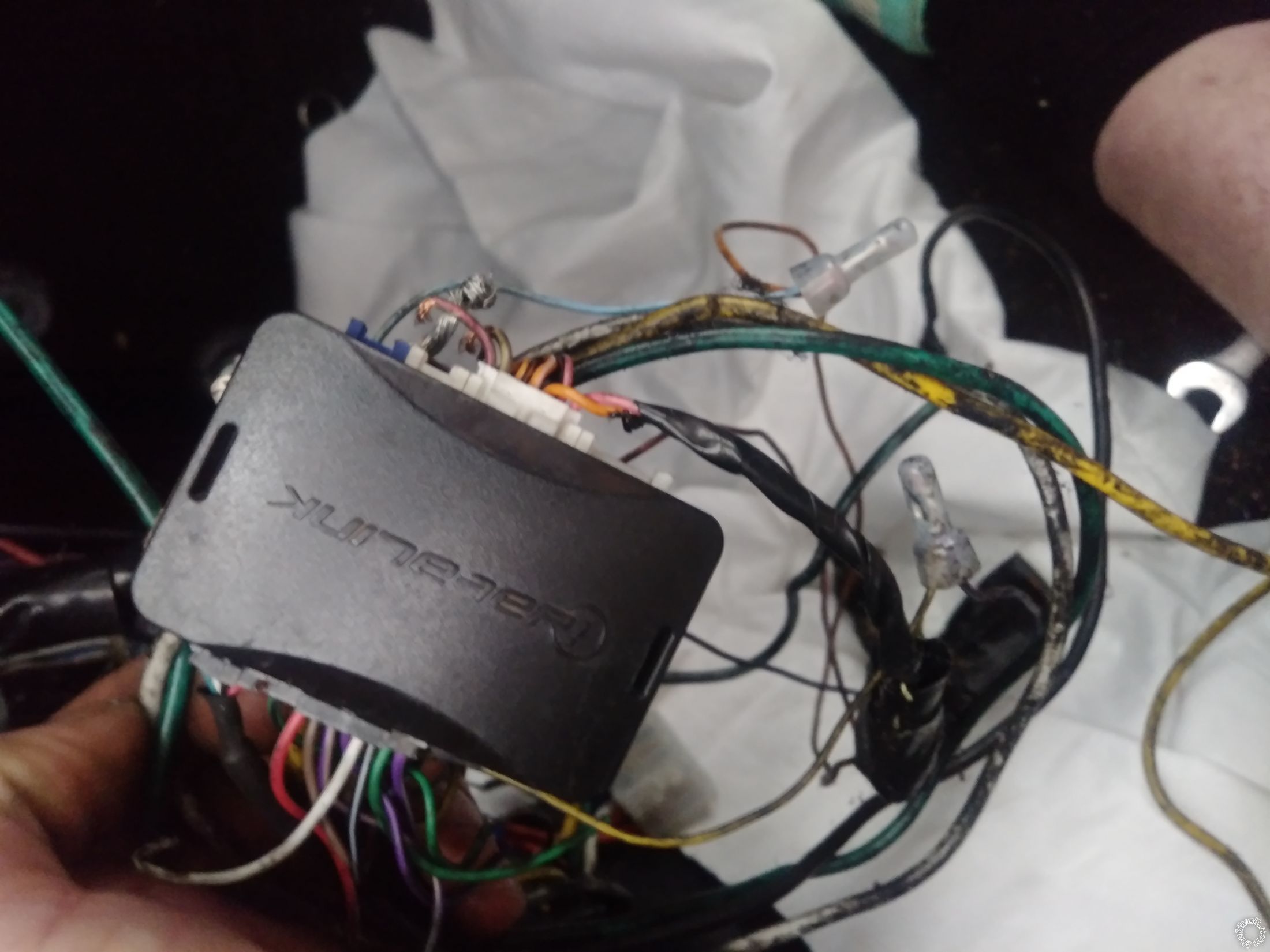

Posted: October 09, 2019 at 1:38 PM / IP Logged Link to Post Post Reply Quote jdubb2260
Hers pictures of what im working with.

wow that is just a a wiring nightmare. This should help, just match your car to the page...
http://images.idatalink.com/corporate/Content/Manuals/DL-MI2/ADS-AL(DL)-MI2-EN_20190726.pdf

I found that already but thank you. What im trying to do is remove the remote start and keep the immobolizer bypass and somehow bypass the immobolizer with it. Im doing this cuz i inherited the car from my grandmom that passed and she either lost they key or hid it real good cuz i cannot find it. Any suggestions on hpw to do this?

Posted: October 11, 2019 at 11:24 AM / IP Logged Link to Post Post Reply Quote mgoetz74
its possible. There is a wire that activates the bypass module (which i don't see in the picture). Problem is that is such a mess that i wouldn't even know where to begin/ have time to tpye out on how to hook it up and wire it. May just be easier to to have a new key programmed to it. Even if you brought that to me for install i sell you a new bypass and gut that...mess Remote Control Start Uninstall -- posted image.
