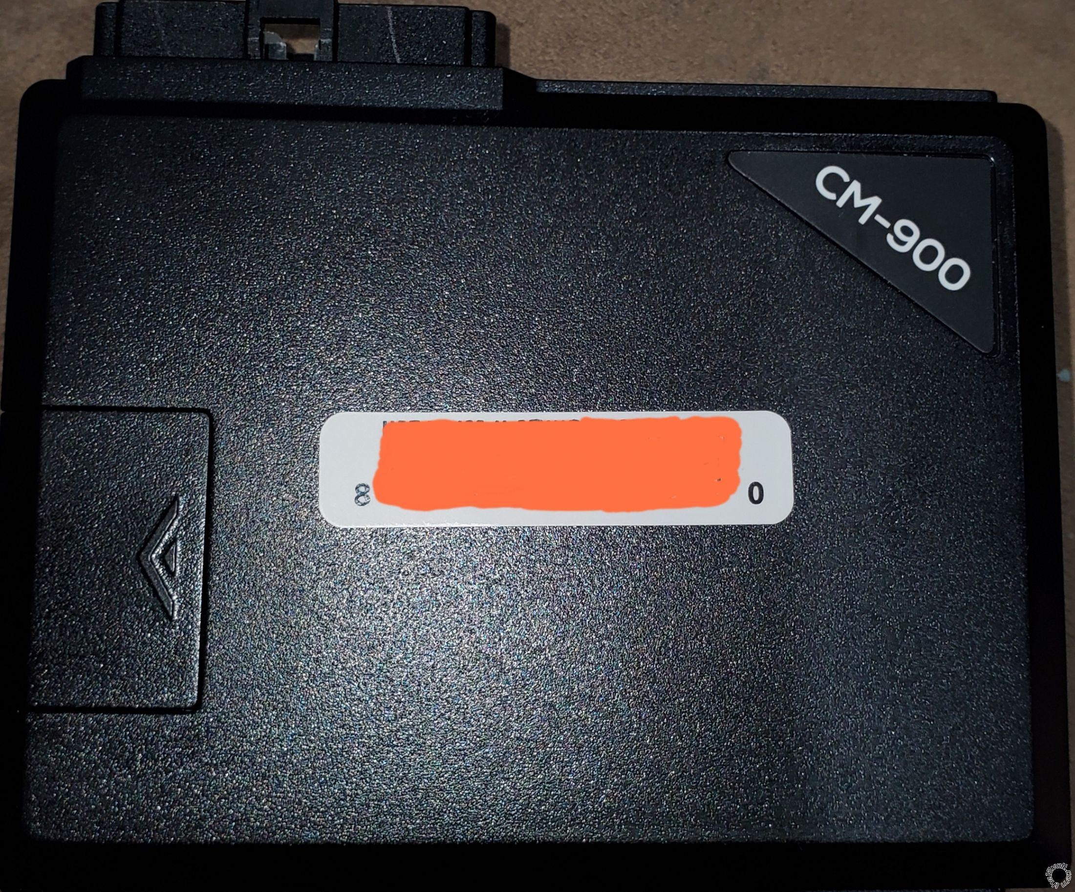

Here is a link to the CM900 install guide. Your CS4900-s has the CM900 brain.
It should be marked as such on the units label.

Yes I just checked the tag on the back of the unit and it's the CM-900 so that sounds good.

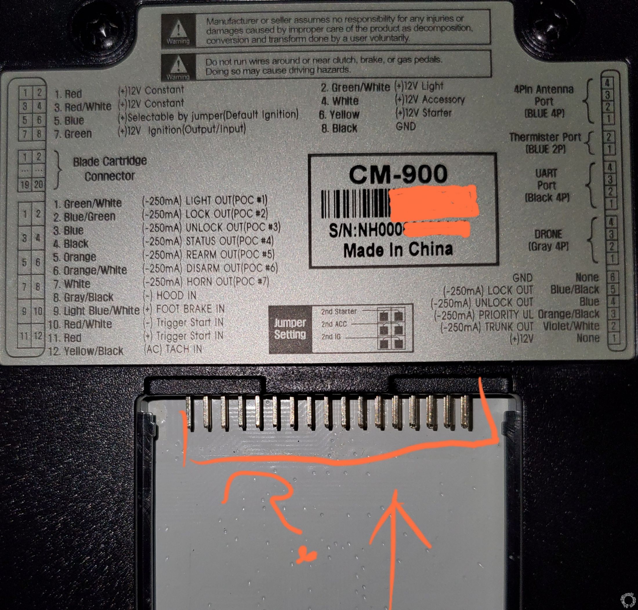

Included some pics of my RS unit. I hope the bypass with this will save me some wiring because that would just be well, great.

Easy one first. The open area at the back of the CM900 with the connector pins is for a iDatalink Blade cartridge.   It slides into the unit. It is a bypass module like the EVO-ALL that is designed to work with certain R/S units. You can learn more at the iDatalink.com WEB site.
