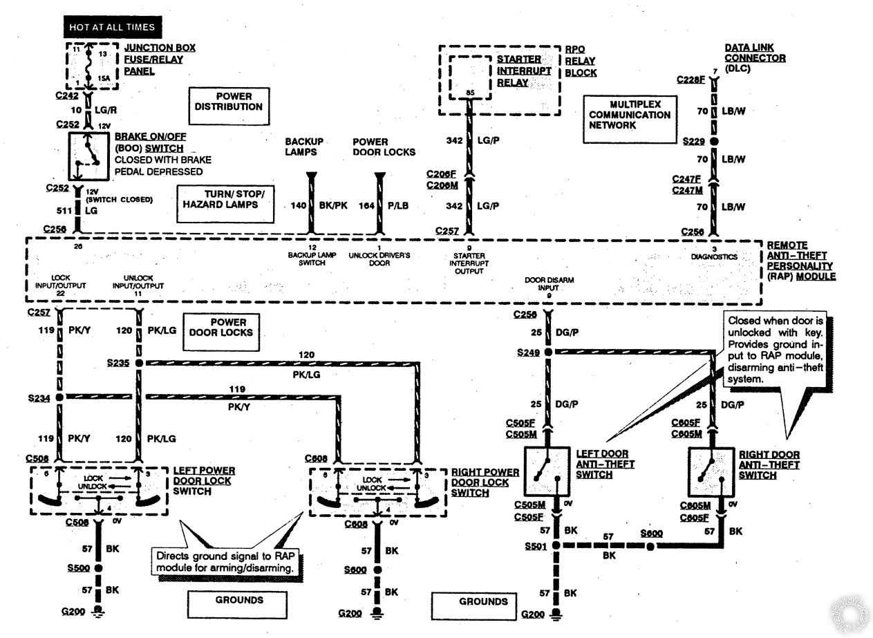

Try unlocking your door with the key to disarm the factory alarm, then see if it starts.
1998 Ford F-150, Viper 160XV vs Factory Alarm -- posted image.
