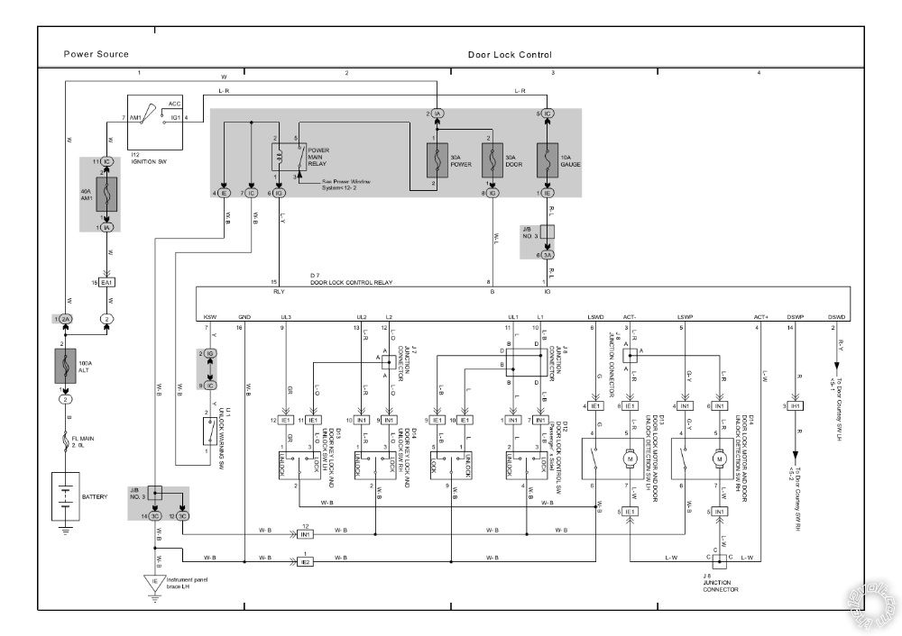

Have you tested the door lock actuators themselves? Assuming they test good, you could always rewire using relays. Here's the diagram according to Autozone:

Posted: November 16, 2019 at 5:53 PM / IP Logged Link to Post Post Reply Quote geepherder
Pins 3 and 4 (light blue/red and light blue/white) should be the door lock actuators. You can momentarily touch power to one and ground to the other and see if the doors lock or unlock, then reverse them.
I believe that's pin 8 (a little blurry), the white/light blue wire should have constant power.
Pin 16 (again, I think?), the white/black wire should be ground.

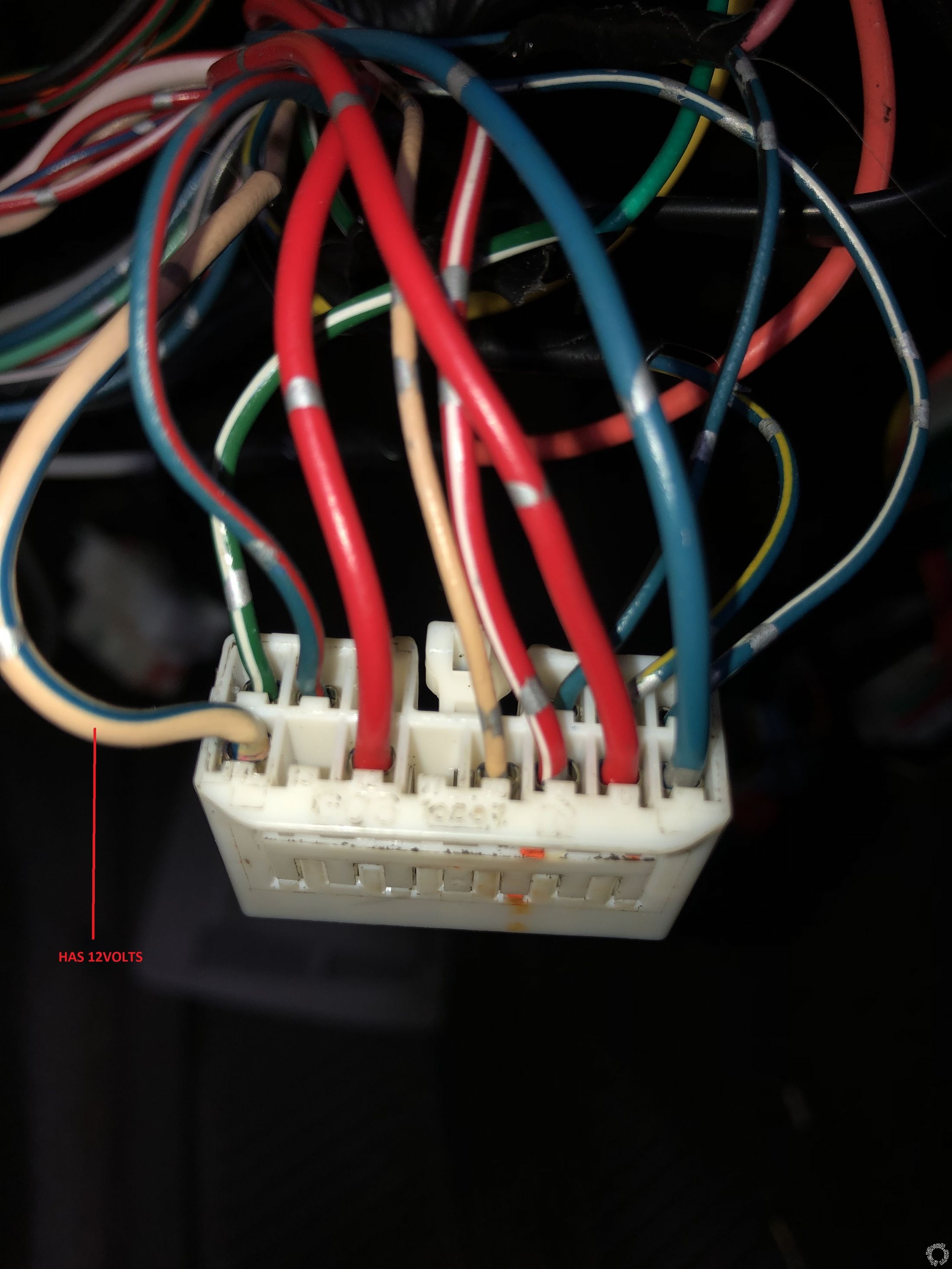

Posted: November 16, 2019 at 8:59 PM / IP Logged Link to Post Post Reply Quote slicksam
Is the light blue/red and light blue/white on the same plug as the white blue(constant) I found the white/blue and it does have a constant 12v

Posted: November 17, 2019 at 4:33 AM / IP Logged Link to Post Post Reply Quote geepherder
I guess not. There doesn't appear to be a wire at pin 4 of either harness. I suggest pulling one of the door panels and checking the wire colors at the actuators. Then you can verify with a continuity test back to the other harnesses.
