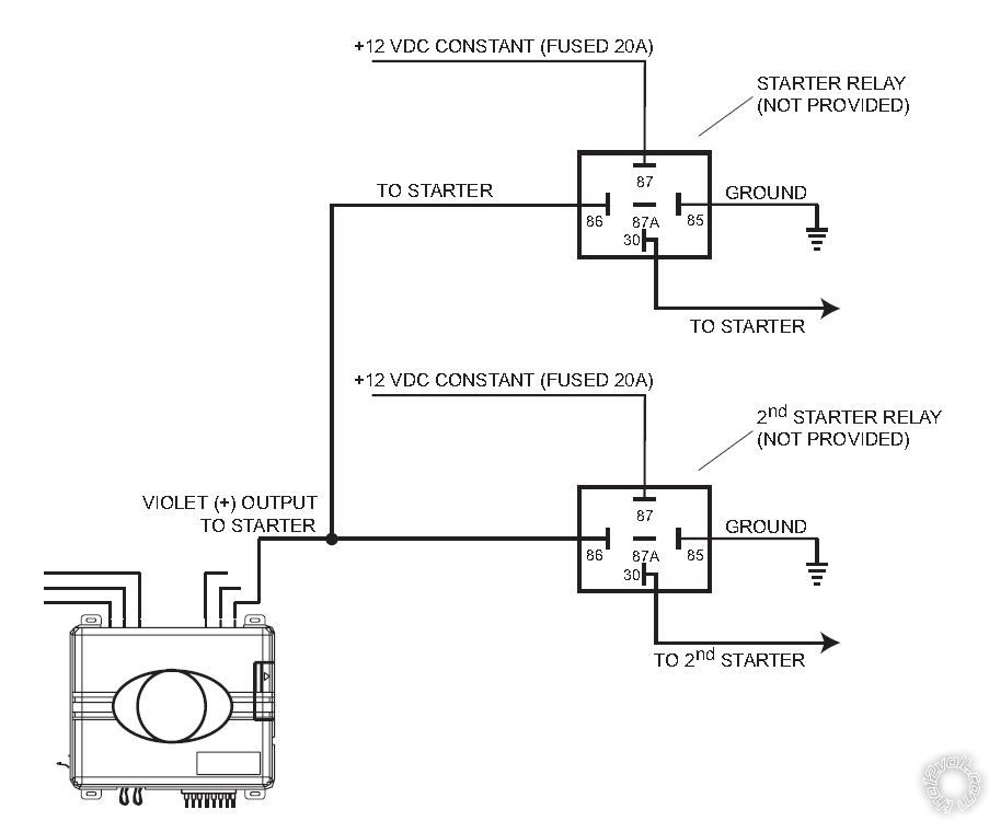

      i have a hornet 570t remote start that i want to install on my 05 Toyota Camry LE 4 cyl. i used to install these and viper units ages ago but i can not recall exactly how. i remember some of the units needed a relay for something but this remote starter did not come with one. any help is greatly appreciated.

Here is a link to a wiring guide for your car :
http://www.bulldogsecurity.com/bdnew/vehiclewiringdiagrams.aspx
Doing the install properly, you will need additional relays to support the second
Starter wire that this car has.
I uploaded a copy of the 570T install guide.   Here is a link :
https://www.the12volt.com/installbay/file.asp?ID=1447
The install looks pretty straight forward with the exception of the 2nd Starter wire.
For proper isolation you will need two 30/40 Amp SPDT relays with harnesses and a
couple inline fuse holders with appropriate fuses. Here is a diagram of those relays :
