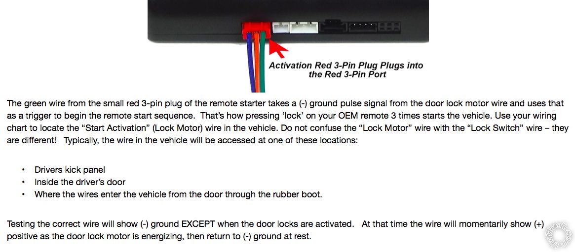

Here is a snapshot from the PDF I'm trying to follow:
2015 Hyundai Accent Remote Start Wiring, Before Xmas -- posted image.
my problem is I CANNOT find this wire. In the location that the diagram that I found here at the 12Volt, it says it should be in the drivers side kick panel and brown wire. I have a couple of
brown wires there, however none of them show no voltage at rest (-) and 12 volts (+) while triggering the lock button which is what my installation guide is telling me that I need.

https://www.the12volt.com/installbay/forum_posts.asp?tid=138153
Check for a gray wire at pin 22 of the white 42 pin plug (F) at the dash fuse box.
