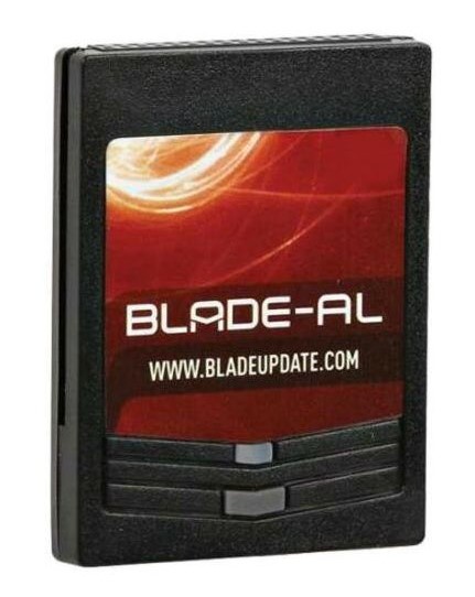

The Omega Excalibur R/S system requires the use of an Omega Blade AL cartridge. Even though it is made by iDatalink, the Blade AL is OEM'd to Omega and has an identifier as such. When you try to flash the iDatalink Blade AL in an Excalibur R/S unit, the WEB Flash site sees this mis-match and prevents the flash. Part of the reason behind this is that iDatalink licenses their firmware and companies like Omega and Audiovox pay a fee for each version of firmware they want to supply their users.
Here is what you need :
Excalibur AL-180-EDPB -- posted image.
Additionally, beware that there are 64K and earlier 32k Blade AL cartridges out there and some versions of firmware require the extra space to provide full functionality. For your 2015 RX350 application, you need the 64K Blade AL.

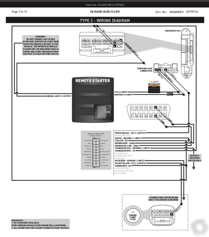

Okay, so I finally have gotten around to installing my alarm and have run into an issue that I am at a loss to explain. Basically, I am able to do everything except start the car remotely. The Excalibur remote allows me to arm/disarm the car, and open the liftgate so I am pretty positive the programming took correctly. But when I press the start button twice, the remote beeps at mee and displays the shutdown icon - starter never cranks. Here are my particulars:
1) When pressing the remote start button, I hear the relay inside the remote starter clicking several times but no engine cranking
2) I did not connect the parking light output from the remote starter to the ECU yet thinking I would do this after I tested everything. Does this have a negative impact and will prevent starting?
3) I assume the remote starter is getting its ground thru the 20 pin Blade Connector and therefore do not have to worry about the ground on the 18 pin harness (used when Blade not in use).
4) I am not using the option for idle mode so I did not connect pin 7 PTS to pin 13 on the 20 pin Blade wiring harness. When I had it connected, the dash would light up weirdly. I do have pin 3 (Blue/Red) connected to ground at the moment - any issues with that?
5) I've attached the diagram I am using for my setup 2015 Lexus RX350 with PTS.
Appreciate any thoughts on this issue ...hoping to be a hero to my wife who has been asking me for this for a while:-).
Excalibur AL-180-EDPB -- posted image.Excalibur AL-180-EDPB -- posted image.

Posted: March 06, 2020 at 2:47 PM / IP Logged Link to Post Post Reply Quote kreg357
The Parking Light connection should be made but has no inpact on your current issues.
If you don't want idle mode, neither the Blue/Red ground connection nor the Blue/Yellow PTS connection from the Blade AL 20 plug should be made.
More than likely, your RX350 has the Factory Alarm system and a hood pin, so the Orange/Black wire is not used or connected.
While the Blade AL cartridge needs a ground connection, it does not share this with the host Excalibur AL-180-EDPB system in
any meaningful way. As mentioned above in a previous reply, the iDatalink Blade-AL Type 2 diagram is a bit generic and does
not show several necessary R/S connections. It only shows the necessary connections for the features it supports. You must
make the Excalibur AL-180-EDPB Chassis ground connection. That is probably where the main issue lies. While the Blade-AL
does supply a Tach signal to the Excalibur AL-180-EDPB, you might have to program the Excalibur AL-180-EDPB to Tach Mode and
do a Tach Learn. Being as the RX350 is a PTS vehicle you could run in Hybrid Mode or Fixed/Assume Running Mode if programming
allows.
