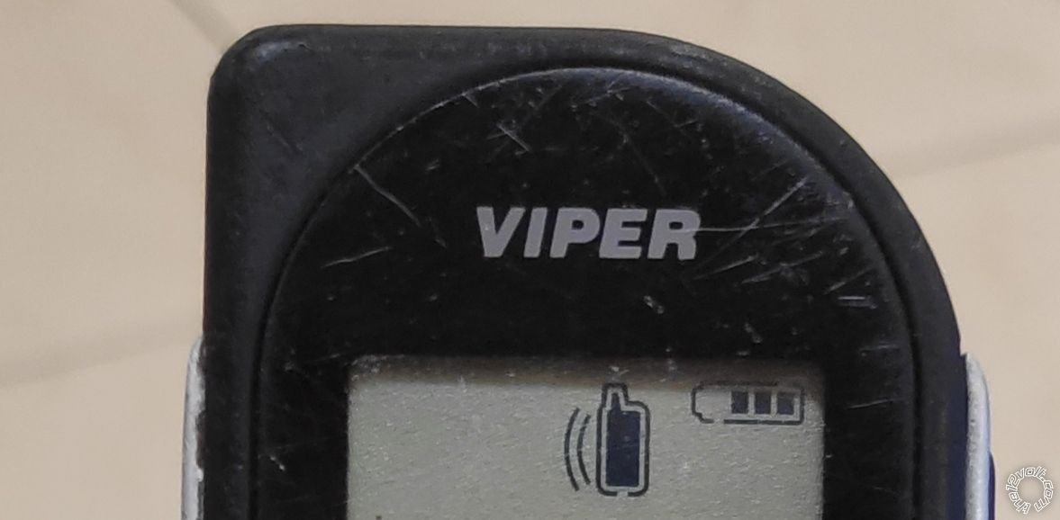

On the display of the remote, very top, dead center, there is a picture of a remote. Just to the left of it there is this symbol (( and to the right of it there is the same but wavy. Are the symbols to the left of it visible? If not, go through the menu from the remote and turn them on. The symbol to the left indicate audible confirmations, and the wavy ones to the right indicate vibration confirmation.

In the center, top of the remote's screen there are the two "((" symbols just to the left of the black remote icon and nothing to the immediate right side of the black remote icon accept all the way to the right edge there is the battery level icon . Viper 5706 2-Way Remote Will Not Sound When Alarm Sound - Page 2 -- posted image.

The only thing I can figure is a defective speaker / beeper in the remote. If you are familiar with the menu settings within the remote, look through it and see if you can turn on the vibration feature. If it will vibrate but will not make sounds, it is the speaker / beeper in the remote.
