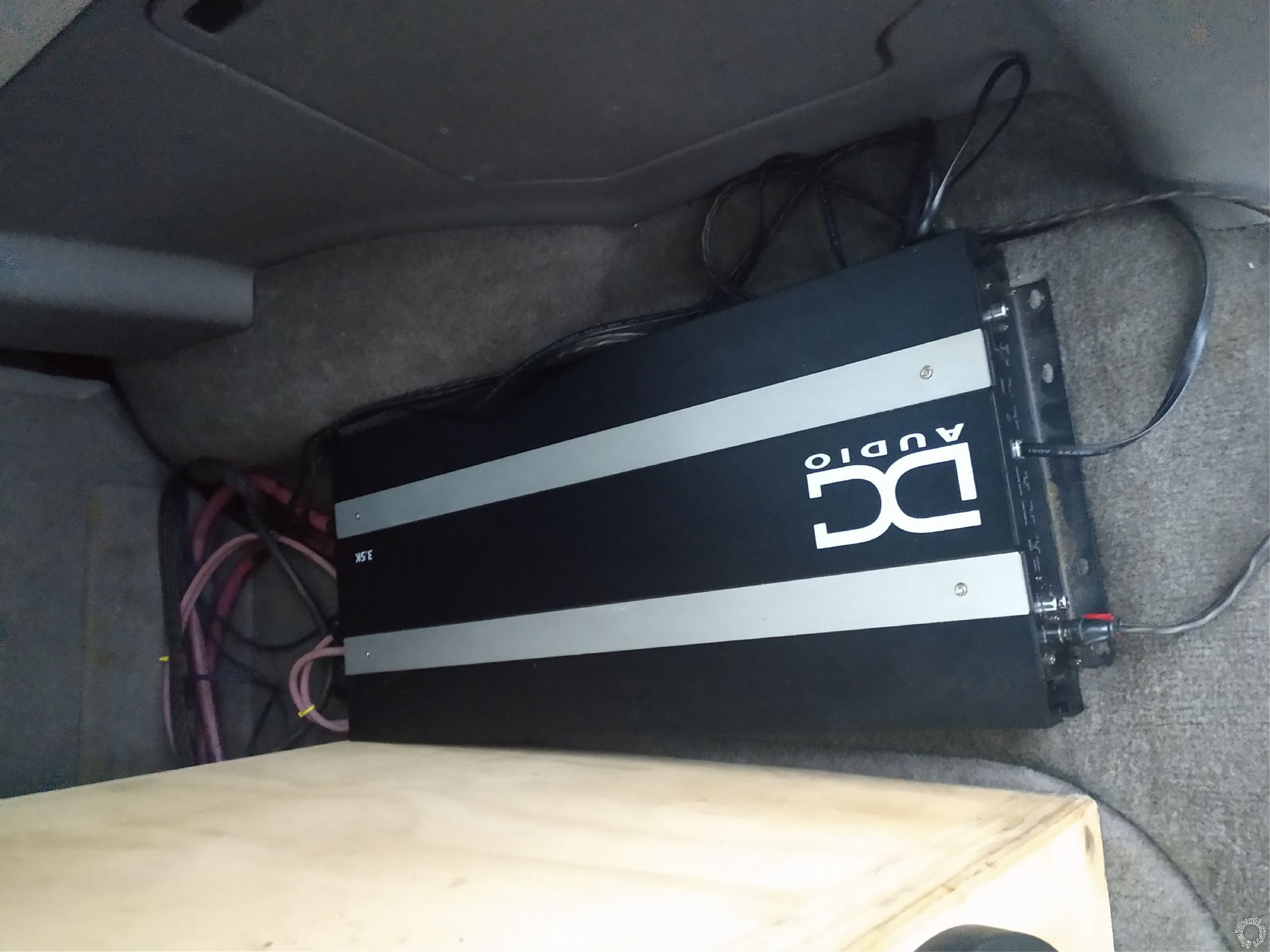

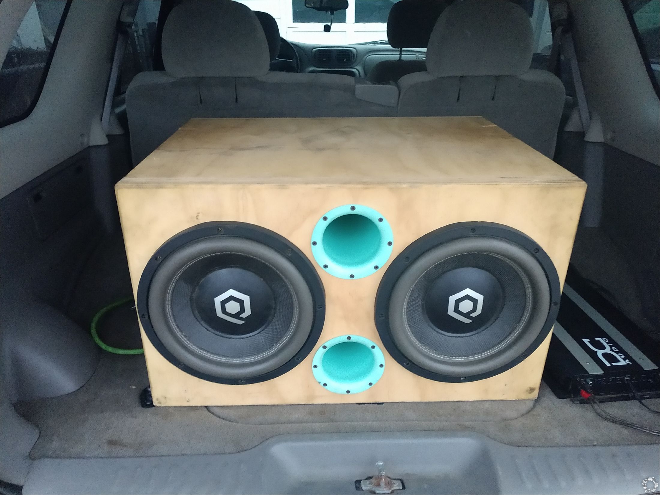

So my car and set up 05 trailblazer 0g wire hooked up to dc 3.5keverything is ran normal I'm only running a little power to my subs bc lack of h/o alt new car so I'm still working on it Possible Bad Ground? -- posted image. Possible Bad Ground? -- posted image. Possible Bad Ground? -- posted image.
