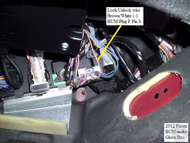

I was wondering if anyone knew the colours of the trigger wires for lock and unlock on a 2016 fiesta 1.25. Even though the car is 2016 it’s not got remote locking, I have no idea why as it’s so new!. The car has central locking on the drivers door which then unlocks all doors and boot. There is also a button on the dash to lock doors and turn on hazards.
Does anyone know if I can wire in this relay kit into the dash to operate it remotely or does it need to go in the passenger footwell near the GEM unit? And as said earlier the colour of the trigger wires.

Posted: January 13, 2020 at 3:09 PM / IP Logged Link to Post Post Reply Quote wirewise
FIESTA      2011-2016
POWER LOCK      BROWN/WHITE (-)      @ DOOR LOCK SWITCH or BCM, WHITE 24-PIN PLUG(F), PIN 8
POWER UNLOCK      SAME AS LOCK WIRE
The BCM (BODY CONTROL MODULE) is located behind the GLOVE BOX.
THIS DOOR LOCK SYSTEM RESPONDS TO A NEGATIVE PULSE(-) TO A SINGLE WIRE. LOCK AND UNLOCK WILL FLIP-FLOP BACK AND FORTH, ONE PULSE WILL LOCK THE NEXT PULSE WILL UNLOCK. There is a one wire door lock, which is brown/white (-) at the door lock switch or BCM (body control module) behind glove box, white 24 pin plug (F), pin 8. Negative pulses on this wire will alternate between lock and unlock. Connect as a type “B” system with both the lock and unlock wires tapped into the brown/white wire, no resistors are needed. If your unit has only a lock and unlock wire and requires adding 2 relays for type "C" lock systems, you must add a 1 amp rectifier diode to the end of both the lock and unlock wires, the banded end of the diodes connect to the wires from the from the module, the unbanded end of both diodes tap into the brown/white wire in the vehicle.

Posted: January 13, 2020 at 3:27 PM / IP Logged Link to Post Post Reply Quote kreg357
2016 Ford Fiesta, Central Locking Wiring -- posted image.

Guys.. you are legends! I appreciate your quick response. Could I push my luck and ask if you could identify the hazard lights? I forgot to ask I’m my original post, thank you!

Posted: January 14, 2020 at 8:12 AM / IP Logged Link to Post Post Reply Quote wirewise
PARKING LIGHTS ( - ) Use Hazard Lights for (-) hook up, BROWN/YELLOW @ HAZARD SWITCH or @ BCM WHITE 24 PIN PLUG(F), PIN 4
