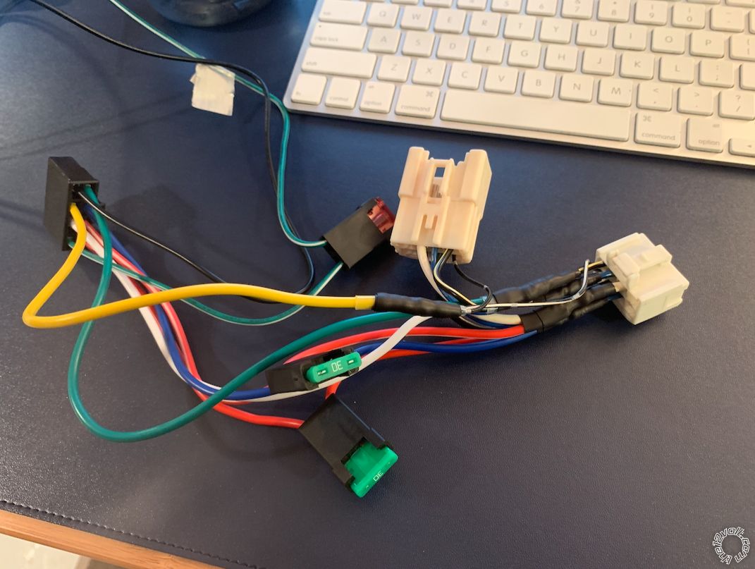

I lucked out and found this jumper in my "random parts pile," from the long-removed factory alarm, that goes between the ignition switch and factory harness. As a result, I was able to do most of of the soldering in the comfort of my home (it's 15 degrees outside), and without touching the harness that's in my truck.
Just have to get out there and do the locks, tach sensor, parking lights, and ground. I'll let you know how it turns out!

Posted: January 27, 2020 at 10:55 AM / IP Logged Link to Post Post Reply Quote oakbehringer
Got everything working, thanks again for the tips.
