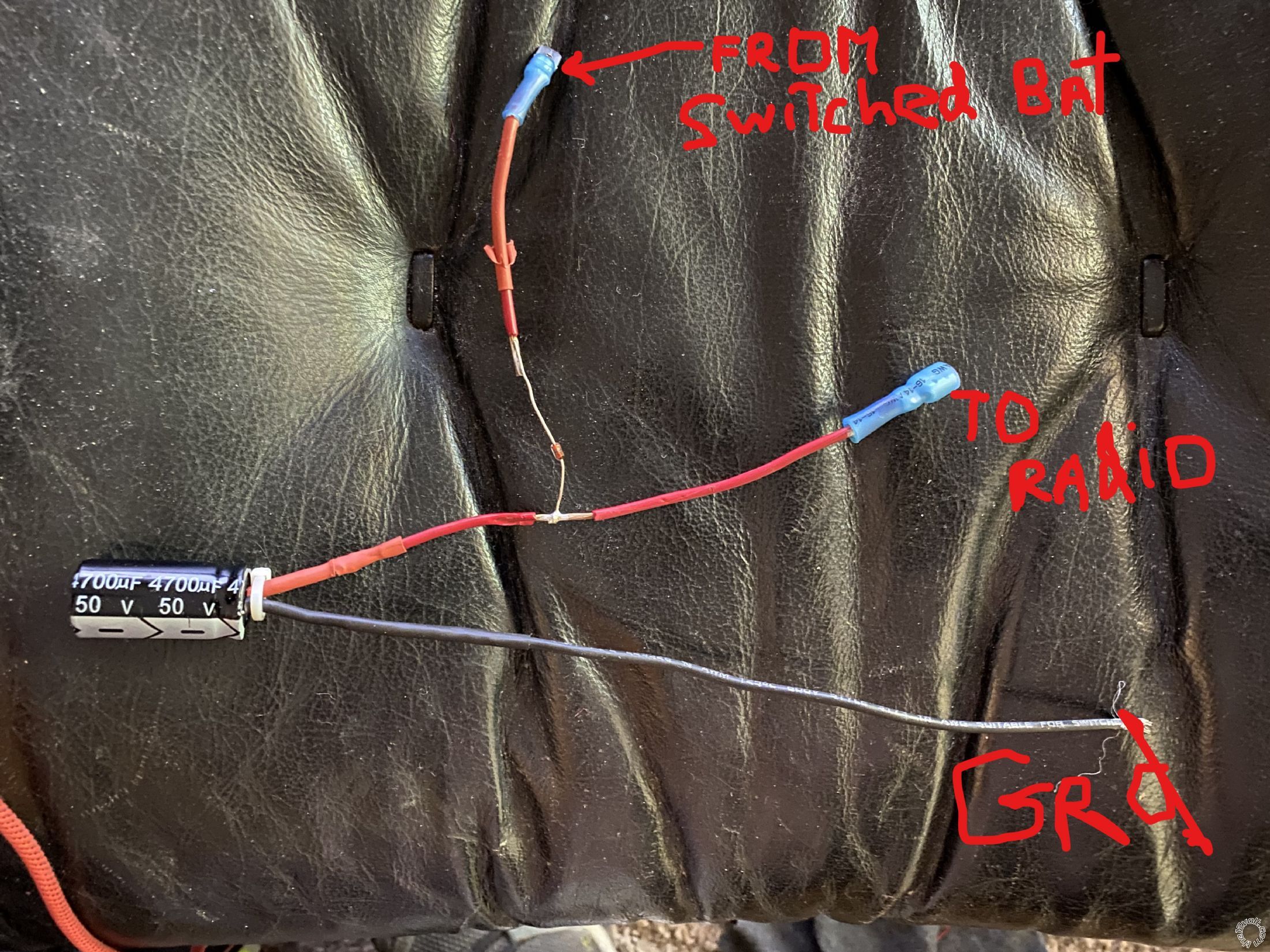

Sorry for the crude text. Best I could do on my phone. Keeping Power On to Alpine Head Unit Through Crank - Page 2 -- posted image.

That appears to be a 1N4148 or similar. Not near enough current capacity, for sure not enough to charge the 4700 mic capacitor. Replace that diode with only 1 of the 3 amp devices, you will be golden.

I believe (and was sold) it was a 1N4751A. I will make the change you suggest and report back.

That is a zener diode. When you get the other one, let us know if it works.

Success, eventually. I think there was damage to the 4700 capacitor pictured with the first install using the small diode as I changed to the new 3 amp diode and replaced the 4700 single capacitor to two (2) 3300 capacitors wired in parallel and it works perfect. I'm so thrilled. I'm just puzzled why the first attempt worked for at least 4 months, many start cycles and then failed. I'm just glad it didn't fry something in the Alpine head unit that warranty probably would have a issue with. Thank you for the help 'i am a 'genius''. It was very important to me to have success with this.
