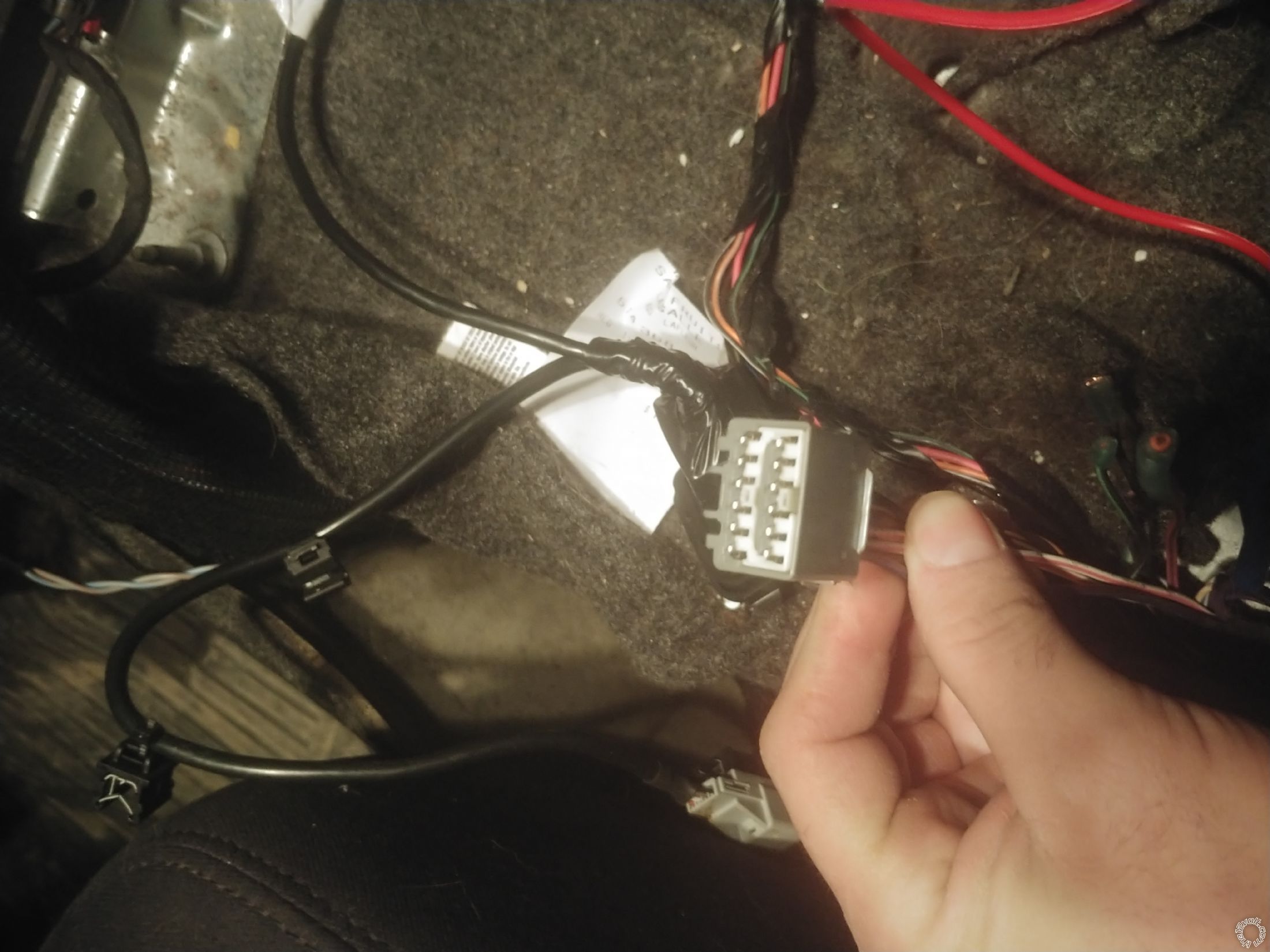

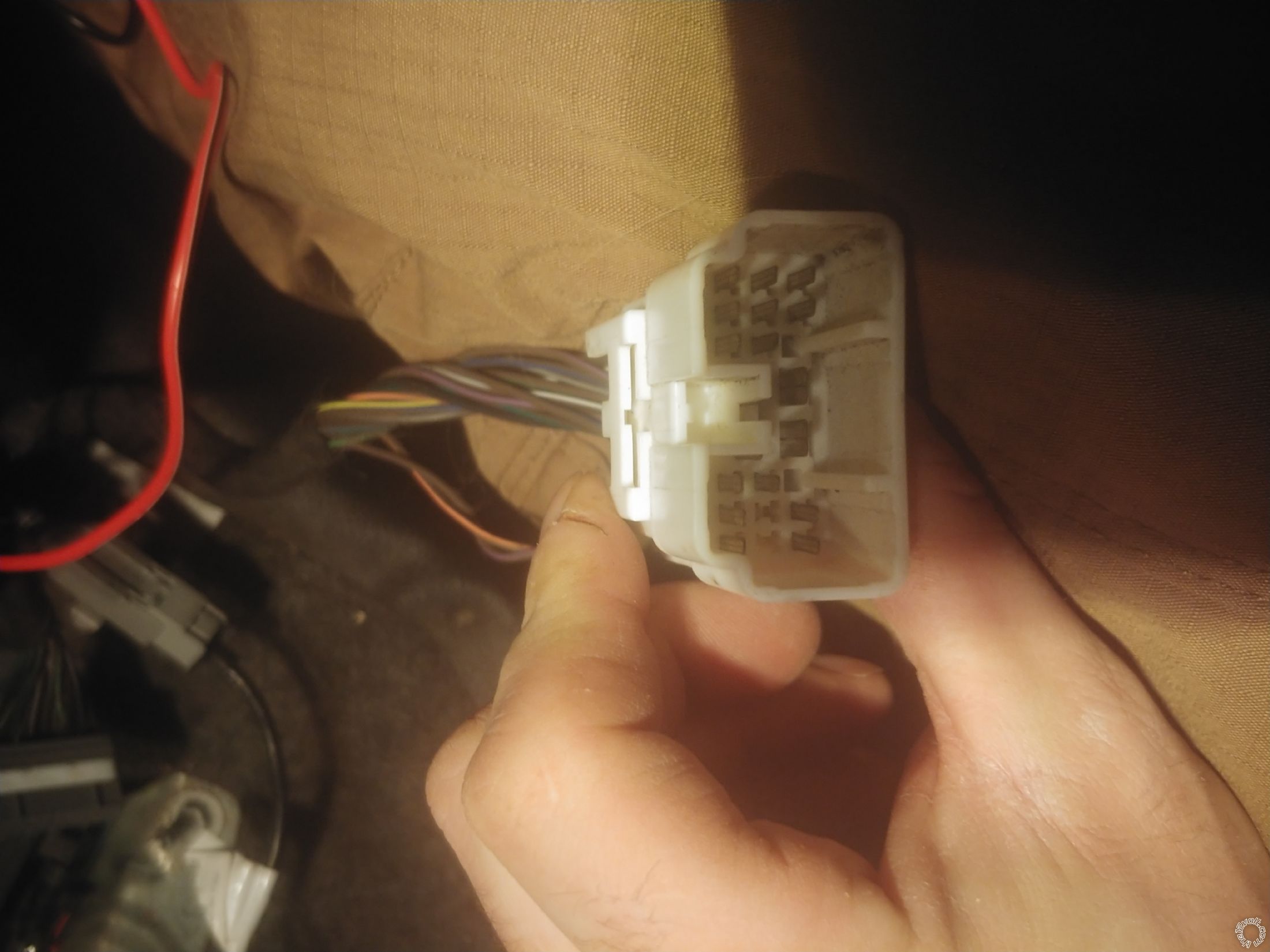

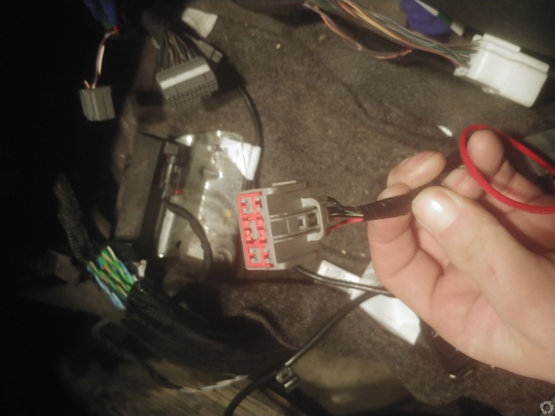

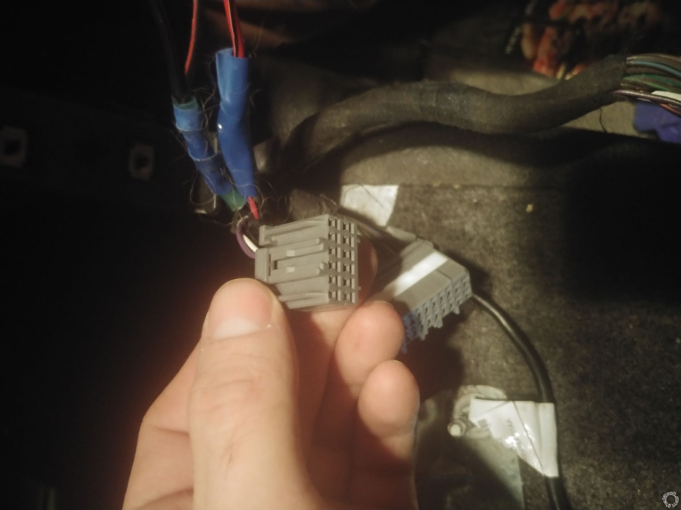

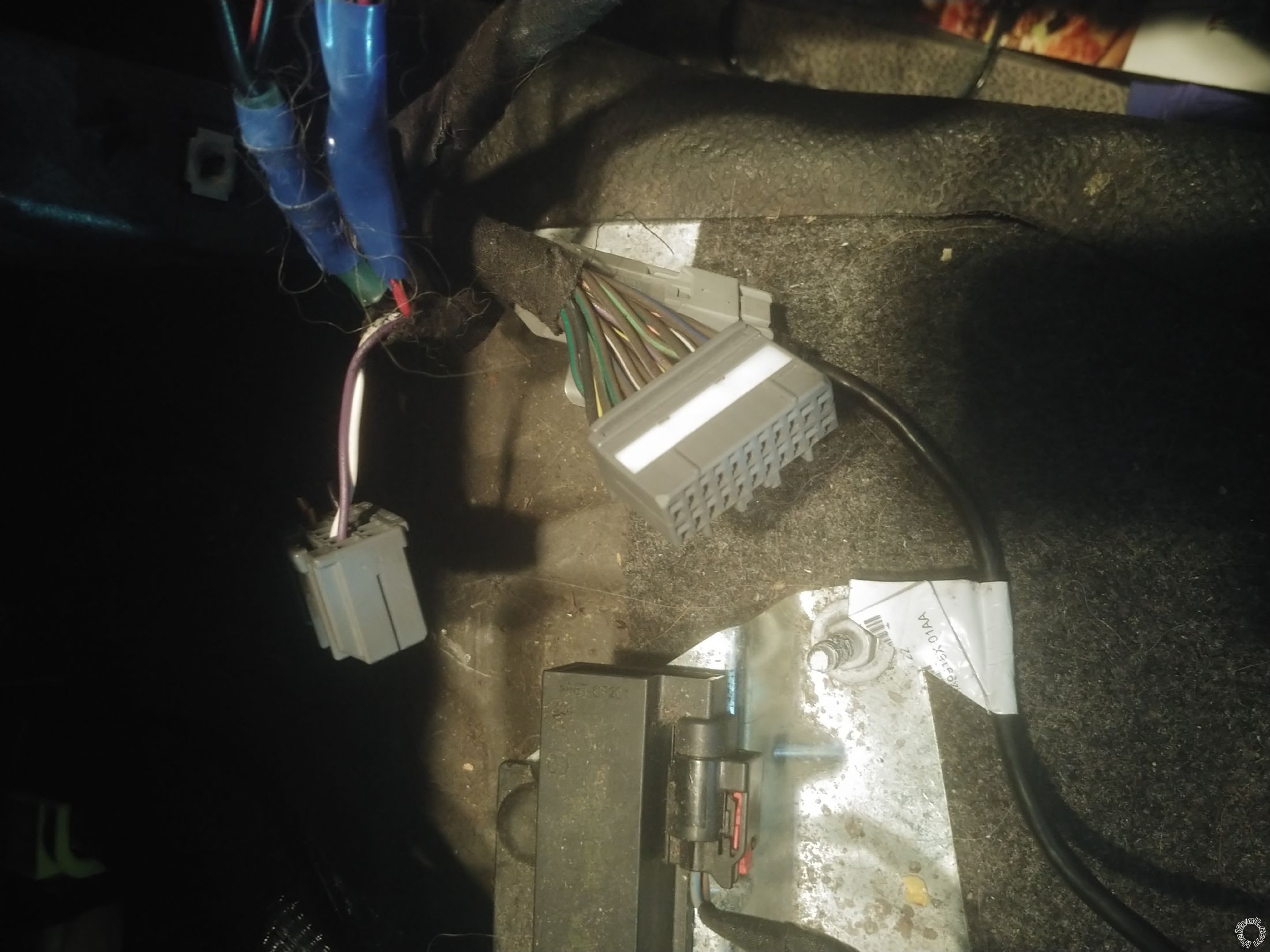

Posted: January 21, 2020 at 8:53 PM / IP Logged Link to Post Post Reply Quote guetta09
Hey so I looked and can't find any of those colors
Here are the pictures of the 5 connectors I have coming off the car in the center console area.
Do you have any idea which of those 4 has the wires in it ? And what pin number on those ? 2013 Dodge Charger Aux Wiring -- posted image. 2013 Dodge Charger Aux Wiring -- posted image. 2013 Dodge Charger Aux Wiring -- posted image. 2013 Dodge Charger Aux Wiring -- posted image. 2013 Dodge Charger Aux Wiring -- posted image.

Posted: January 21, 2020 at 9:23 PM / IP Logged Link to Post Post Reply Quote Ween
might take a peek here, see if anything looks close: http://connectors.dcctools.com/home.htm
and here: http://www.gfxlaw.com/files/_resource_files/63-quickstart-guide-mar-1-update-aye-ayw-poster-side-b-mar-2-052218014553.pdf
and this will probably help most: http://www.gfxlaw.com/files/_resource_files/75-2011-2019-chargerpursuit-upfitter-guide-100119104057.pdf
Platinum - Posts: 13,723
Posted: January 22, 2020 at 5:17 AM / IP Logged Link to Post Post Reply Quote i am an idiot
There are 3 wires. Orange - tan orange - lt. Blue and orange -dk. Blue. I am pretty sure they would not change color from deck to there. If you find them at the radio harness, use an ohm meter to find them in those plugs.
