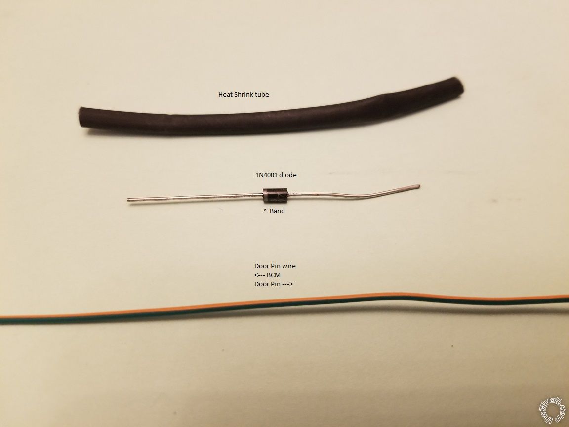

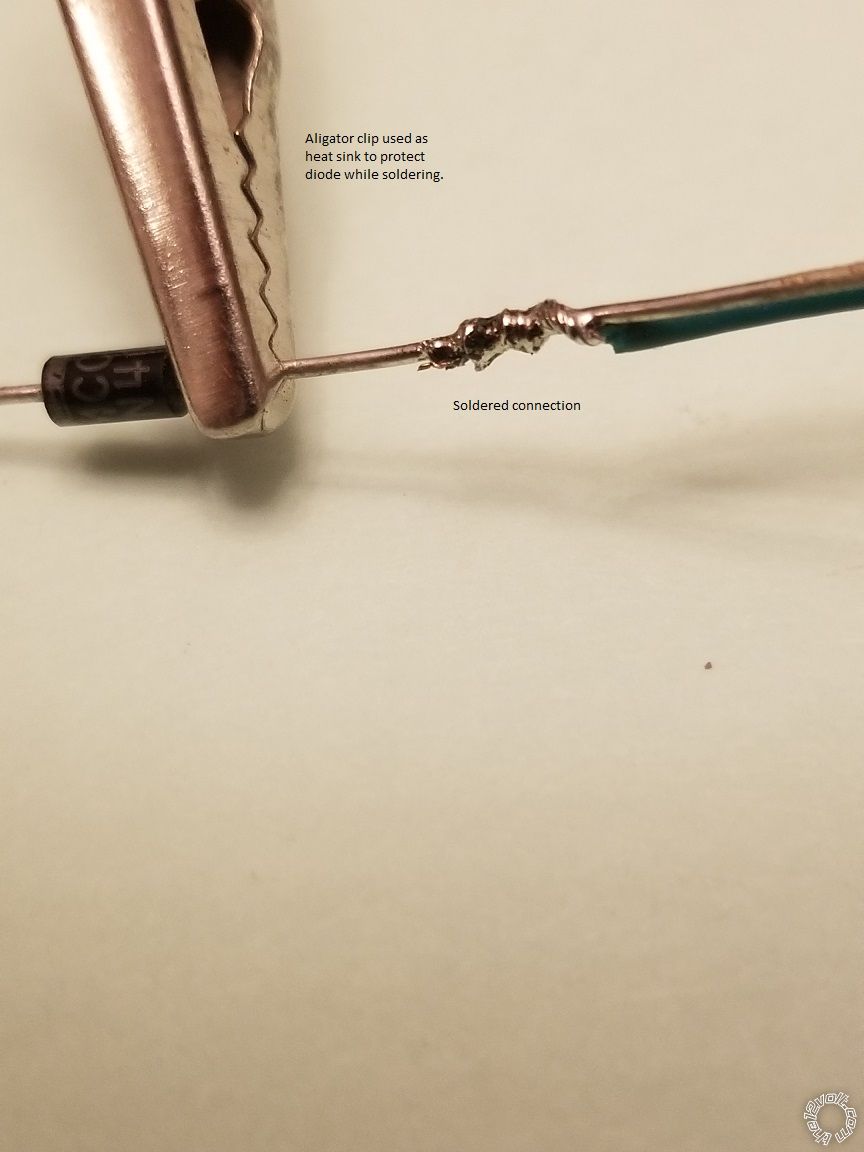

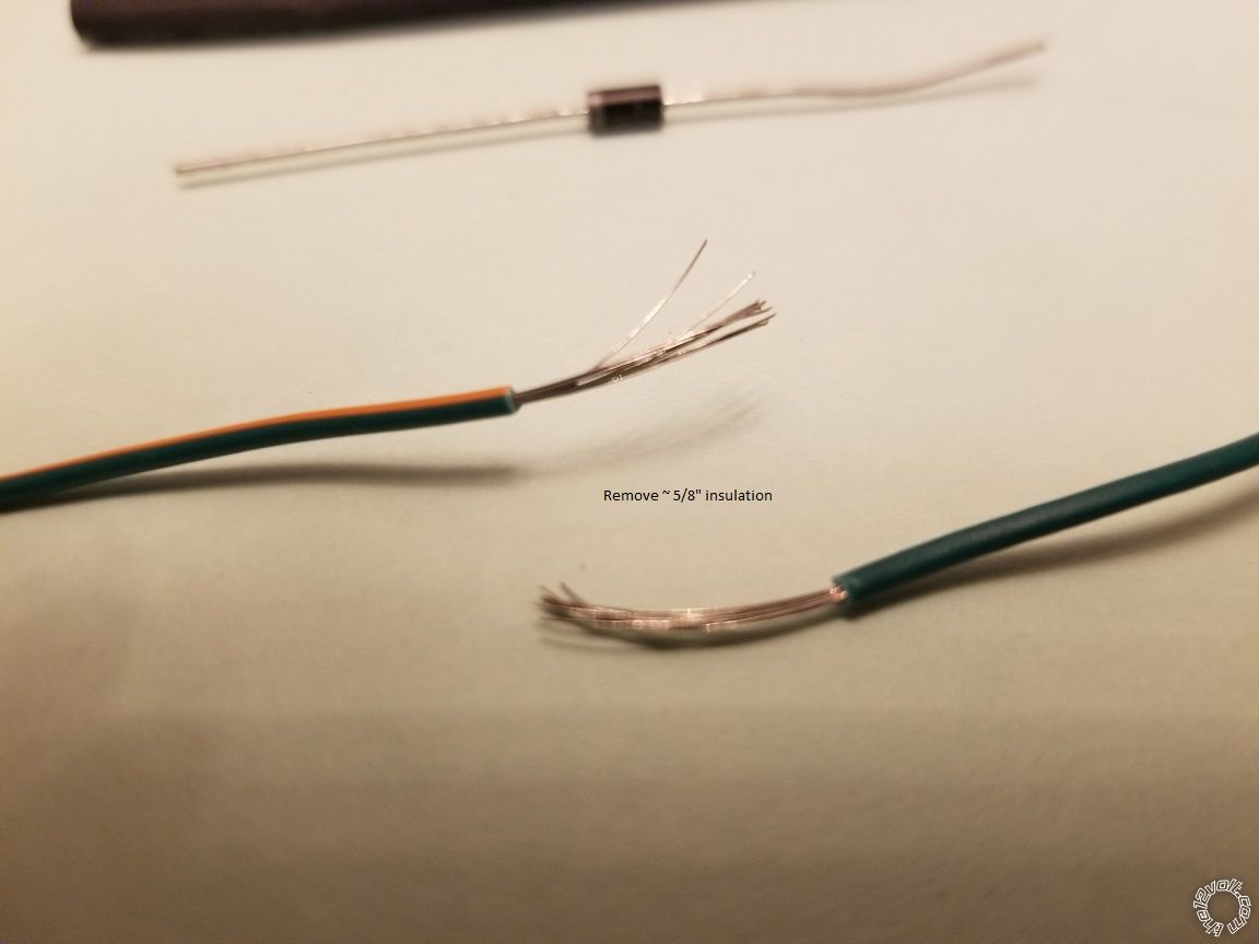

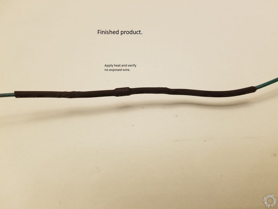

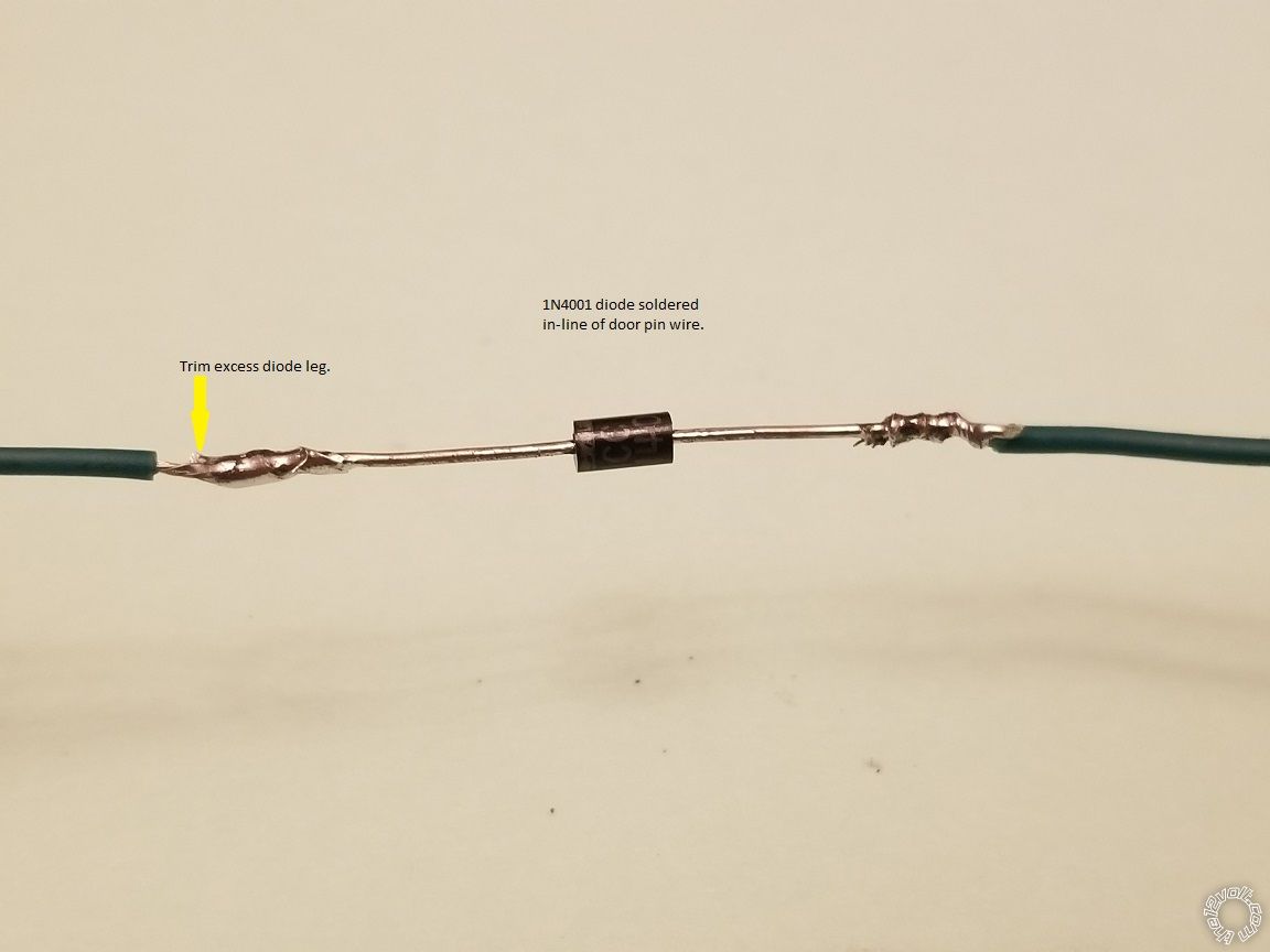

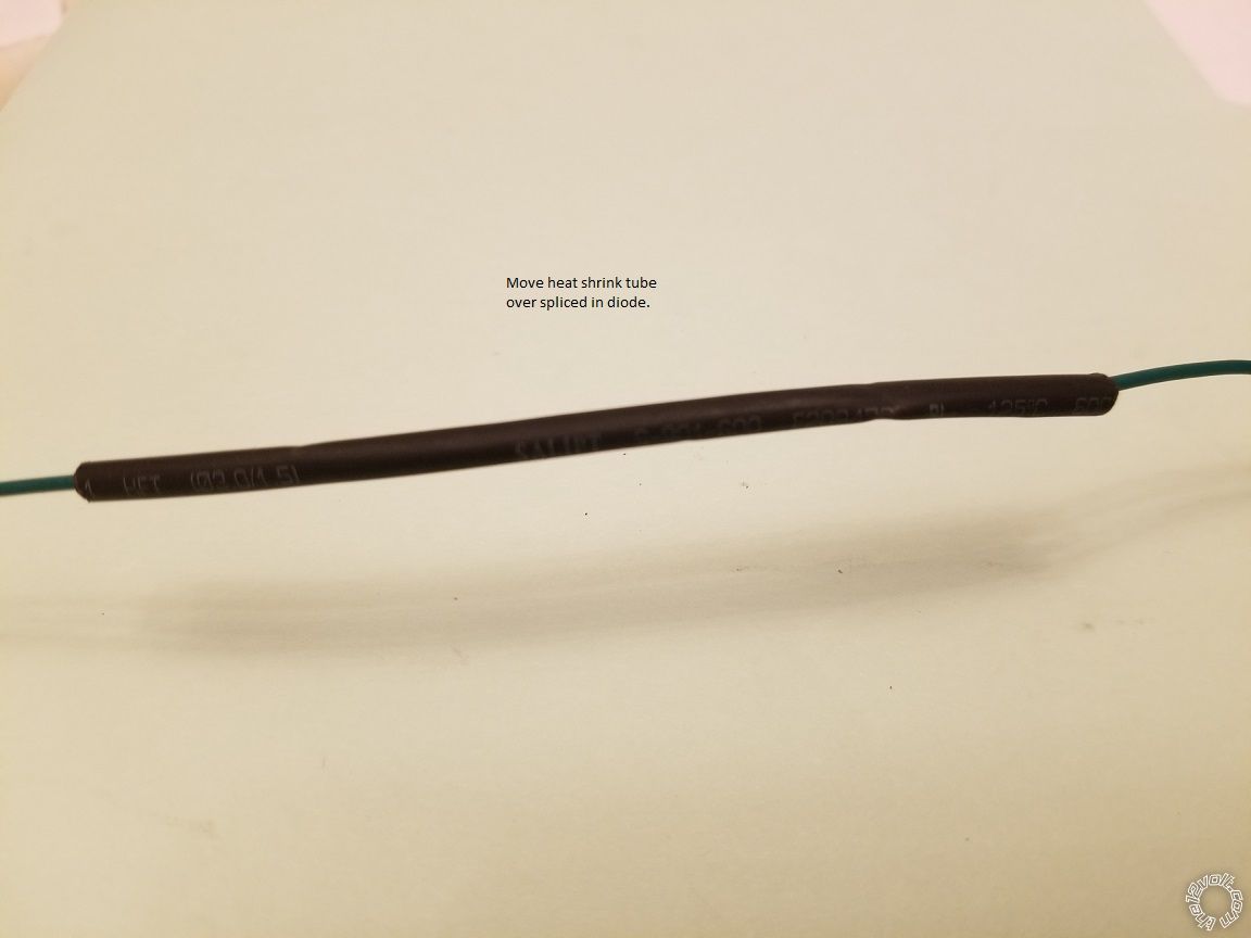

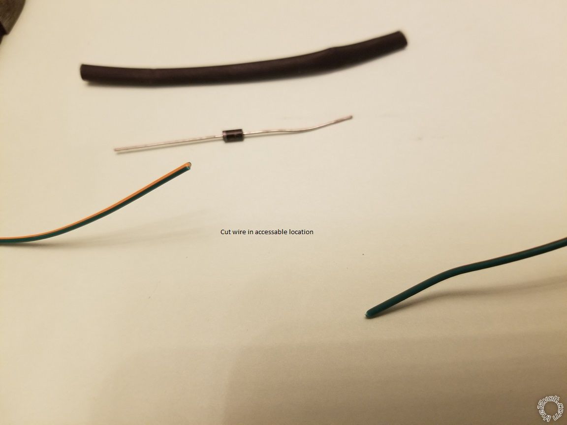

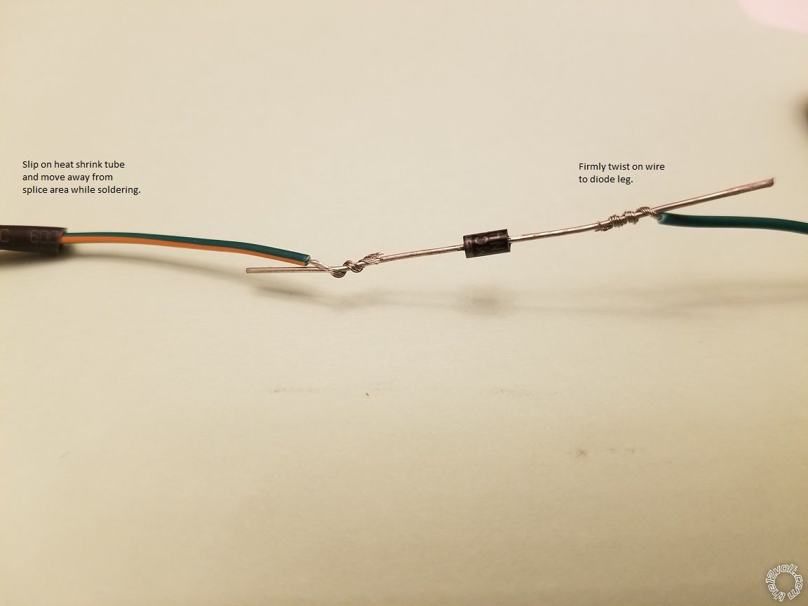

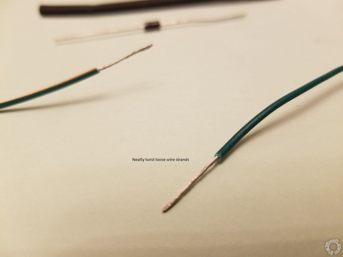

Is there a picture showing an actual installation of a diode. Do you just wire it inline by cutting the trigger wire for each pin switch? Just wrap with tape or shrink tubing?
bobbyZ
Platinum - Posts: 7,828
Posted: January 23, 2020 at 5:51 AM / IP Logged Link to Post Post Reply Quote kreg357
Here you go. These photos were "on-the-bench" and not in a vehicle so these are optimal conditions.
What you need:
Heat shrink tube
1N4001 diode ( 1N4004, 1N4007 etc will work )
Diagonal cutters
Wire strippers
Soldering iron
Solder
Heat sink ( alligator clip )
Bic lighter or heat gun
Ford E-150, SBJ, BCM, Diode Isolating Door Pins -- posted image.
