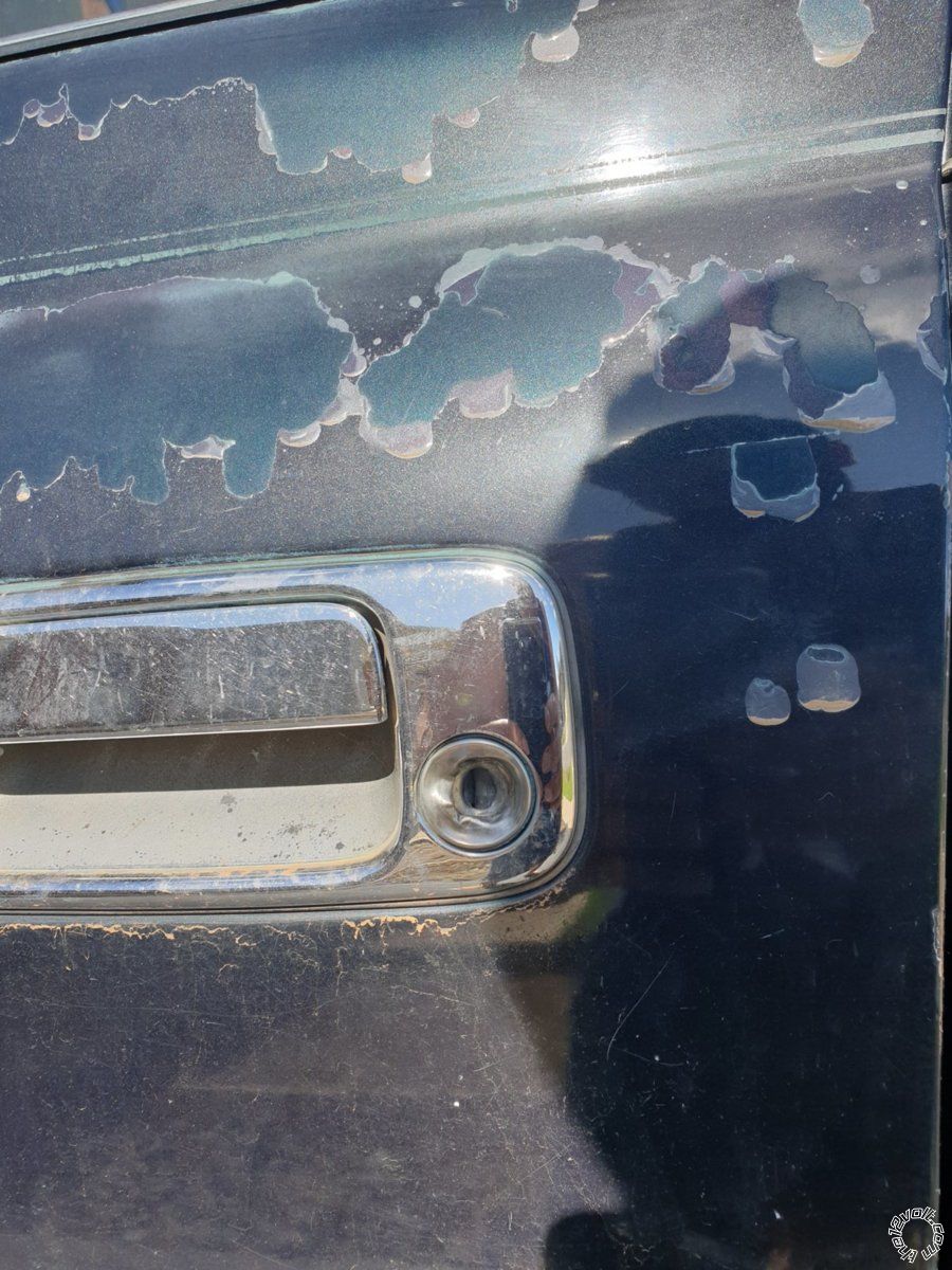

Hello legends
well i need your help with viper 3400v installation (i think it's almost same as viper 3100 ) in my 1994 Toyota 80 series Right hand driver because of Australia lol
so I'm after the door trigger and the parking light wires to complete the installation i know they are in the driver kick panel but there are plenty of wires there i got little bit confused
here is the installation manual came with the unit
https://www.directeddealers.com/manuals/IG/Avital/N3100%202011-12%20print.pdf
any help will be appreciated someone tried to hijack the car recently
Viper 3400v Installation, 1994 Toyota Landcruiser -- posted image. Viper 3400v Installation, 1994 Toyota Landcruiser -- posted image.
