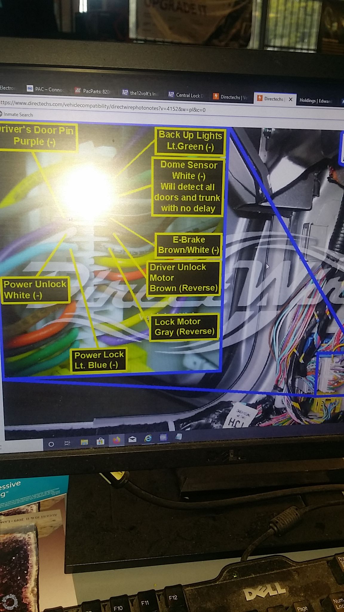

That vehicle is not from around here. You will have to check to see if it has these wires. And see if they act as they should when locking and unlocking the doors with the switches on the door.
Power Lock      lt. blue      -      driver kick, white 24 pin plug, pin 6      Directwire
Power Unlock      white      -      driver kick, white 24 pin plug, pin 5

Central Lock Diagram, 2010 Chevrolet Optra -- posted image.
