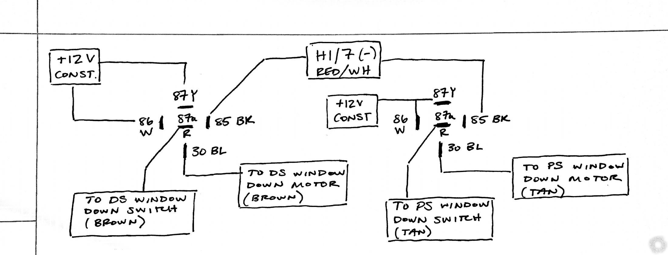

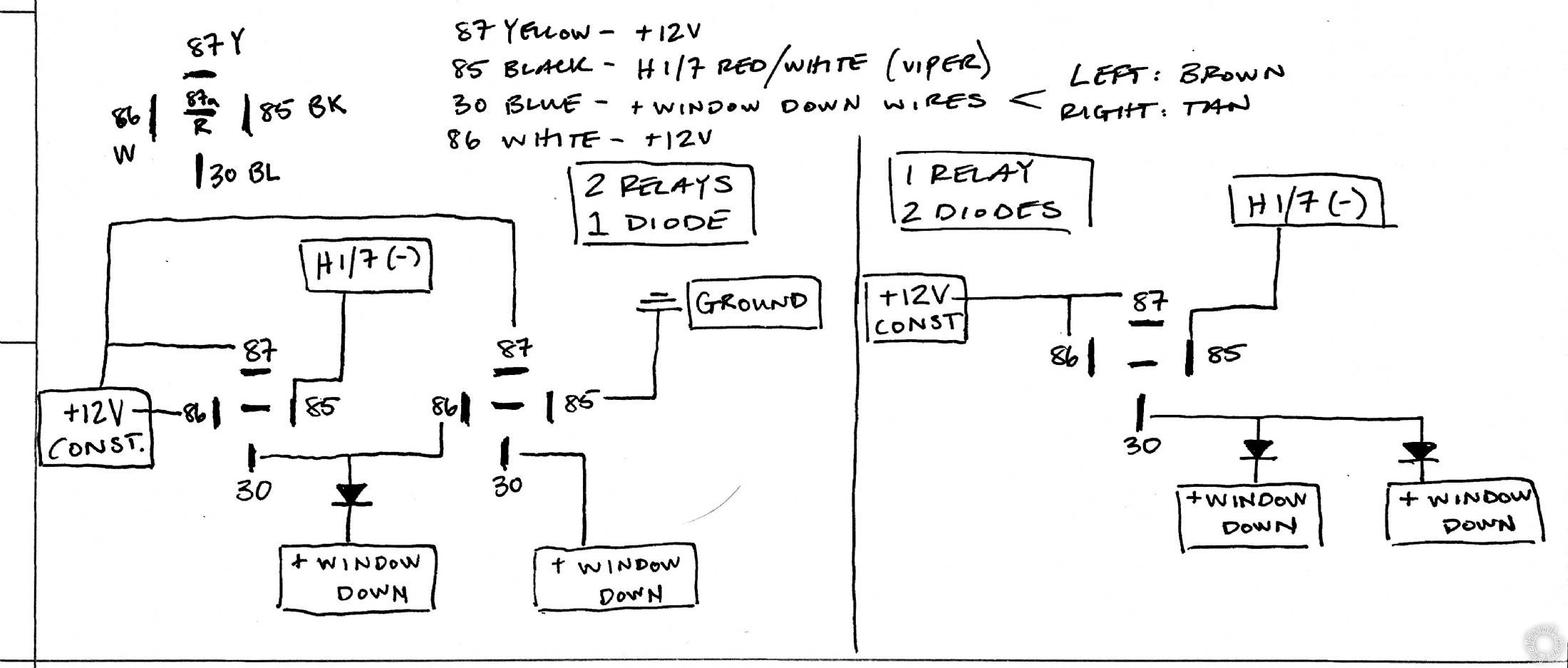

I installed a Viper 4105 keyless entry/remote start system on my 97 Chevy pickup about 6 months ago. I also installed the DEI 529T window module which I wired to roll my windows up with the door lock pulse (love it, works great.) I have some relays leftover from the install and would like to use the AUX controlled-duration trunk release output to roll both windows partially down. I'd like to use my leftover relays as oppose to buying another 529T module to achieve this. Below are two rough diagrams I drew up:
Trunk Release Output to Roll Windows Down, Viper 4105 -- posted image.
I'm assuming one relay (right side) is not wise...I haven't tested the window motors for current draw but it's likely they're close/exceeding the 30A relay rating. The Viper unit install guide states the aux output is rated for 200mA current max, i.e. one relay coil. So the left side diagram is my attempt at energizing both coils without overloading the aux circuit. I believe the diode I have drawn in would prevent that window down circuit from energizing the other relay if I was to roll that one window down with the factory switch. Would I need other diodes in the left side diagram?
Would either of these work, or am I way off here?

Both of your diagrams look Ok to me, in that they will work and provide what you're after. The one thing I see is that the diode(s) in the motor circuit will need to be rather large, probably 10 Amp-ish each. Personally, I'd probably go with two relays one for each window, no diodes, and parallel the coils.
Relay coils are right around 120Ma, so two will be .240Ma. While not recommended, I've been running two coils on the .200 Ma IGN output on a DEI 551 remote start for 7 years at the rate of about 10 cycles a week, and it is still working. Your window usage will probably be about the same, 10 cycles a week.
I would definitely put an anti-spike diode across at least one of the coils, band towards (+) if you run two coils in parallel.

Thanks davep, I ended up wiring them like this:
Working well so far!
