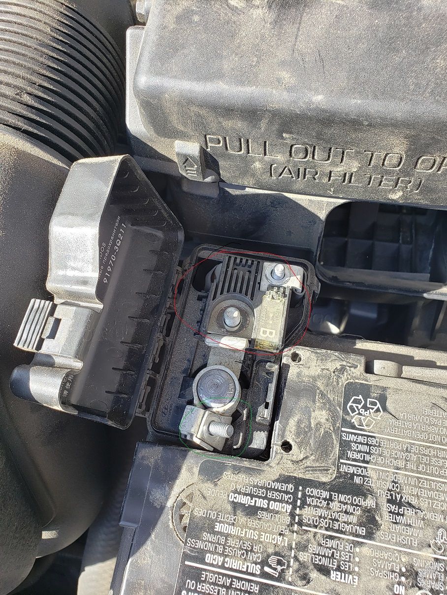

Hi all.
I need to run two 0 gauge wires out of this positive battery terminal. But I don't know how to handle the excess connections you see in the pick? Any suggestions? Can I put 2 ring terminals on the bolt shown in green? Thank you.
How to Work with This Battery Terminal? -- posted image.

There is no point in running larger gauge wire from the battery than the wire from your alternator to the battery.

Right but I need a run to alt and amps.

IMHO - I'd remove that terminal and get yourself a battery terminal that allows you multiple 0 gauge (or lower) connections. In regards to that 180a fuse. Replace it with a AGU fuse holder (and of course a 180a fuse). This will allow you to have plenty of room to work with. Not having to force wires in awkward positions, plus this would be a lot safer. Sky High Car audio and ILL Customz make the type of terminals I'm referring too.
