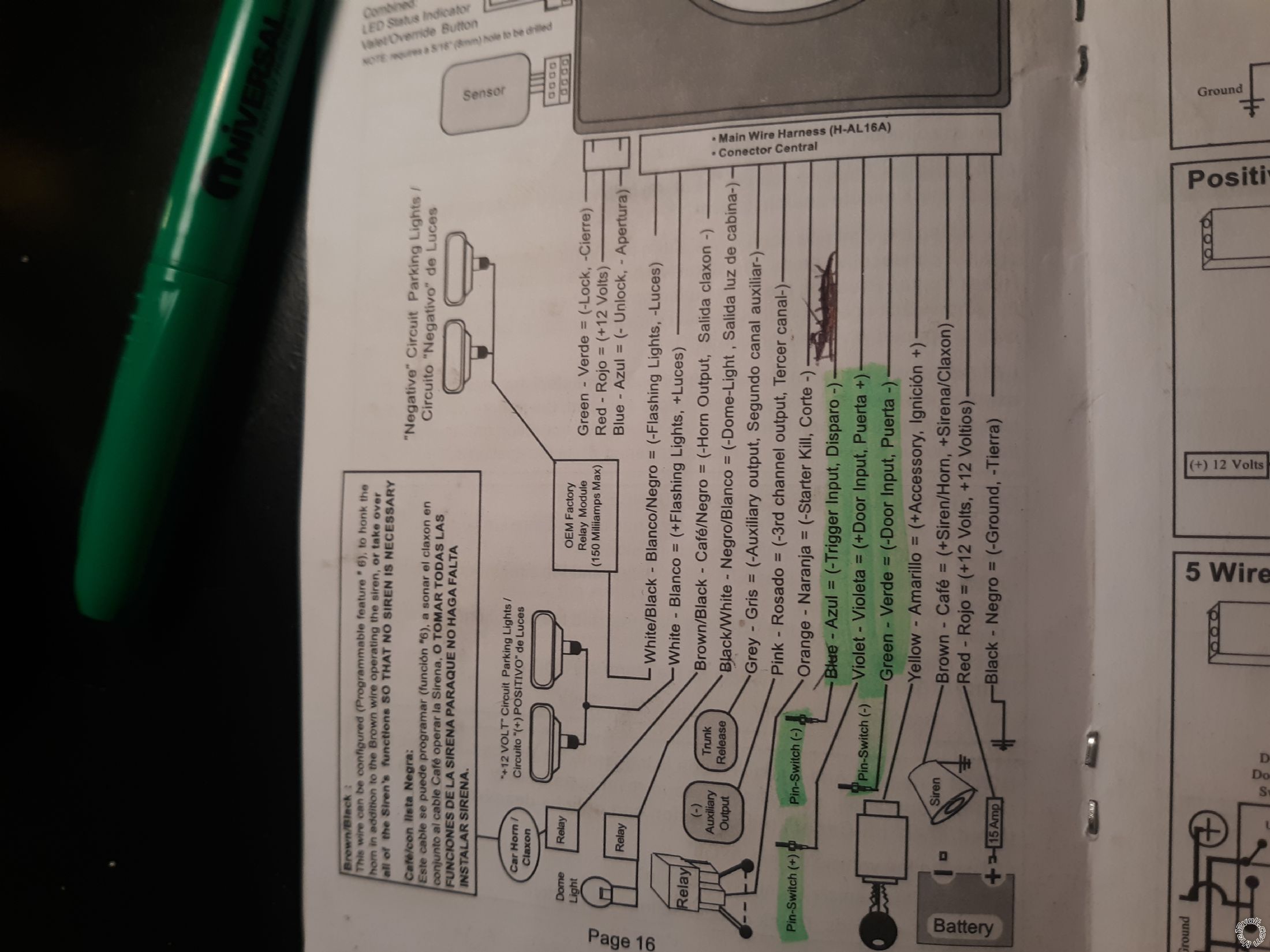

My truck is manual everything. No power. Where would I hook the door pos and neg. Input wires?
It's an excalibur al-560. Any help would be appreciated. 2004 Ford F-150, Door - and + Input Wires on Manual Locks -- posted image.

The violet wire of the alarm needs to connect to the black with a light blue striped wire at the drivers side kick panel. It will be inside the large harness that goes to the rear of the truck. To test it to make sure it is the correct wire, it will read 12 volts anytime the dome light is lit.

Ok. Thanks for reply. I've seen a bunch of different things on a bunch of different websites. So I can just cut and tape off all the wires including dome light to relay? And the green wore and the blue wire just cut??
