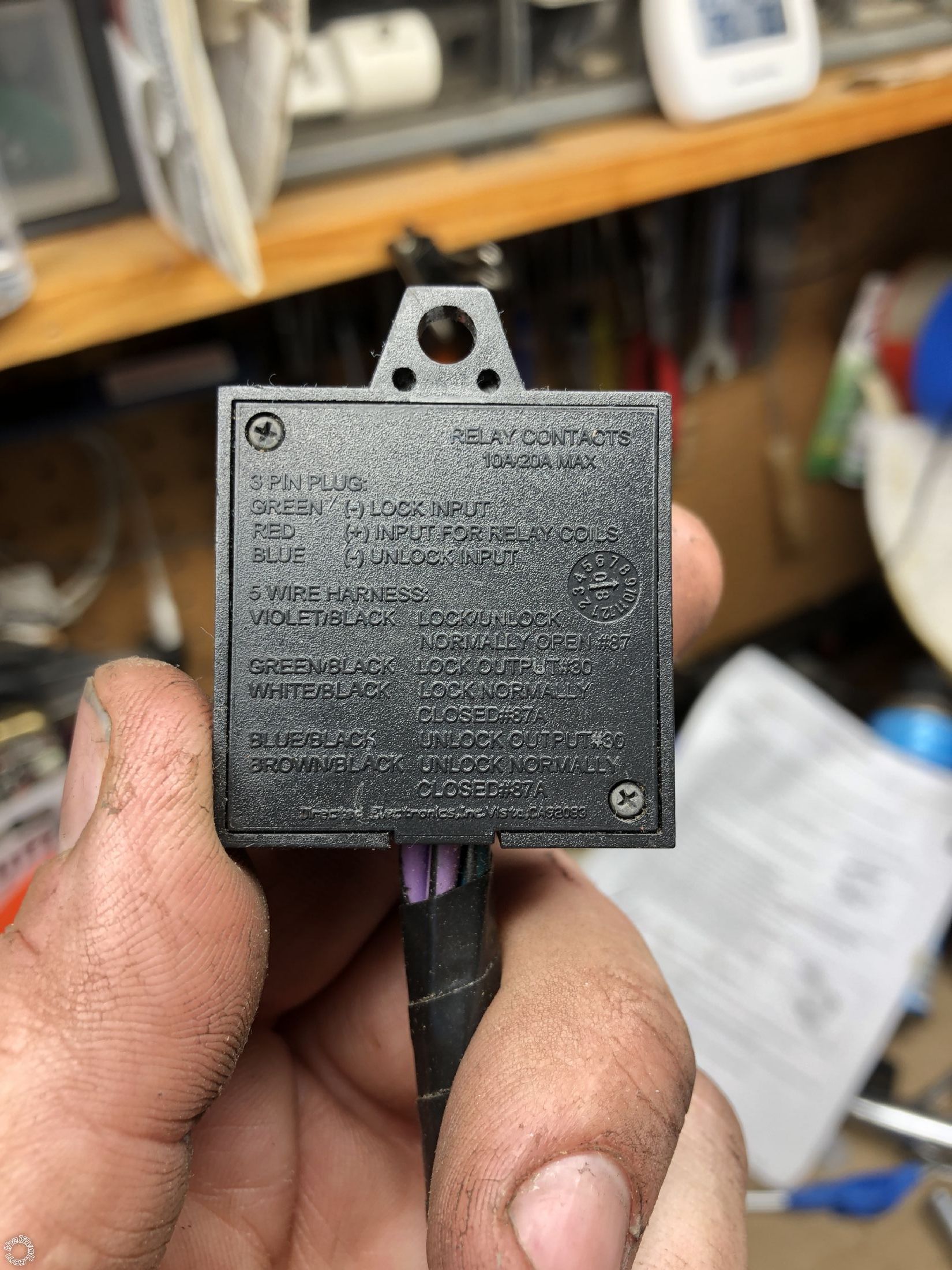

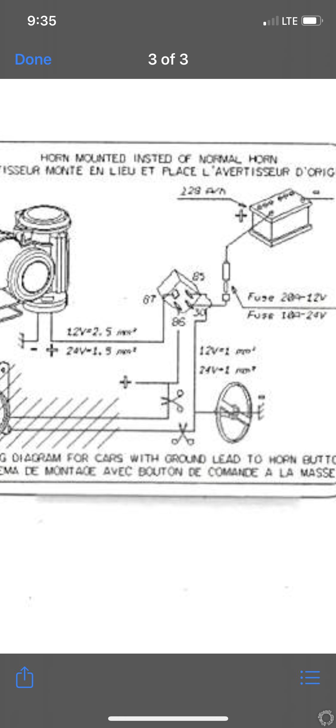

Does anyone know if this can be done? basically i can’t find any relay and sockets at my house but i did find a 451m and i need to wire up a horn relay for a motorcycle. Even if i could find the pin outs for the 451m i’m sure i could figure it out. this is the diagram they gave me DEI 451m as a Regular Horn Relay? -- posted image.
and this is what’s on the back of the 451m DEI 451m as a Regular Horn Relay? -- posted image.

Using your diagram, red is 86, green is 85, violet/black is 87, green/black is 30.
