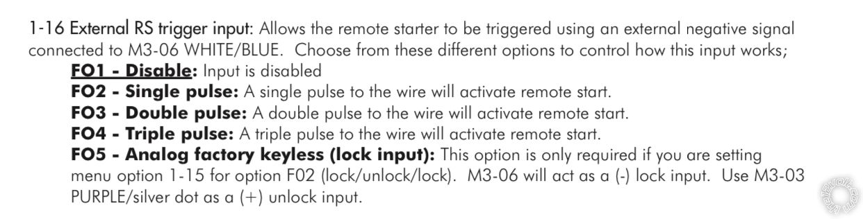

Hey all, just want to check to see if I am able unlock doors and disarm a compustar DC3 with an input. I noticed this in the master guide and just wanted to see if this would be what I’m looking for or if there’s another way to do it. Thanks!
Compustar DC3 Unlock Input? -- posted image.

That wire will not unlock and/or disarm the DC3.
