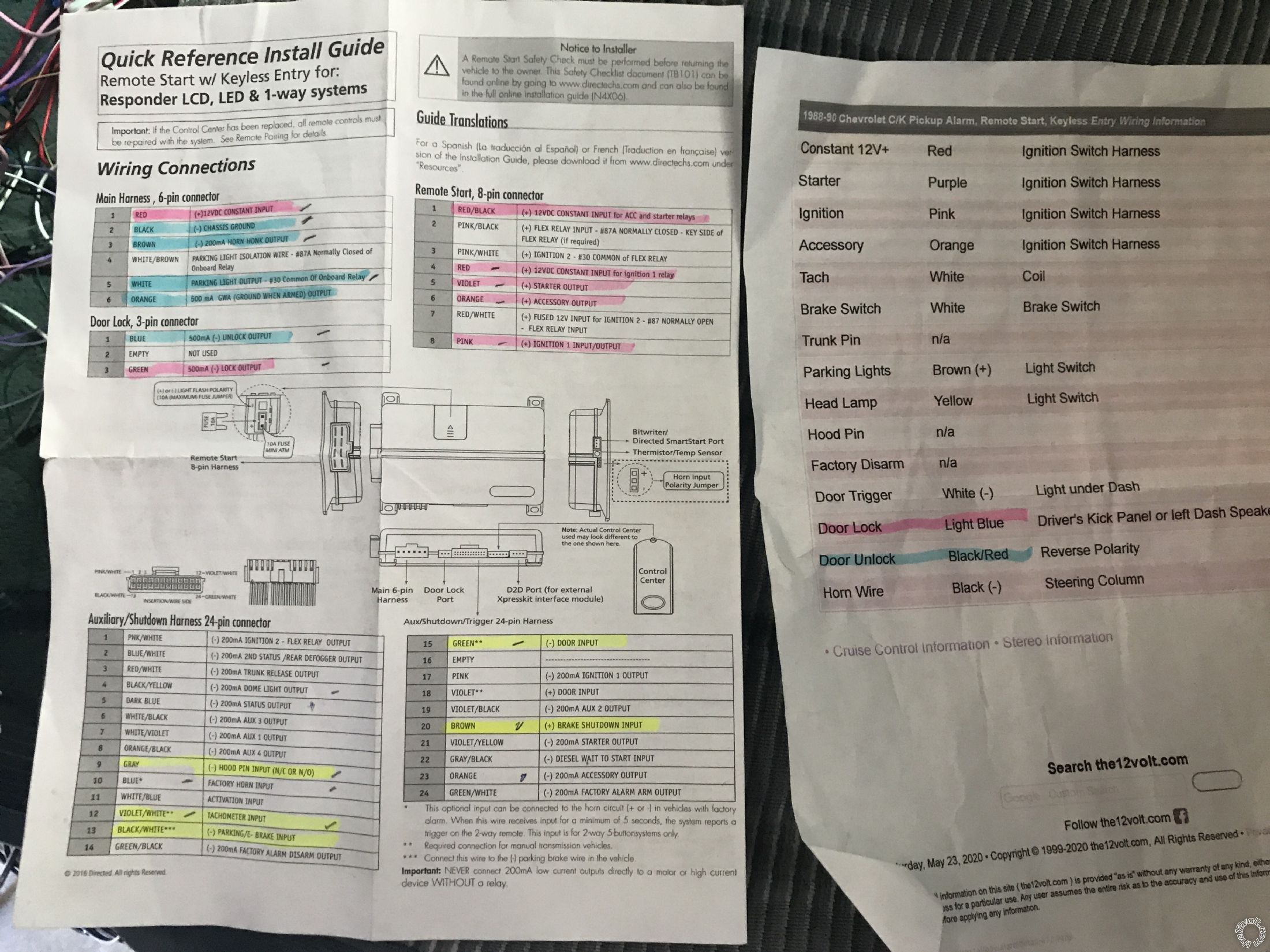

Hello everyone. I’m new here and need help connecting a viper 4806v to get my truck started. I don’t understand the remote start 8 pin connector . Which wires do I hook up ? How do I set up relays for the second ignition? What wires do I use from the 8 pin ? I have the truck wires ready I just don’t know how to go about it . Thank you all . 1990 Chevrolet C1500, Viper 4806v -- posted image.

Think you got it pretty much figured out, going by the highlighted wires.
Red and Red/Black will go to +12V Constant.
Pink Ign1 will go to Pink Ign1.
Violet will go to Purple Starter.
Orange will go to Orange Acc.
Going by the wire chart, your truck does not have a Ign2 or Acc2 so the Pink/White is not used as are the Red/White supply and Pink/Black wires.
Double check your power lock wires, they might be Type A (+). In that case the 4806 Type B (-) outputs won't work. You will need a 451M door lock module to make the - to + conversion
That should do it unless your truck has a manual transmission.

Thank you for your help, I got it working.
