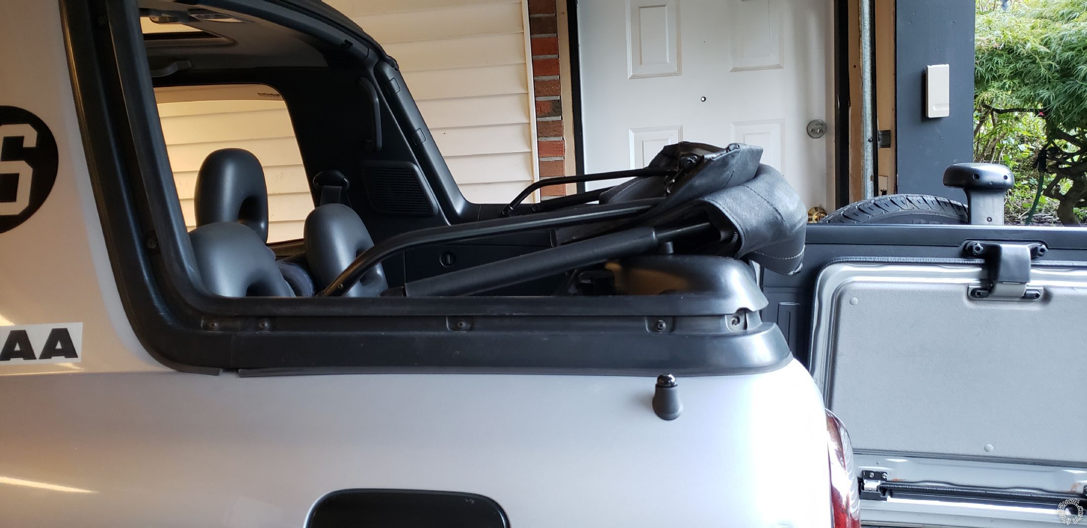

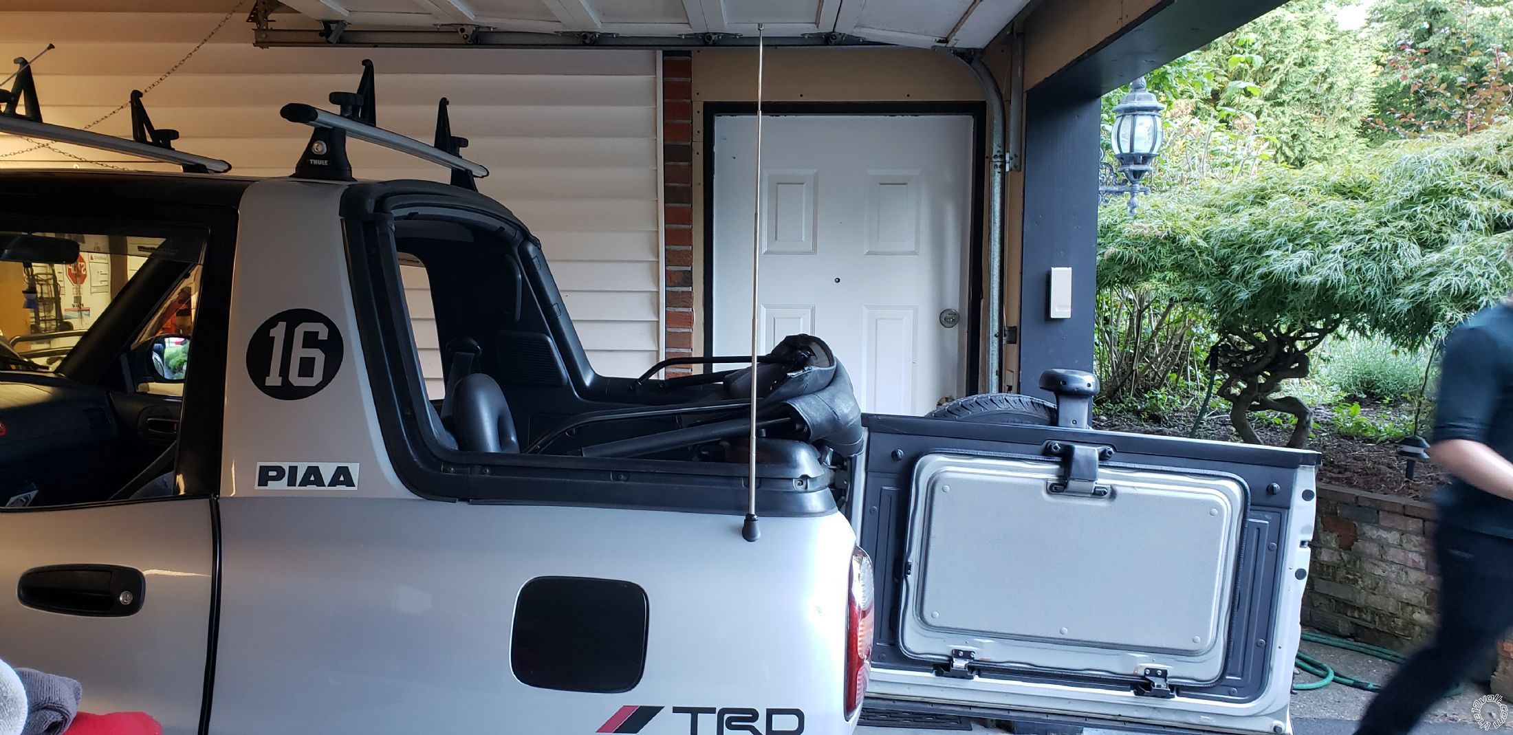

Posted: July 02, 2020 at 12:46 AM / IP Logged Link to Post Post Reply Quote namyenruoj
I have decided to re-use my Alpine UTE-42BT instead but I have to install this brand new power antenna for my 1998 Toyota Rav4 today. It works, antenna goes up when i select radio and it goes down when I set to Bluetooth/USB and so on. I connect my power antenna wire to blue wire off the deck harness. Thank you guys. Car Deck That Will Raise Power Antenna with Tuner Only? -- posted image.
