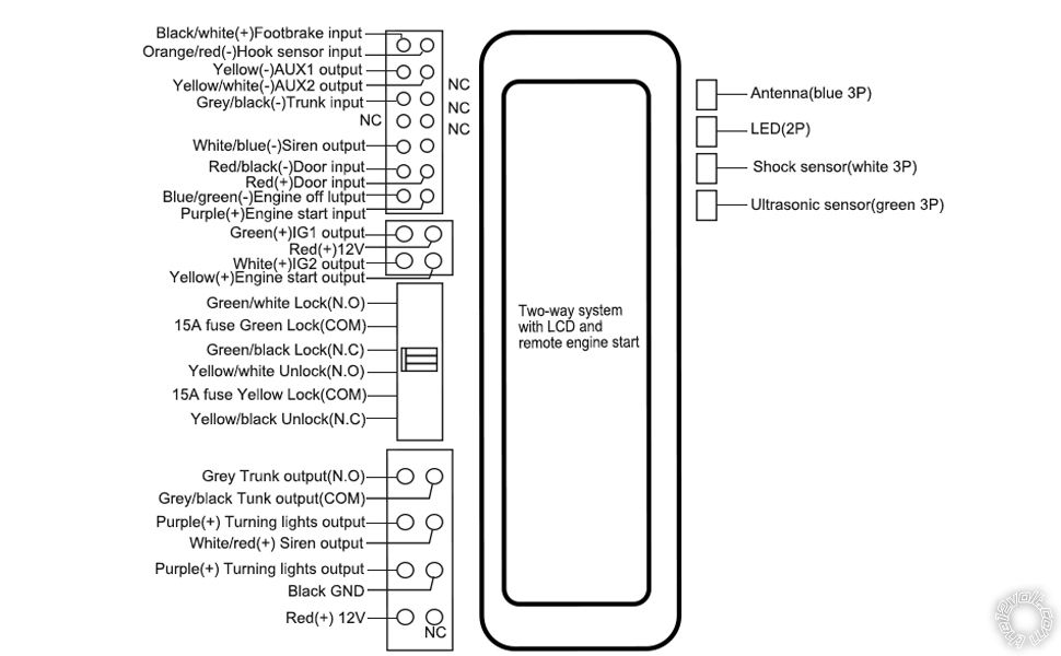

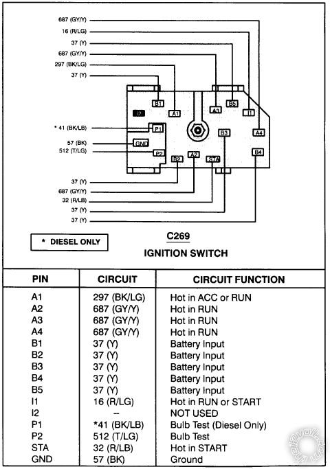

hi guys i have a 97 f350 with the 7.3 auto im trying to install a giordon rs/alarm system and im getting stuck on some of the wires. they are the hook sensor, i was thinking this went to the tach and im also not sure on how to wire the ignition off wire. im also thinking i have 3 ignition wires. do i wire the 3rd acc to the aux 1 output. thank yal for the help1997 Ford F-350 Auto 7.3, Giordon Remote Start/Alarm -- posted image.1997 Ford F-350 Auto 7.3, Giordon Remote Start/Alarm -- posted image.1997 Ford F-350 Auto 7.3, Giordon Remote Start/Alarm -- posted image.
