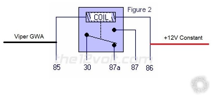

I'm not sure I understand your question. It's a little vague and there are a lot of possibilities. Below is a standard SPDT relay.
Viper 5806v Remote Start, MTS, Door Inputs, Window Modules -- posted image.
With the Viper GWA connected to Pin 85 and +12V Constant connected to Pin 86, the relay will draw no power until the Viper is armed.   Once the Viper is armed, it outputs the GWA signal which energizes the relay.
Remember that we are not including anything connected in any way to Pins 30, 87 and 87a. When the Viper outputs the GWA signal the relay will energize and draw current. While there is a momentary surge, current draw for a common 30/40 Amp relay is less than ~80 mA.

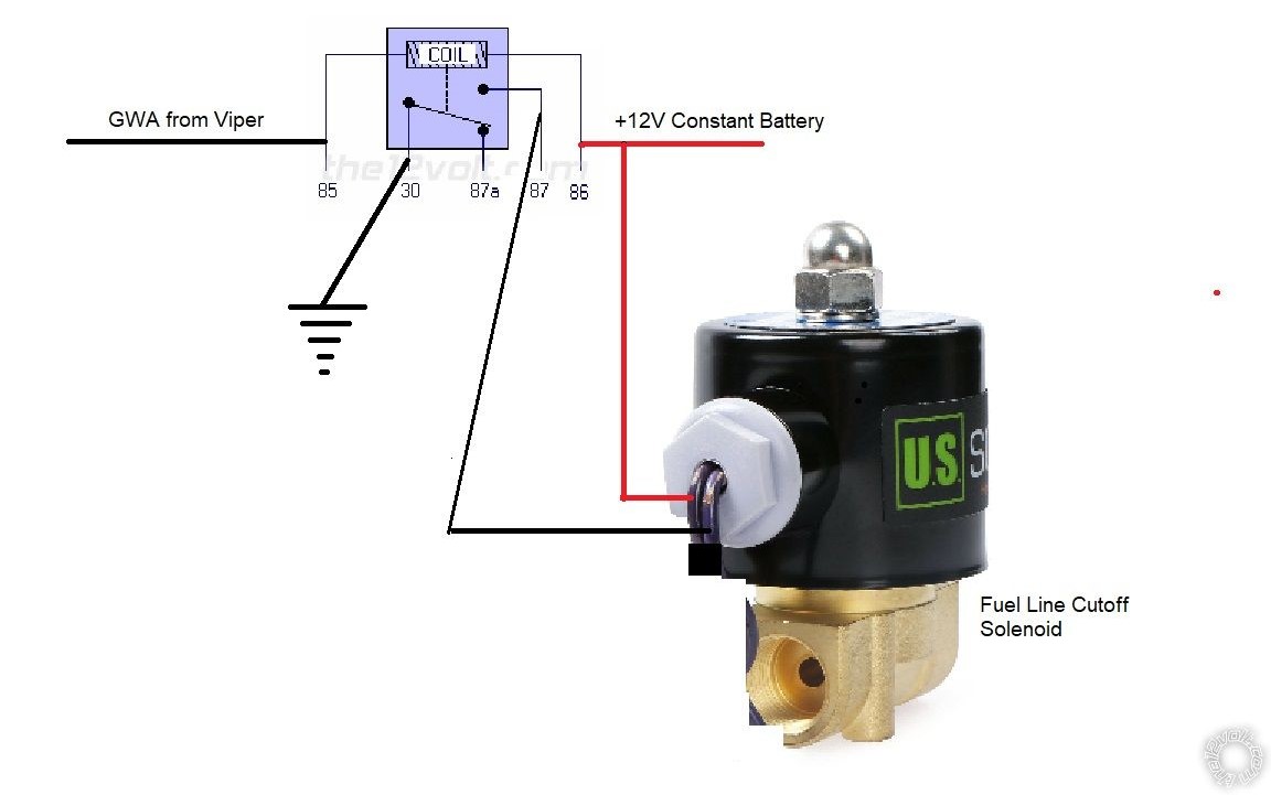

Below is a standard automotive style Bosch SPDT 30/40 Amp relay and a +12V Fuel Cutoff Relay ( N.O.) The N.O. means that the solenoid is Normally Open and will allow fuel flow until the solenoid is energized with +12V. The only time the Fuel Line Cutoff Solenoid will be energized is when the SPDT relay is energized. The relay has constant battery on one side of the coil. The coil will be controlled by the GWA signal from the Viper. When the GWA signal is present, the relay energizes and moves the wiper arm from Pin 87a to Pin 87. This will allow Chassis Ground from Pin 30 to Pin 87, completing the fuel cutoff solenoid circuit, energizing the solenoid and cutting off the fuel supply.
This circuit will draw no current when GWA is not present. The Viper only outputs the (-) GWA signal when it is armed. The N.O. Fuel Cutoff Solenoid will allow fuel to pass without drawing any power. Wired this way, both the relay and the Fuel Cutoff Solenoid will be drawing power while the Viper is armed and the engine is OFF. This will deplete the vehicles battery pretty quickly. Going with a more common N.C. Fuel Cutoff Solenoid will draw less power during this period but requires the solenoid to be powered to enable fuel supply to the engine. This is not a big deal with a running engine but adds another point of failure during normal operation (power loss to solenoid ).
