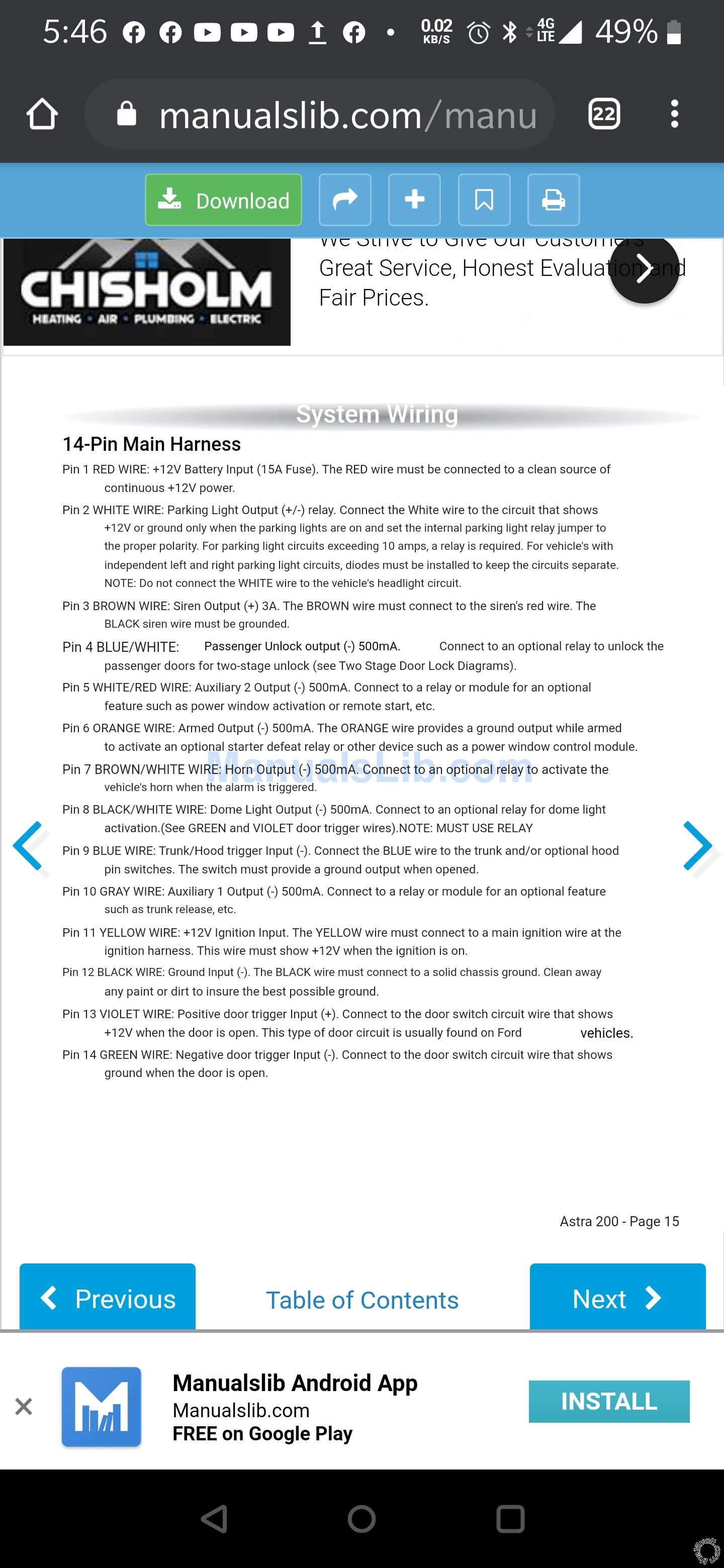

I bought the Scytek Astra A15 alarm with remote start and keyless entry from eBay and there is no installation manual. I found a manual for a different Scytek Astra model. The wires seem to be the same... red, white, brown, blue w/white, white w/red, orange, brown w/white, black w/white, blue, gray, yellow, black, purple and green. Red goes to constant 12 volt power. White says, "Parking Light Output (+/-) relay. Connect the White w +12V or ground only when the parking lights are on and set the internal the proper polarity. For parking light circuits exceeding 10 amos, a relay independent left and right parking light circuits, diodes must be installed NOTE Do not connect the WHITE wire to the vehicle's headlight circuit."

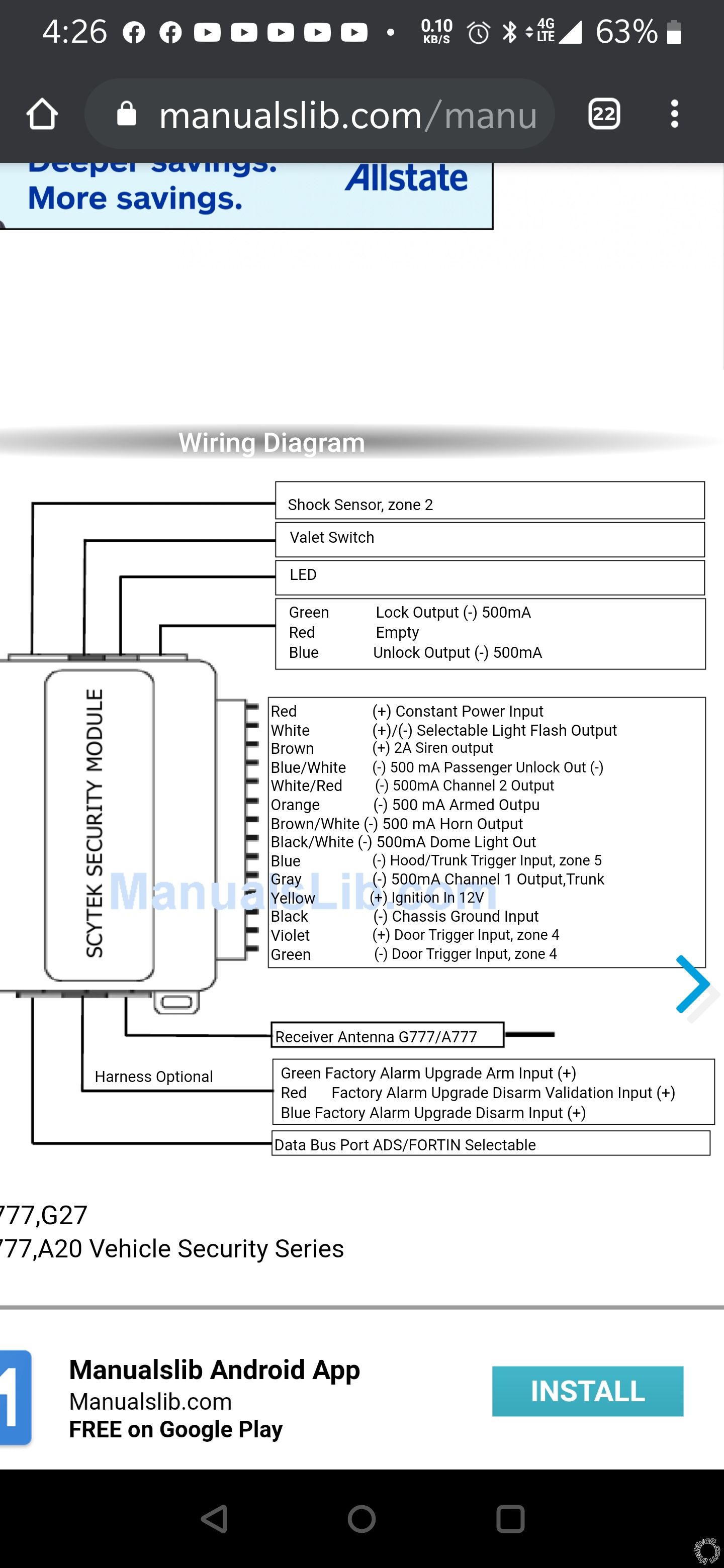

I have a 2018 Nissan Versa sedan. I have no idea where to connect the white wire. I have no idea what polarity my parking lights are. In fact, I have no idea where to connect any of the wires except for the red one. I know how to connect that one to a constant power in my fuse box. Can someone please tell me where to connect the other wires? I'll attach screenshots of the other models wiring diagram. Thanks in advance!!!
Scytek Astra A15 into 2018 Nissan Versa -- posted image. Scytek Astra A15 into 2018 Nissan Versa -- posted image.

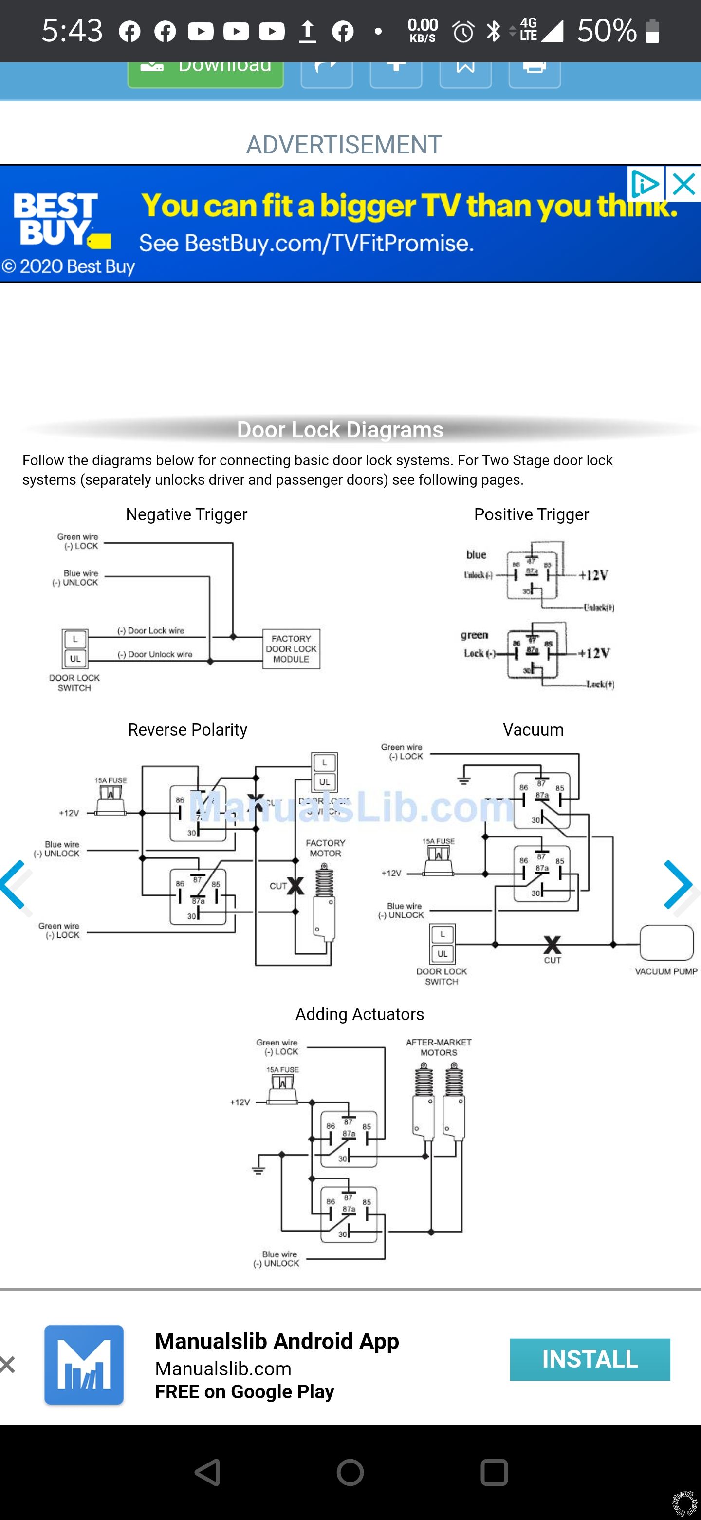

I accidentally posted the wrong pic. I did buy 4 relays in case I need them for my power door lock upgrade. Here's the other wiring diagram. Thanks! Scytek Astra A15 into 2018 Nissan Versa -- posted image.

The White wire at Pin 2 of 14 can be set to either a (+) or (-) Parking Light Output via an internal jumper. Set the jumper to a (+) output for your Nissan Versa. It can handle a 10 Amp circuit, so no external relay will be required. You will directly connect it to the wire shown below after testing and verifying it with a Digital Multi Meter ( set to 20 V DC ).
Versa
Parking Lamp (+)   RED ( or Blue )   DRIVER KICK PANEL GRAY 16 PIN CONN, PIN 4
or
Versa Note
Parking Lamp (+)   RED   DRIVER KICK PANEL WHITE 24 PIN CONN, PIN 3

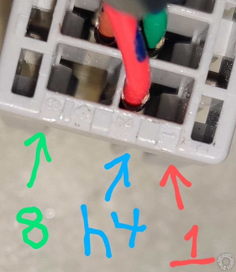

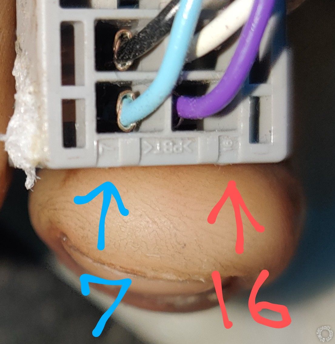

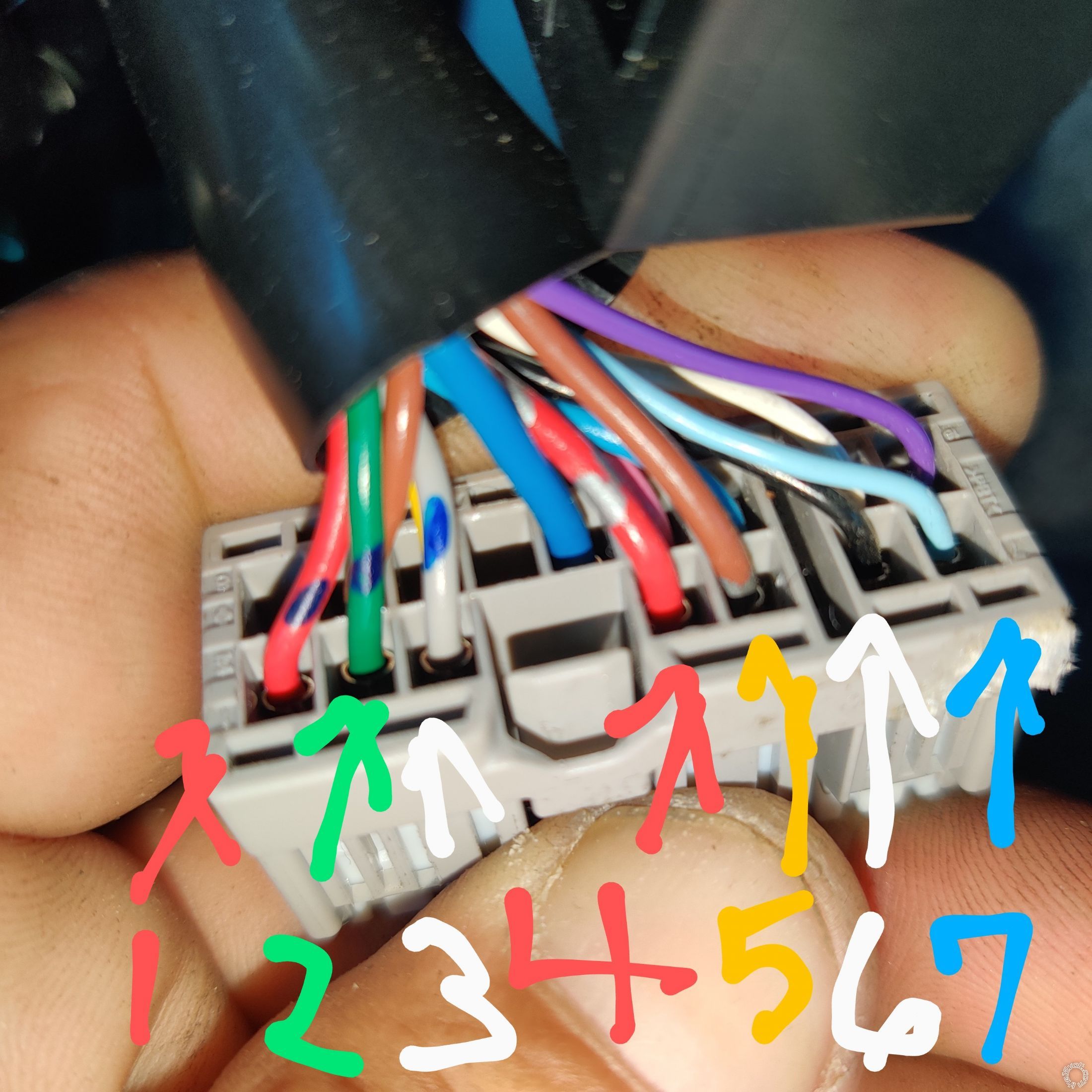

I did find the 16 pin connector. I'm attaching 3 pictures. The first shows markings on the gray plastic. A #1 which I marked in red, a #8 that I marked in green and it also has an h4 marking that I labeled with blue. I think the h4 marking is insignificant. The second picture shows the other side with 7 and 16 embossed on the gray plastic. I labeled the 7 with blue and the 16 with red. The 3rd picture is going from the 1 marking to the 7 marking numbering each wire. If I'm correct, pin 4 is red with a silver dot. Is this the one I check for polarity? Or is this the one I splice into? Or both? Thanks a million!!! Scytek Astra A15 into 2018 Nissan Versa -- posted image. Scytek Astra A15 into 2018 Nissan Versa -- posted image. Scytek Astra A15 into 2018 Nissan Versa -- posted image.
