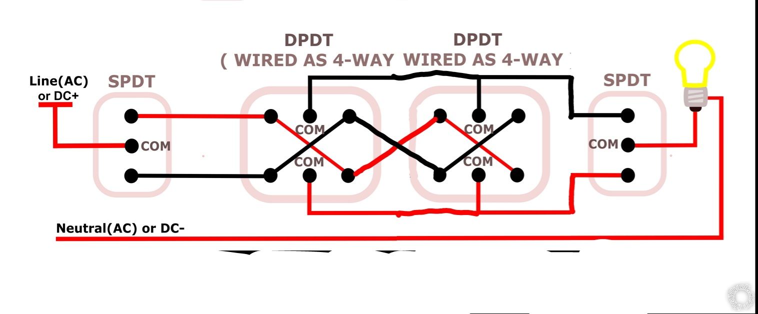

Wire it up with a 3 way switch on each end and then as many 4 way switches in between as wanted.
4 Way Switch Wiring Control 1 Light From 4 Switches -- posted image.

So for switches, you'll need 2 SPDT and 2 DPDT. The DPDT switches will be wired as reversing switches.

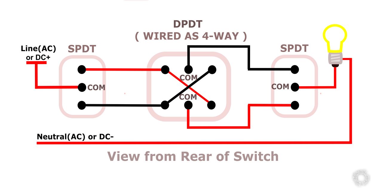

I found this image online showing a single 4 way switch with two 3 way switches.

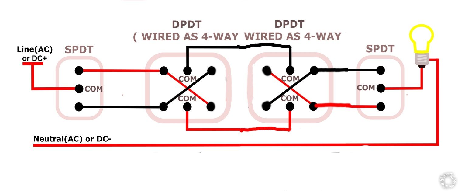

I've added another 4 way switch into the circuit.
Is this how it should be wired?

No,
Duplicate the 4-way (reversing) as in the first diagram. Wire additional switches in series.

Posted: October 14, 2020 at 5:22 PM / IP Logged Link to Post Post Reply Quote Ween
The common terminals if the first DPDT switch will connect to the common terminals of the second DPDT switch. The remaining terminals cross and connect to the SPDT switch.
