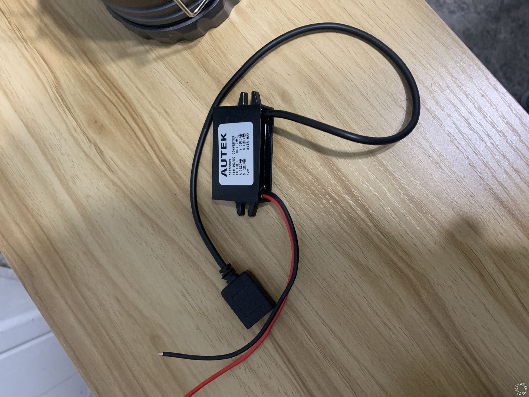

Posted: November 05, 2020 at 3:33 PM / IP Logged Link to Post Post Reply Quote xxdarklgxx
Thanks for your replies guys ?
! So something like this should be fine : Safe to Splice/Tap Stereo Ignition? -- posted image.

Posted: November 06, 2020 at 6:07 AM / IP Logged Link to Post Post Reply Quote geepherder
That should be fine.
