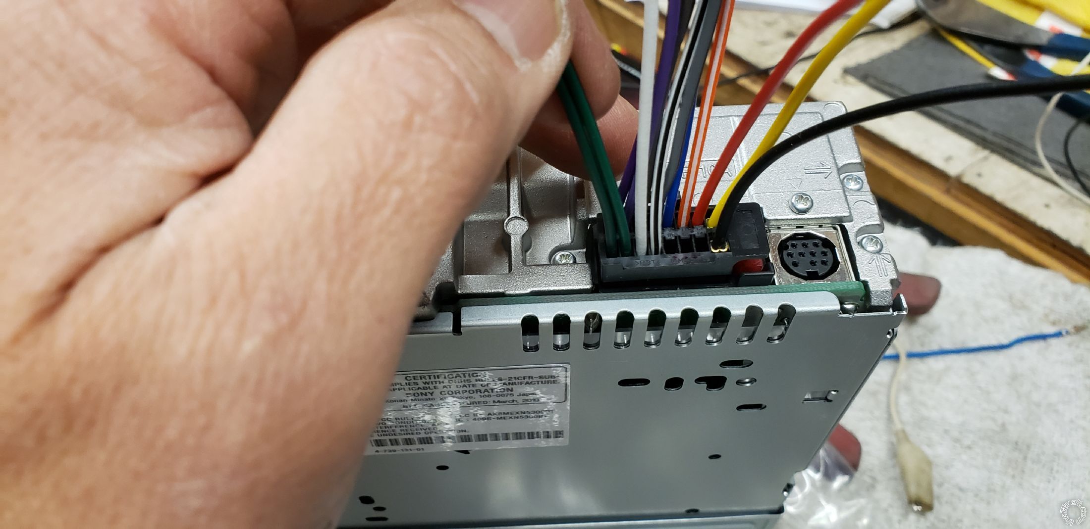

Platinum - Posts: 13,728
Posted: December 01, 2020 at 10:08 AM / IP Logged Link to Post Post Reply Quote i am an idiot
At first I was just mildly skeptical of their info. I decided let's see where pin 6 is. After seeing this i am mo longer mildly skeptical.
Tried posting image from my phone. Give me a minute to email it to myself.
Posted: December 01, 2020 at 10:11 AM / IP Logged Link to Post Post Reply Quote i am an idiot
Sony MEX-N5300BT, Power Antenna Pin? -- posted image.
Posted: December 01, 2020 at 10:53 AM / IP Logged Link to Post Post Reply Quote i am an idiot
Above photo is of a 4200bt, the only difference is there is not an illumination wire on mine. They said white was on pin 1.

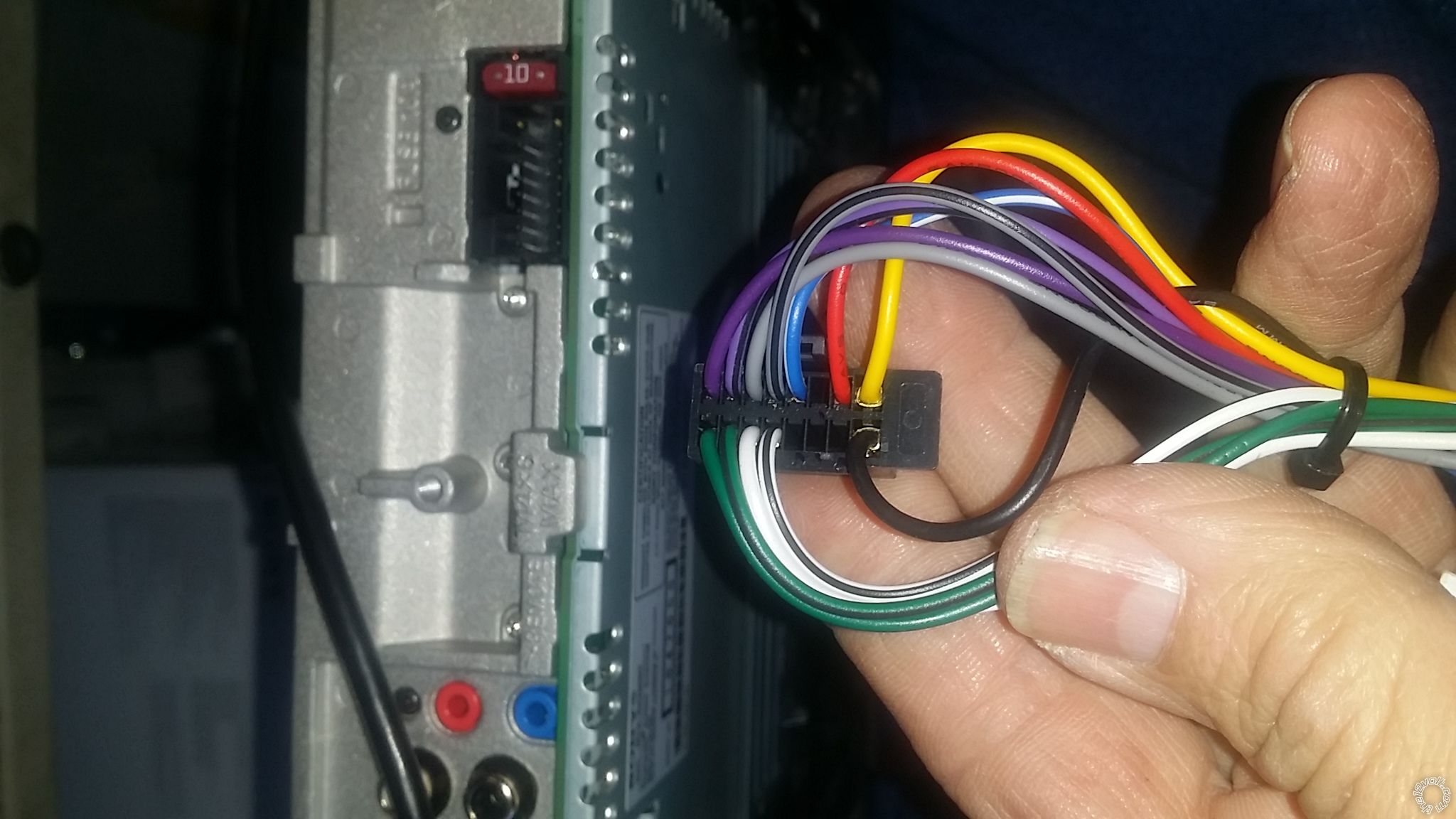

namyenruoj
Copper - Posts: 86
Joined: May 27, 2009
Posted: December 06, 2020 at 7:11 PM / IP Logged Link to Post Post Reply Quote namyenruoj
If i put wire in one of these empty space will it work? I use my volt meter and when i turn on my radio non of those spare pins I don't get 12 volts at all
