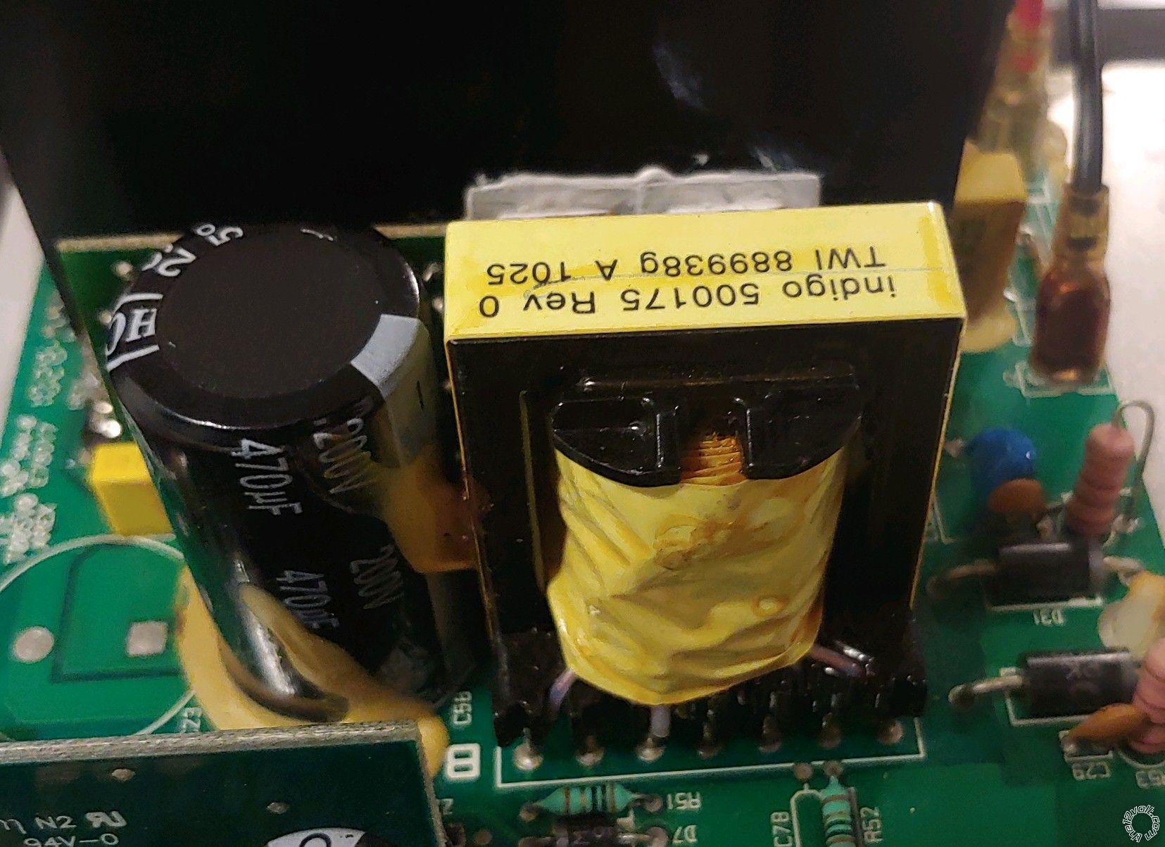

Hi all. I'm trying to repair the plate amplifier on a Klipsch rpw-10 sub. I took the speaker to a repair shop, which told me the transformer is bad. I get a power light but no output at all. I tried looking up the transformer via the label info but no luck. And Klipsch is no help. Can anyone give me a hand with identifying the type of this transformer and where i can buy a replacement? Thanx in advance for any help you guys can provide!

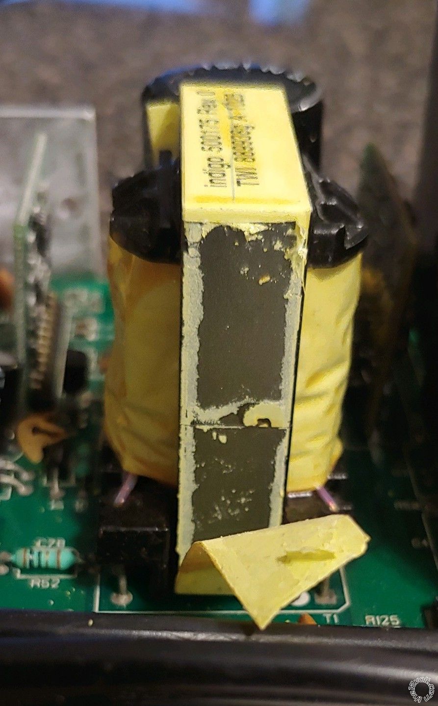

Cut the outer layer of the yellow tape on both sides of the transformer.

Hey. Thanx for the reply. What exactly am I looking for?

Posted: December 22, 2020 at 12:18 AM / IP Logged Link to Post Post Reply Quote pcharm129
Both sides look like this...Need Replacement For This Transformer, Klipsch RPW-10 -- posted image.

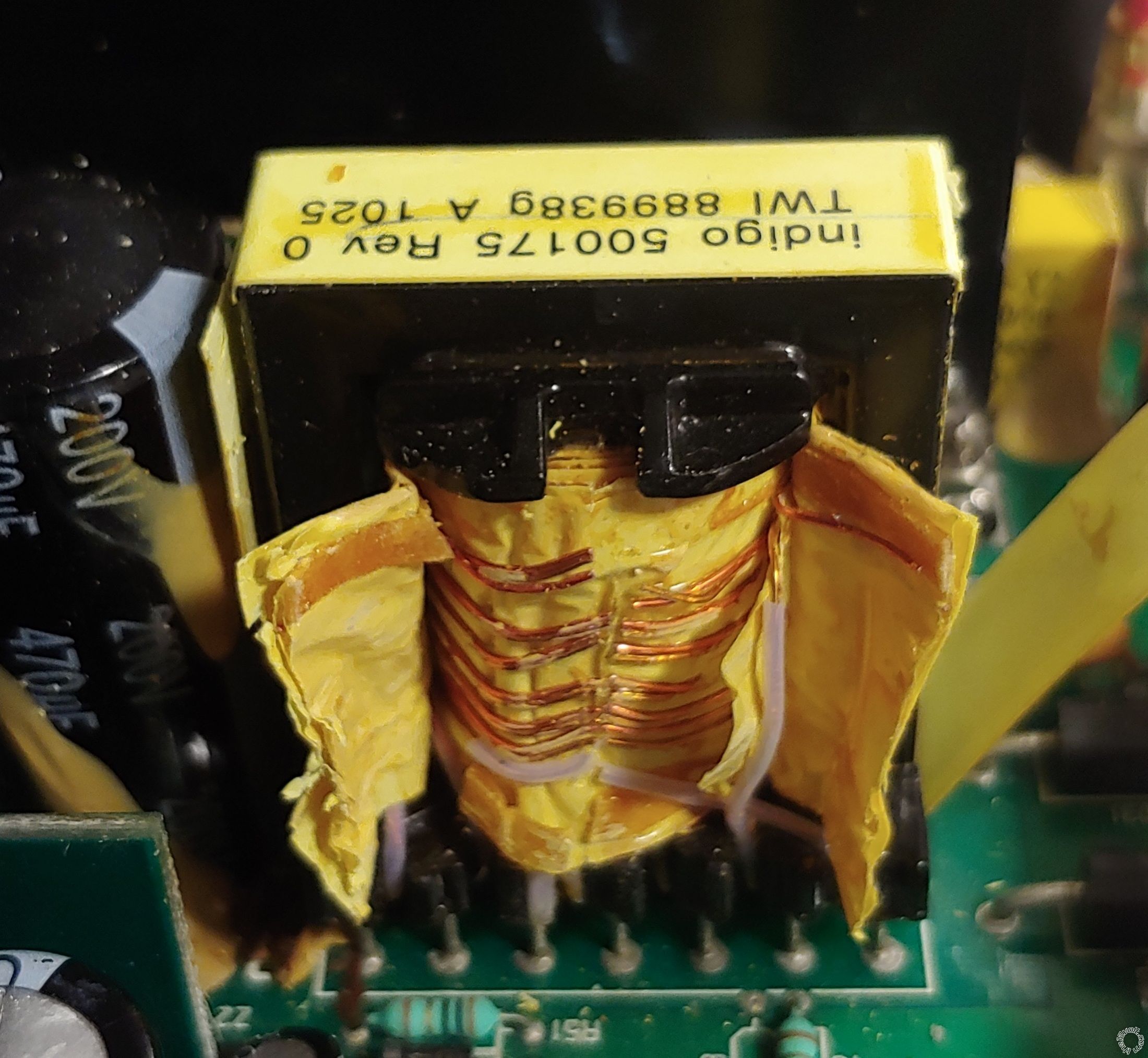

Posted: December 22, 2020 at 12:42 AM / IP Logged Link to Post Post Reply Quote pcharm129
And here is the other side...
