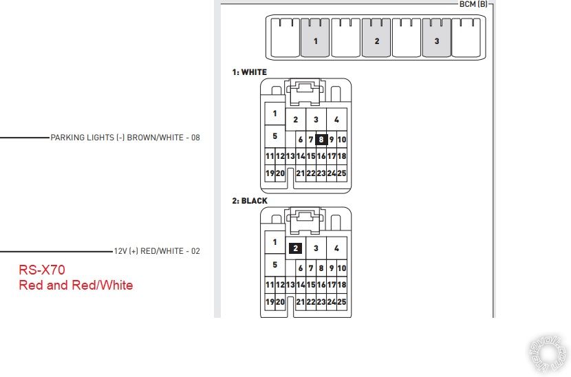

Aside from the RS-X70 thick Pink/White and Orange wires, did you connect the Red and Red/White wires to +12V constant power? I would use this wire at the BCM shown below :
2008 Chevrolet Impala Not Charging With Remote Start -- posted image.
If yes, verify the fuses, +12V at the Red and Red/White wires at the R/S plug and that the Pink/White and Orange wires have +12V output during a R/S.

Posted: January 09, 2021 at 4:00 AM / IP Logged Link to Post Post Reply Quote plachagr8
Thanks for your help kreg357. I double checked all the wires are the ignition. I switched my 12v supply to the wire you recommend and I also replaced my car battery just in case. Everything is working now.
