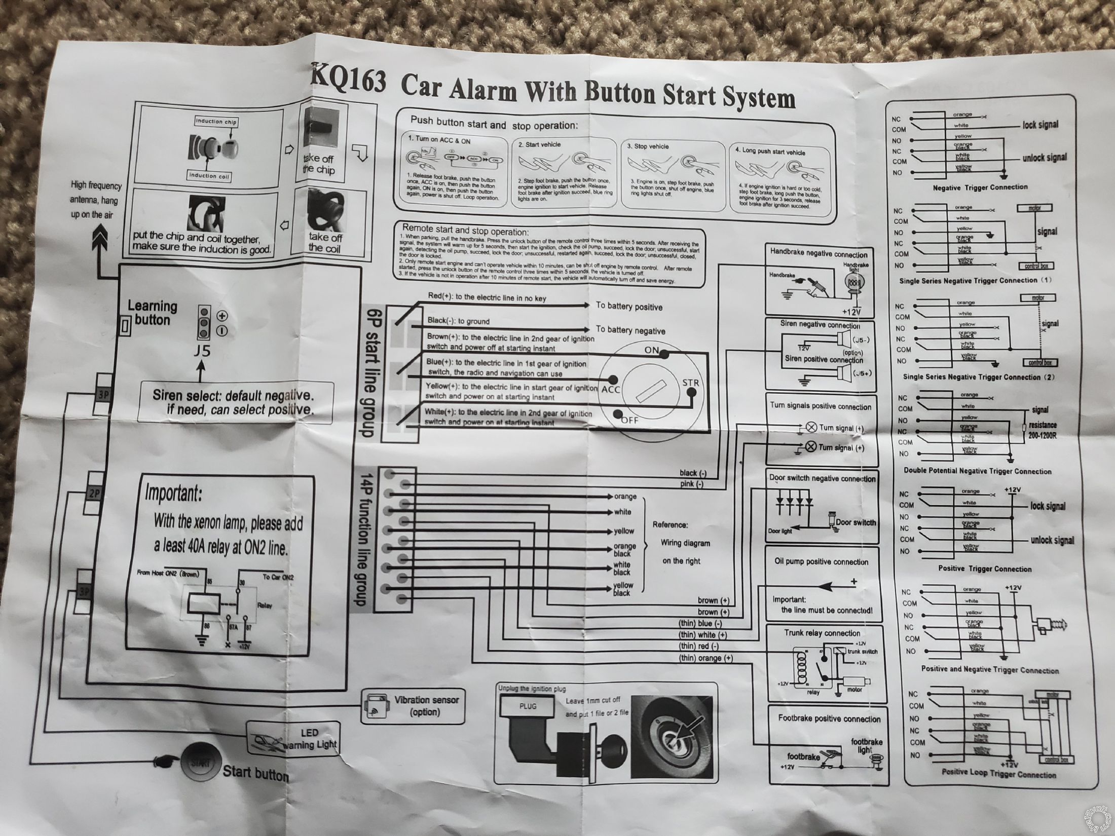

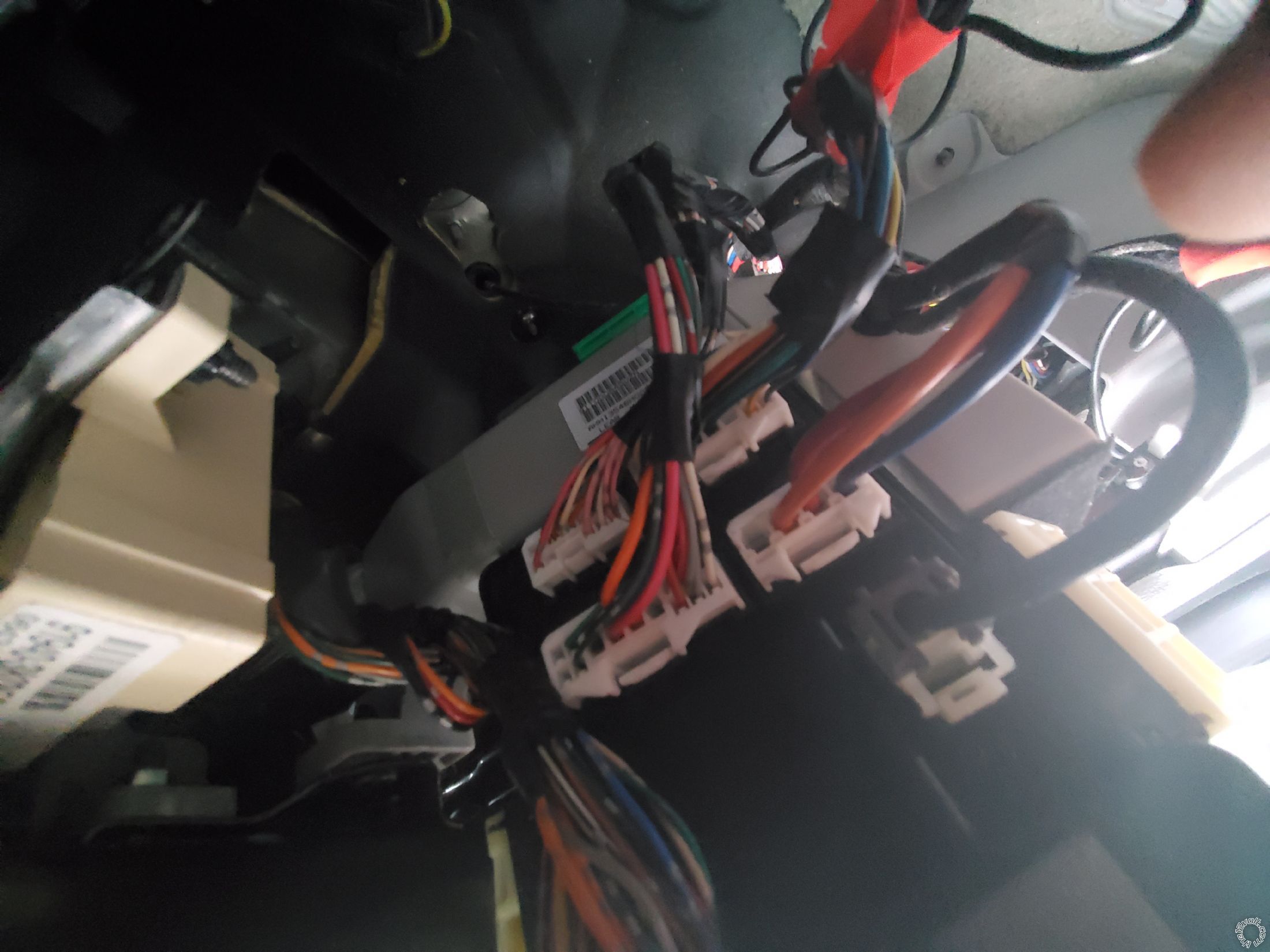

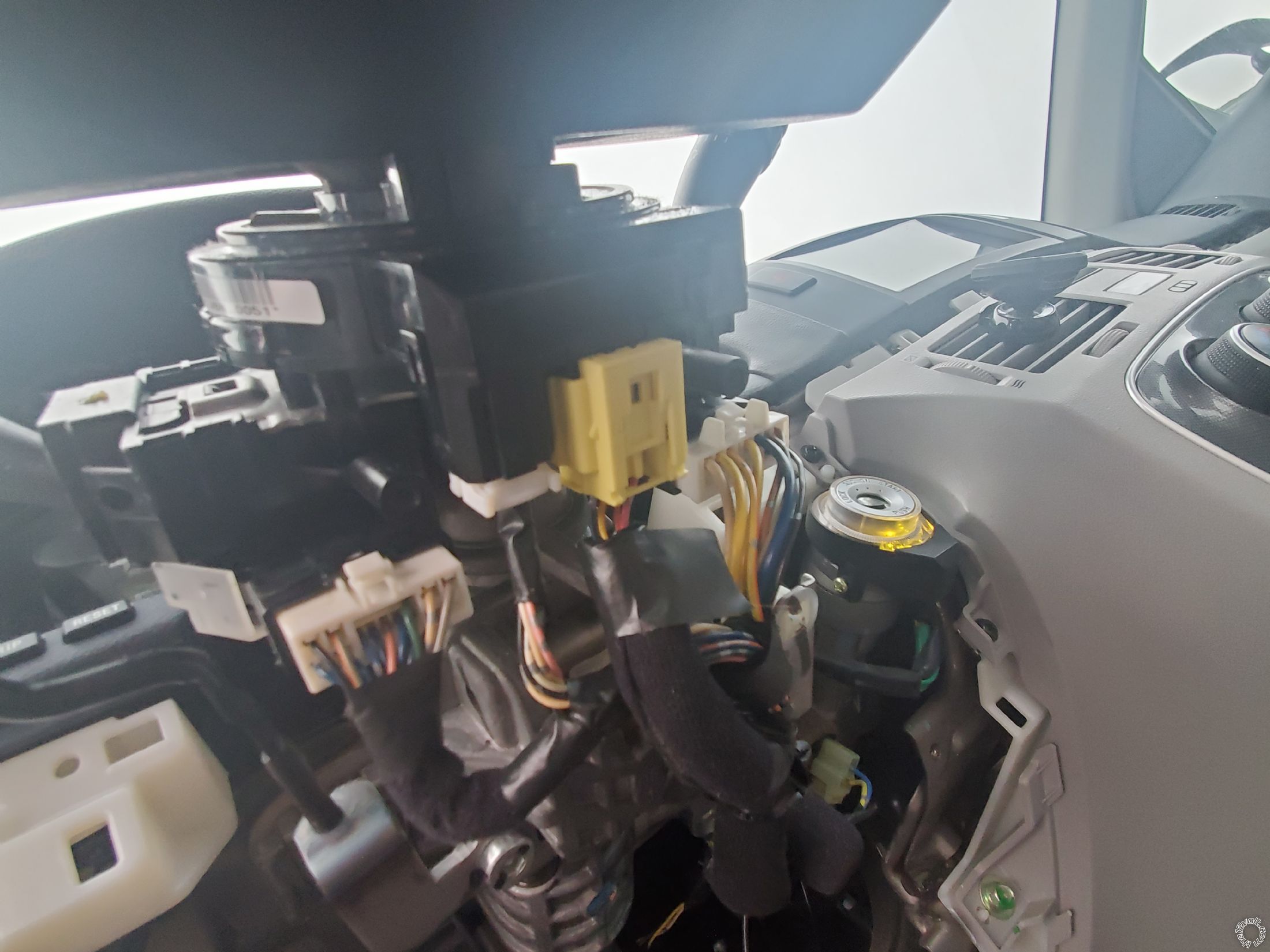

Hi i was looking for the wiring for hyundai sonata 2007 but i didn't find it. I looked at sonata 2008 and 2006 but got a little confused. Here's a pictures down. One of them is the wiring diagram from the remote start company. And 2 other pictures of the wires in my sonata. Should i use the wires under the steering wheel or the wires hooked to the box on the left (see pictures )

If its the ignition wires you're looking for go to the wires coming directly off the back of the key cylinder.
