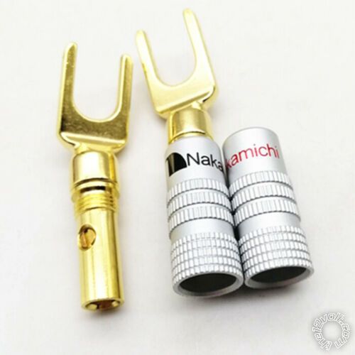

These are those really cool 12g gold-plated fork terminals I found on eBay and ordered. Never seen anything like them! Too bad they aren't rings! I think they might look pretty nice connected to my amp! STILL going to order new gold-plated ring terminals in case I don't like these.

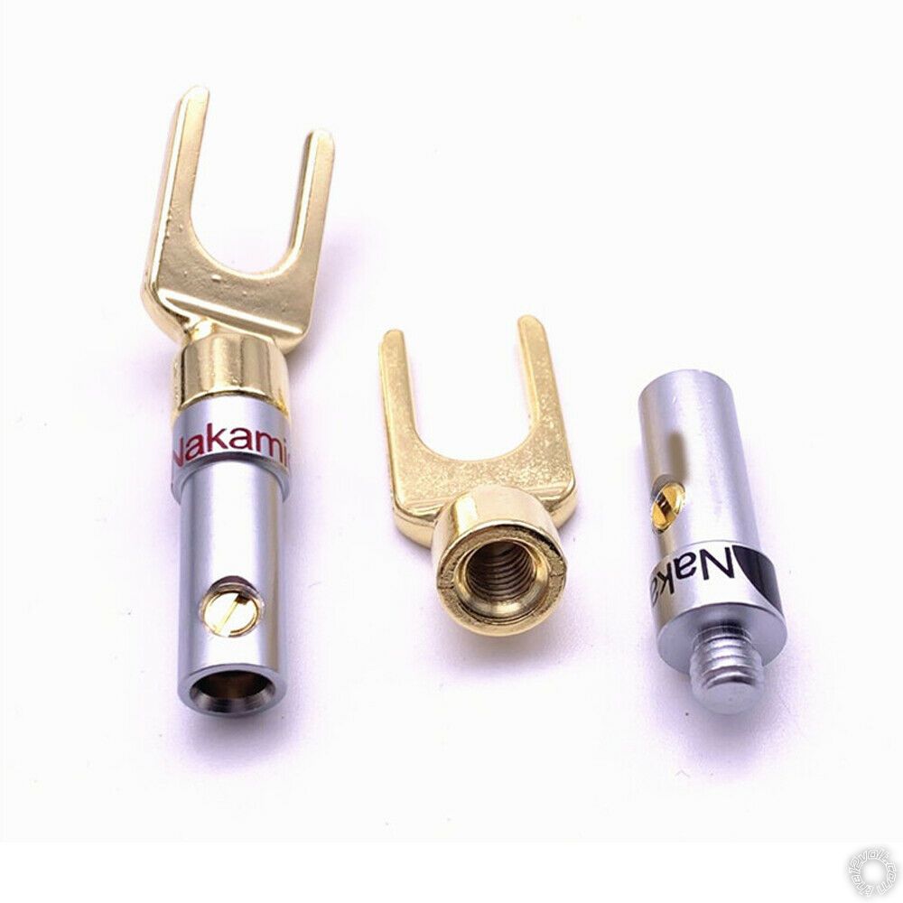

Here's a different kind, same Nakamichi...
