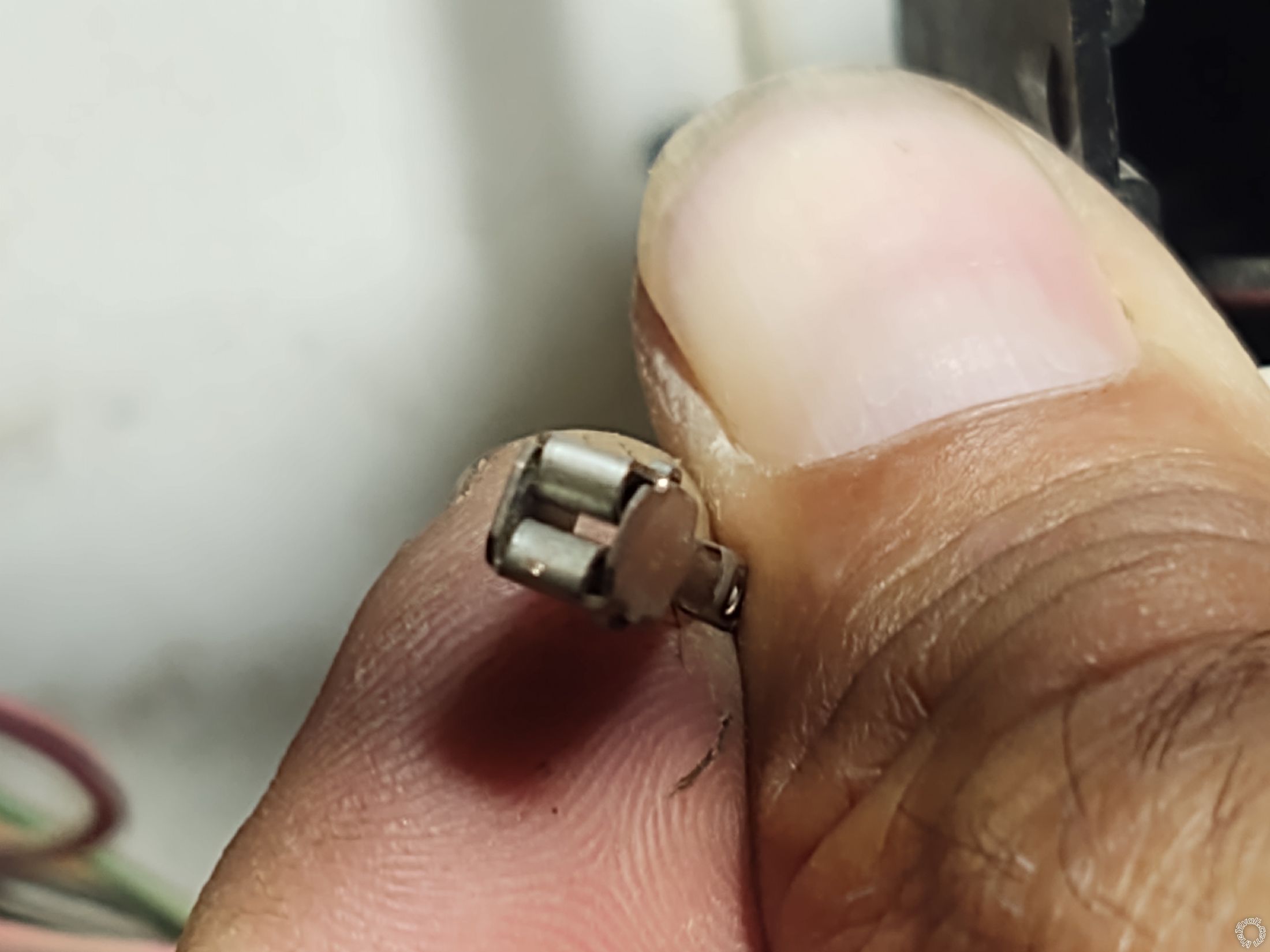

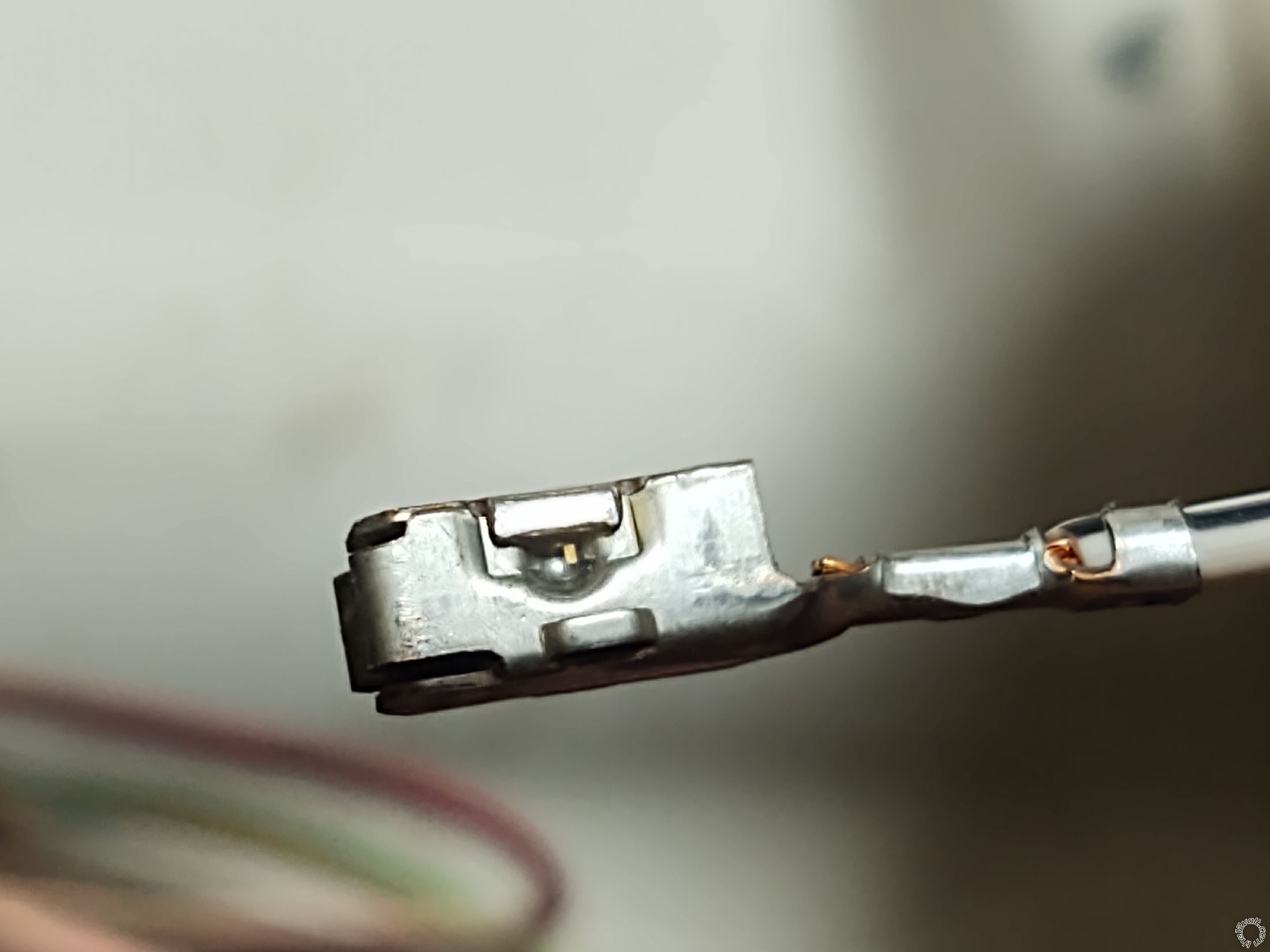

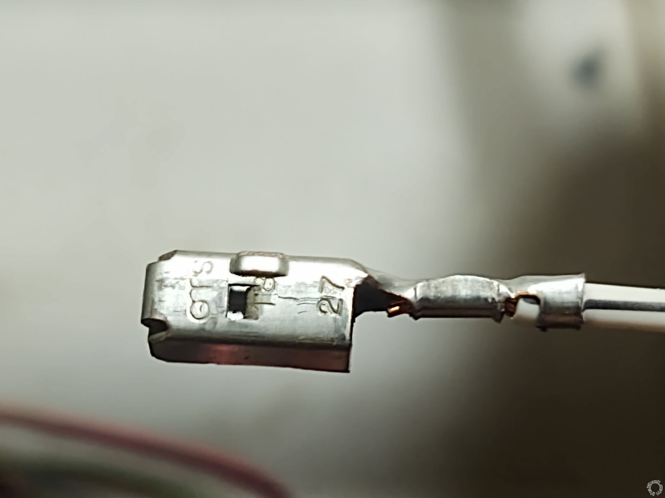

I need to replace a couple of these terminals. Taps had been used and now they don't hold the fuse tight. It's on an 06 Ford.
Any idea where I can get some?
Need To Repair Power Distribution Block, Terminal Connectors -- posted image.
Platinum - Posts: 13,725
Posted: June 25, 2021 at 7:40 PM / IP Logged Link to Post Post Reply Quote i am an idiot
Use a pick tool and move the contact patches closer.
jstoddard
Joined: December 13, 2018
Posted: June 25, 2021 at 8:05 PM / IP Logged Link to Post Post Reply Quote jstoddard
I've done that, they still don't hold enough to be reliable.
geepherder
Platinum - Posts: 3,668
Joined: October 27, 2003
Posted: June 26, 2021 at 7:52 AM / IP Logged Link to Post Post Reply Quote geepherder
You could try searching mouser.com, digikey.com and te.com. Put in your criteria to narrow your search. An ATO type blade fuse has a blade width of about 5.1mm and a thickness of about .64mm. An ATM type blade fuse has a blade width of about 2.8mm and thickness of about .8mm. With this in mind, you can look for specs in that ballpark.
If you don't find anything suitable, you're unlikely to find a new replacement, but you could check junkyards or eBay or similar sites for a fuse box/pigtails for the terminal you need.
Ween
Platinum - Posts: 1,368
Joined: August 01, 2004
Posted: June 26, 2021 at 7:17 PM / IP Logged Link to Post Post Reply Quote Ween
I have an old Ford parts catalog pdf...terminals with pigtails. Looking through it shows pigtails D65 & D66 with 12 and 16 gauge wires respectively. Also has Ford terminal numbers F2DB-14474-AA & F2DB-14474-CA and part numbers 103948 and 103949. Terminal portion is approzimately 6 mm x 6 mm x 22 mm. I believe these are the ones you are looking for. Ford dealers had (have) these kits for wiring repairs, at least the dealer by work did a few years back. Later years the terminals were more standardized.
