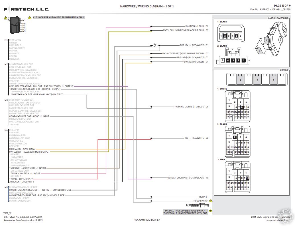

Kind of odd that the module is not recognizing the takeover when you put the key in and press the brake pedal. How frequently do you remote start the truck and don't get into it before the remote start times out? If the answer is never...then you may consider removing the Remote Start's RAP shut down wire from the trucks door pin. (purple/black wire in this diagram)

I considered that. I don't have that wire connected so it would just be a matter of changing the programing to analog instead of data in the settings.
