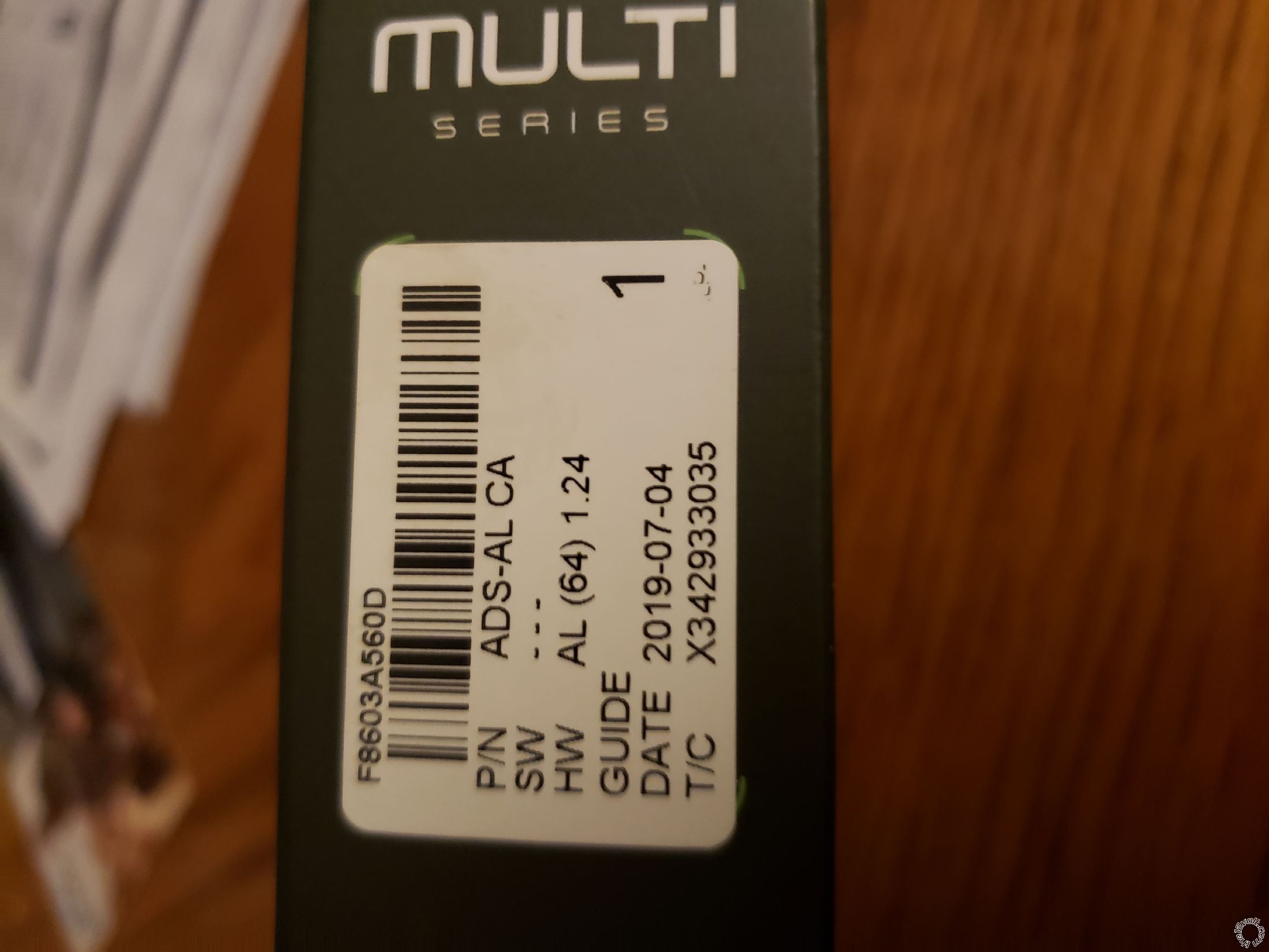

Posted: December 06, 2021 at 4:03 PM / IP Logged Link to Post Post Reply Quote phill_667
Nope didn't flash it myself, it was supposed to be flashed by the place I bought it from. Don't have the cable or an account for that.
Here's a picture of that label on the box.
Idatalink ADS-ALCA, 2008 Ram -- posted image.
Platinum - Posts: 7,827
Posted: December 06, 2021 at 5:40 PM / IP Logged Link to Post Post Reply Quote kreg357
Looks like it came from the factory without any firmware. The Installation Selection results are confirming that. Hopefully the place you got it from will do the flash for you. If not you will have to get an ADS USB cable and do it yourself.
