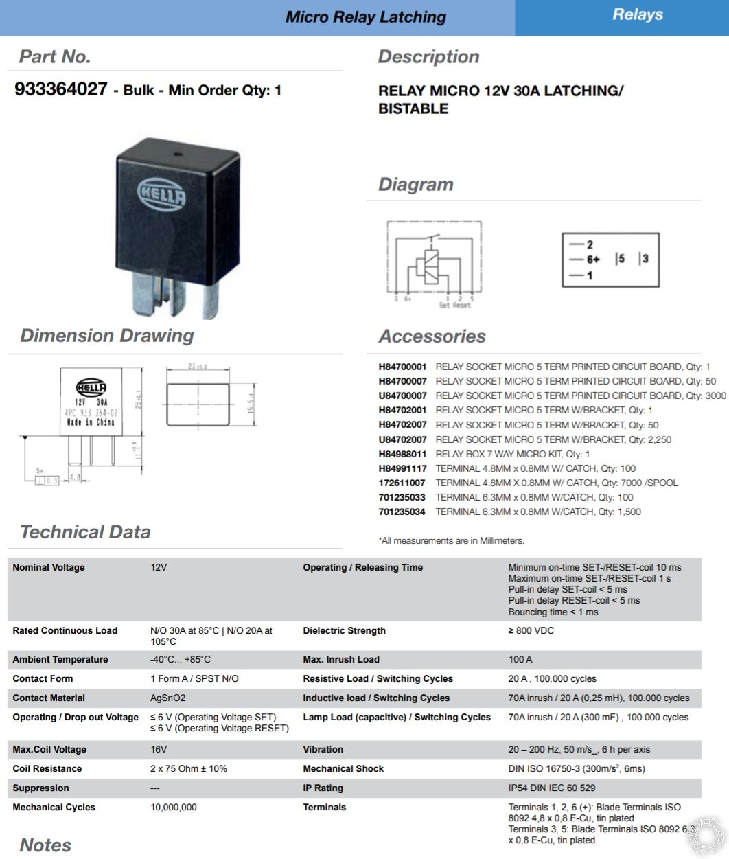

The specs on the particular Hella Latching relay had me confused on this being 2x 75ohms will try to upload a image of the specs.
I am actually waiting on a new multimeter to measure them in both states - surprisingly my DigiKey shipment arrived before my Amazon shipment w/ the meter :p
I was going to follow the latching relay diagram here for "Create a ground when armed" and compare the current used to keep latched/unlatched state on that setup vs the Hella latching relays
