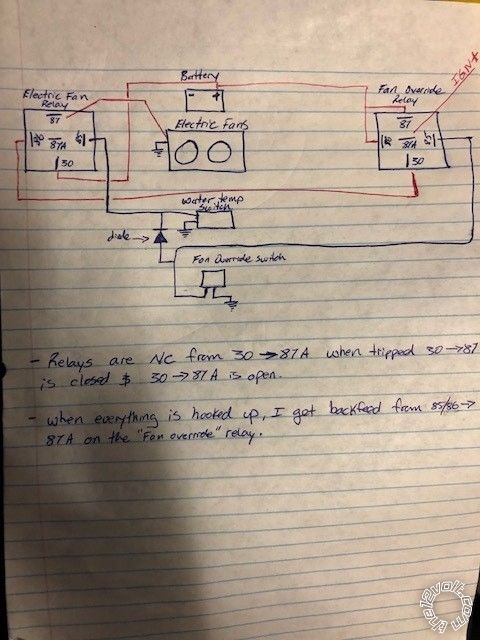

Hello, new to forum. Trying to wire up an override switch for my electric fans on my hot rod but for some reason I keep getting back feed from the battery circuit to the ignition circuit on my override relay. I can tell the back feed is coming from the 85/86 side of the override relay as when either side of this is unplugged, the back feed stops. Also if I unplug the 30 on the override relay this will also stop the back feed. Looking for some help on how to properly wire this up. I want the fans to work on ignition normally but when i push the fan override switch, I would like that fan relay to then be powered off of battery power. I have attached a quick schematic. 12V Relay Back Feed -- posted image.
Millsner

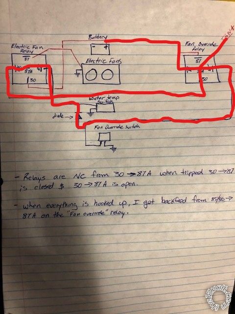

This your backfeed path. I suggest you try a different circuit design.
