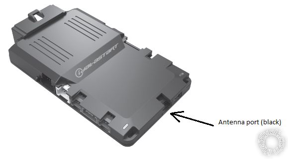

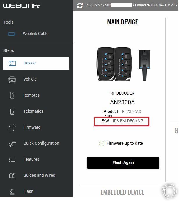

As Kreg357 mentioned, the remotes should have been pre-paired already. The tech could confirm if any remotes are currently registered to the HC controller by connecting the HC controller to a computer using the ADS-USB cable or a standard USB Mini-B cable and going to the "Remotes" menu. Double check the serial numbers of the remotes match the serial numbers registered in the HC controller.
Also, maybe there is a firmware update for the Antenna, the tech could check by connecting the antenna using the ADS-USB cable.
just to make sure the tech did not overlook things, please see screenshot showing the antenna port on the controller.
